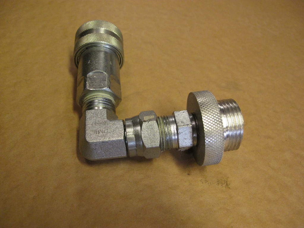

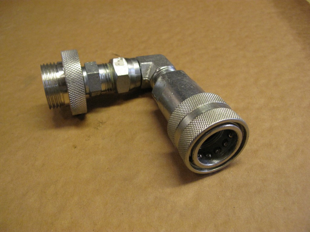

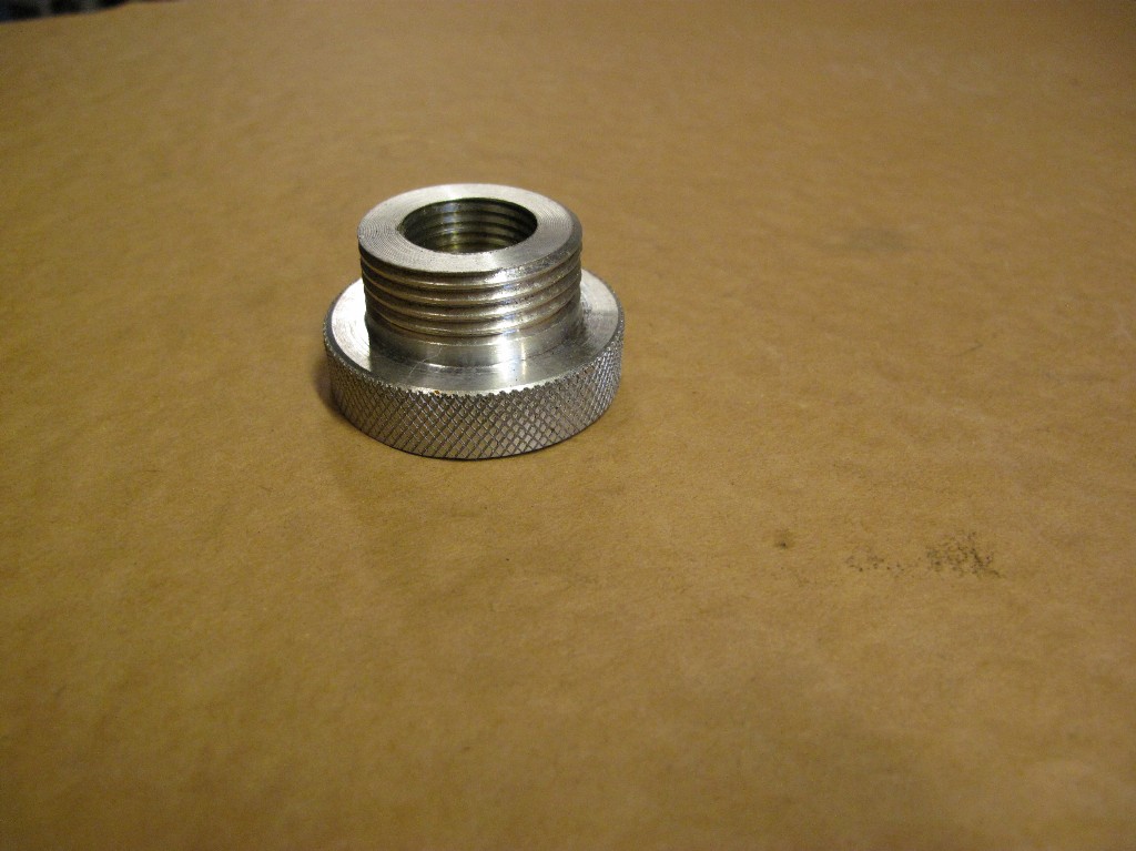

Just a quick replay and big thank you to all that contributed to my adventure with the hydraulic system, so what I have done I made an adapter that replaces the plastic screw in filler cap
this is what it looks like with quick connect on

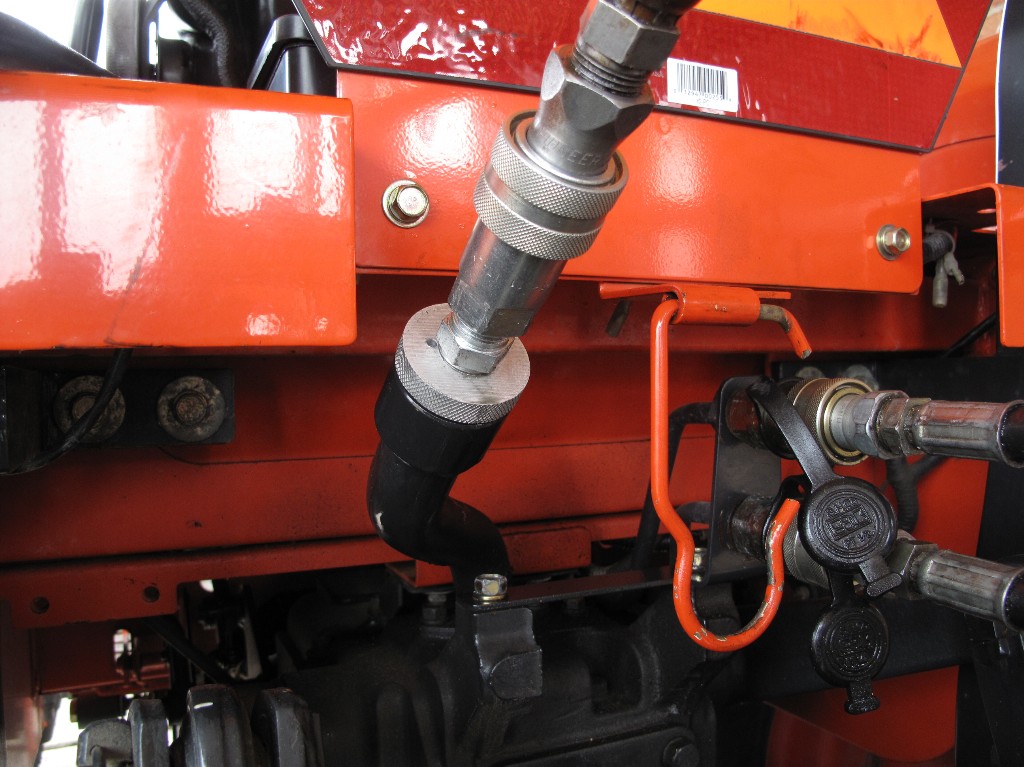

I had to change the 90 degree coupler since it was in the way to a straight one and this is what it looks like on the tractor
I took it for a spin this afternoon and everything works as it should for now at least
Thank you again for all the help and helpful info
View attachment 312293View attachment 312294
Paul.W
Thanks for the update.
Looks good! :thumbsup:
