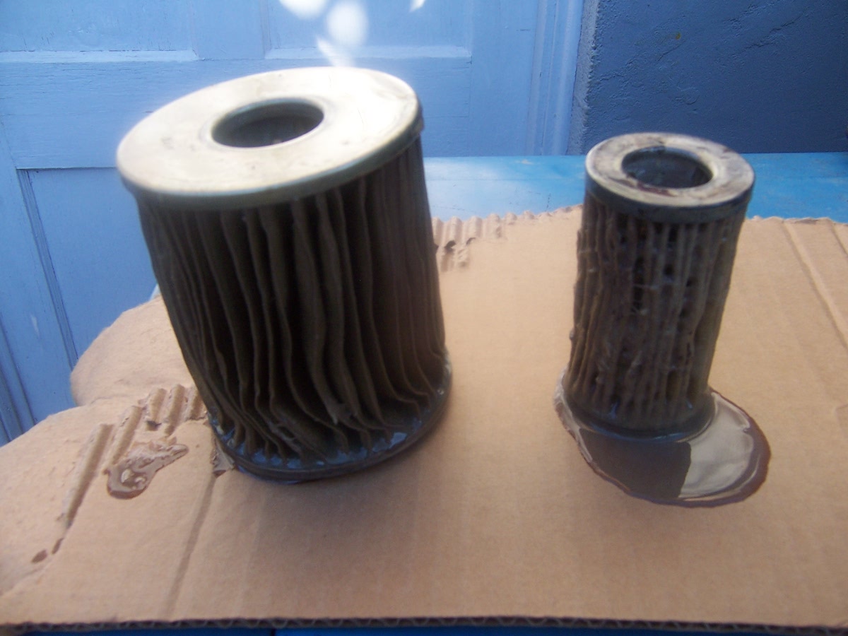

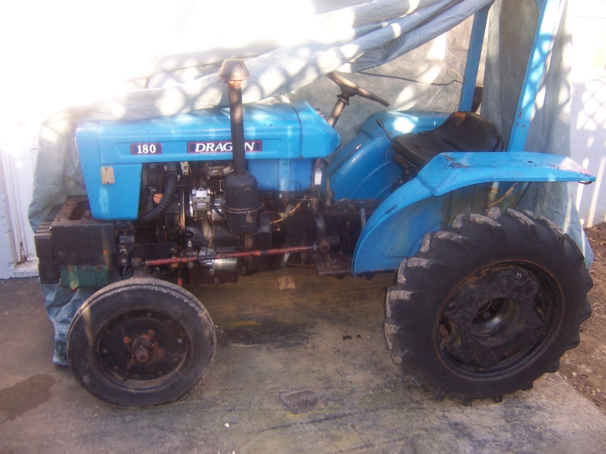

The tractor is a 180 Dragon. The issue is the hydraulic filters need to be replaced and as usual there is no info available on the web.
looks like a 2 cyl Diesel engine .Model # on engine is J285T
That is the only info on the whole tractor. No part numbers on the filters. The issue I run up on is that the filter suppliers all go by the part numbers..
its not like it was years ago when it could be matched up with another filter.
I was told that you guys have a member called bluechip that may be able to help
the dimensions are as follows
OD-- 4" high X 3 1/2 X 1 1/4 inside hole
OD-- 3 3/4 high X 1 3/4 X 1" center hole

/ HELP I need hydraulic filter info
#9
Big update

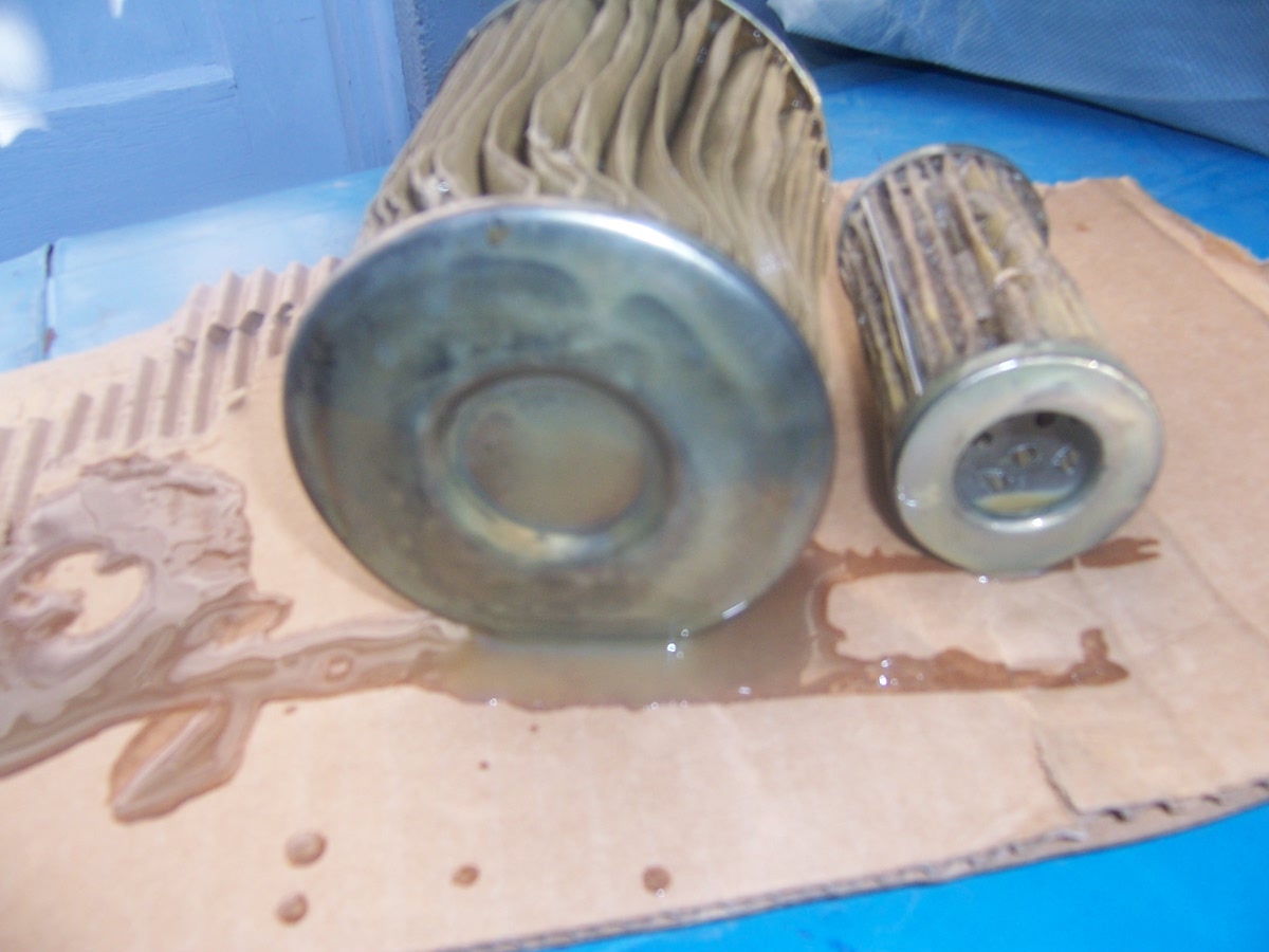

went to the NAPA warehouse in Knoxville,tn with the filters . God must be with me today because I talked to a 16 year NAPA Female manager
that took a lot of time in the older filter books . as it turned out she is sending the larger filter to the techs at Wix filters. two to four week reply.
but she found a filter that will work for the small one. But a small alteration is required. very simple. check the pics.
The brand filter NAPA Gold 3507 is a perfect fit. you need to take what I call a all size drill bit shown in pic and drill out the end of the filter because one end is closed.
be careful you don't over tighten the cap or you will screw up the gasket re installing
PS after rechecking the filter cap and seeing how it seals against the filter, I don't think you have to drill out the end of the filter.
