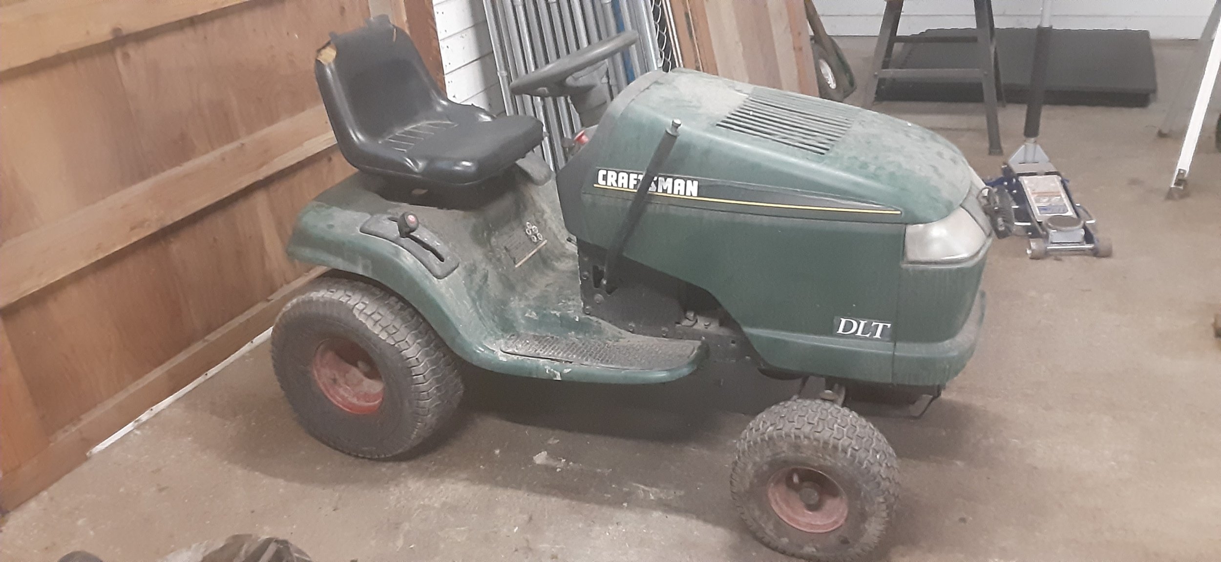

Ok, that sounds pretty easy. The fuel tank sits under the seat so I'm assuming that when I pull the fender/body panel off the tank will either be bolted down to the frame or just balanced there? Just hoping they didn't design it to be attached to the body from the bottom since it seems to be a 3.5 gallon tank and I don't know how much fuel was left in it. I suppose I could always pump the fuel out with that transfer pump though!

I just dump them out through a MR Funnel into a supply can. Yep, the tank has a bracket around it that supports the seat too. Watch the direction or mark it. Easy to flip it around and then the body bolts won't line up. Great time to replace the fuel line. Also when these tanks leak, it is at the seam- so a good time to check that too.

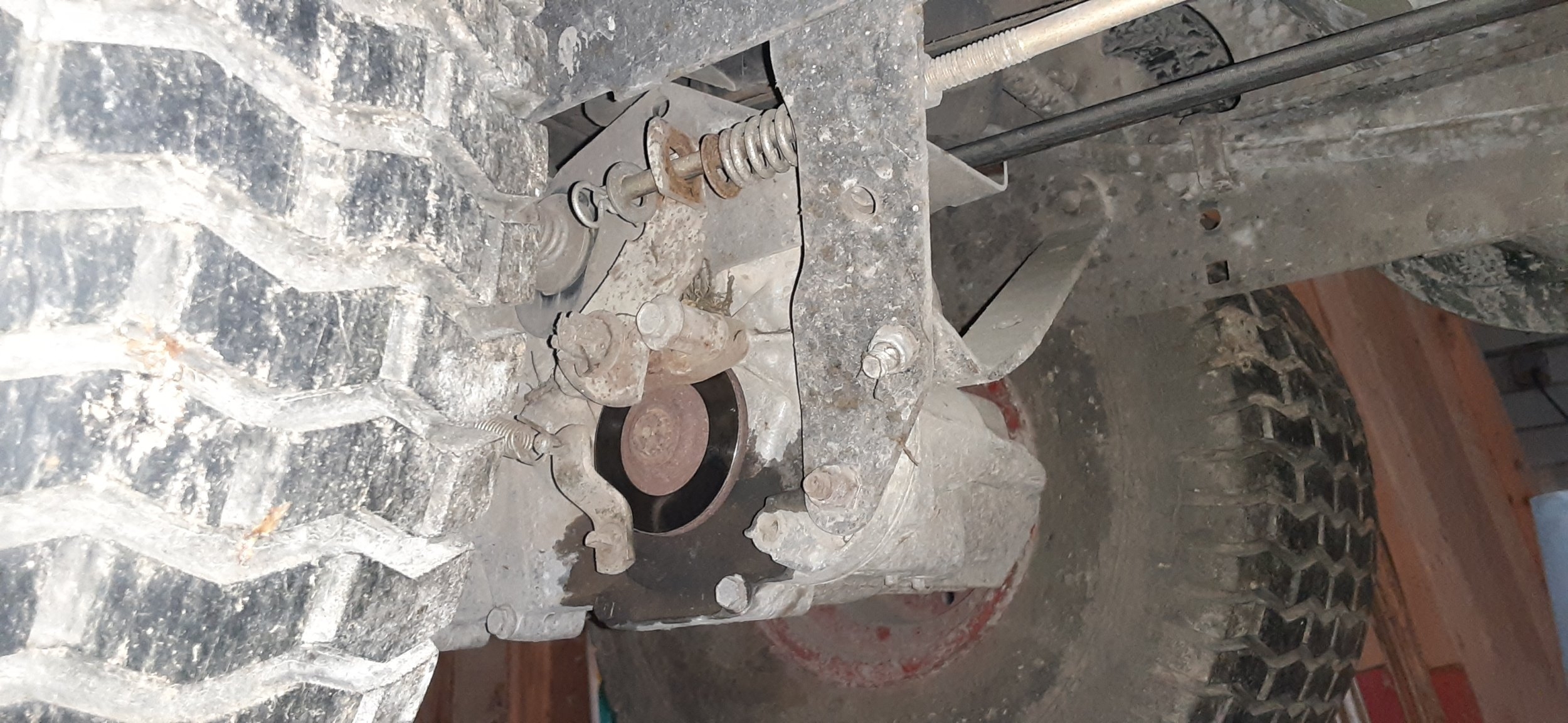

I pulled the body and the tank (no leak so doesnt look like cracking is an issue). There are 2 potential access points to the transaxle (red and blue circle). Blue is a rubber plug I believe. Red is a hex socket bolt. Assuming its blue is it just a recessed grove so hank it out and access? No manual so dont want to try to find a replacement without part number.

SO that little tank is basically an expansion tank. Main thing working with this is to keep the dirt out.

I cleaned up the top of the transaxle. After reading your comment and looking over the transaxle again, i believe the hex screw is the fill port and tye plastic plug is some kind of overfill relief (so dont touch it). I picked up some 1/4" ID fuel hose this afternoon too.

The fill plug is at the top of the bull gear housing.
Here's the Hydro-Gear manual.
Edit: Also check that the bypass lever is free and it's fully in "drive" mode. The bypass valve allows the mower to be pushed when not running. When not being pushed, the lever must be fully in drive mode.

I removed the fill plug which was no issue. The fluid was basically at the top of the plug and although it's warmer than usual it certainly isn't hot weather (maybe 70F in the shop) and I haven't run the tractor in over a week. I pumped the fluid out and a little less than half a gallon in my gallon milk jug. The manual says it takes around 2.5 quarts so it seems there must be some residual that won't pump. The fluid was pretty thick and black though I didn't see any particulate, that doesn't surprise me. I'll try to find a filter cloth of some kind to see if there's any metal in the fluid. I also pulled the expansion tank since that's recommended by the service manual. Very little fluid in there though.
I ran into a little issue with the tiny torx screw on the expansion tank fastener. As expected of an 23 year old self tapping screw, it snapped off at the head. Guess I get to drill and tap it and put a real bolt in instead.

You did pretty good actually with your evac. I don't remember how the tank is sealed into the housing. A normal o-ring? But yes full to the top and a good layer in the plastic tank. 1/2" or whatever keeps the housing full and provides room for expansion.

That's a nice tractor but much newer than what I have. It looks nearly identical to the 917.272201. The local shop/bone yard has 2 on their lot that I believe are being worked on. The primary difference appears to be that one has the 25HP V-twin Kohler and a 46" deck where mine is the 20HP opposing twin Briggs and 42" deck. Mine could have a swapped deck making it the same with a different motor. Seems like that should make it easier to identify but model numbers don't seem to work that way.
FWIW, the two at the shop had mfg dates (based on S/N) of 13 June 2000 and 31 July 2000 whereas mine appears to be 21 August 2000. Not that it really matters (I don't think) but mine has a single bar code at the bottom which matches one of these two. The second one at the shop has two rows of bar codes. I have no idea what that means, just an observation.
