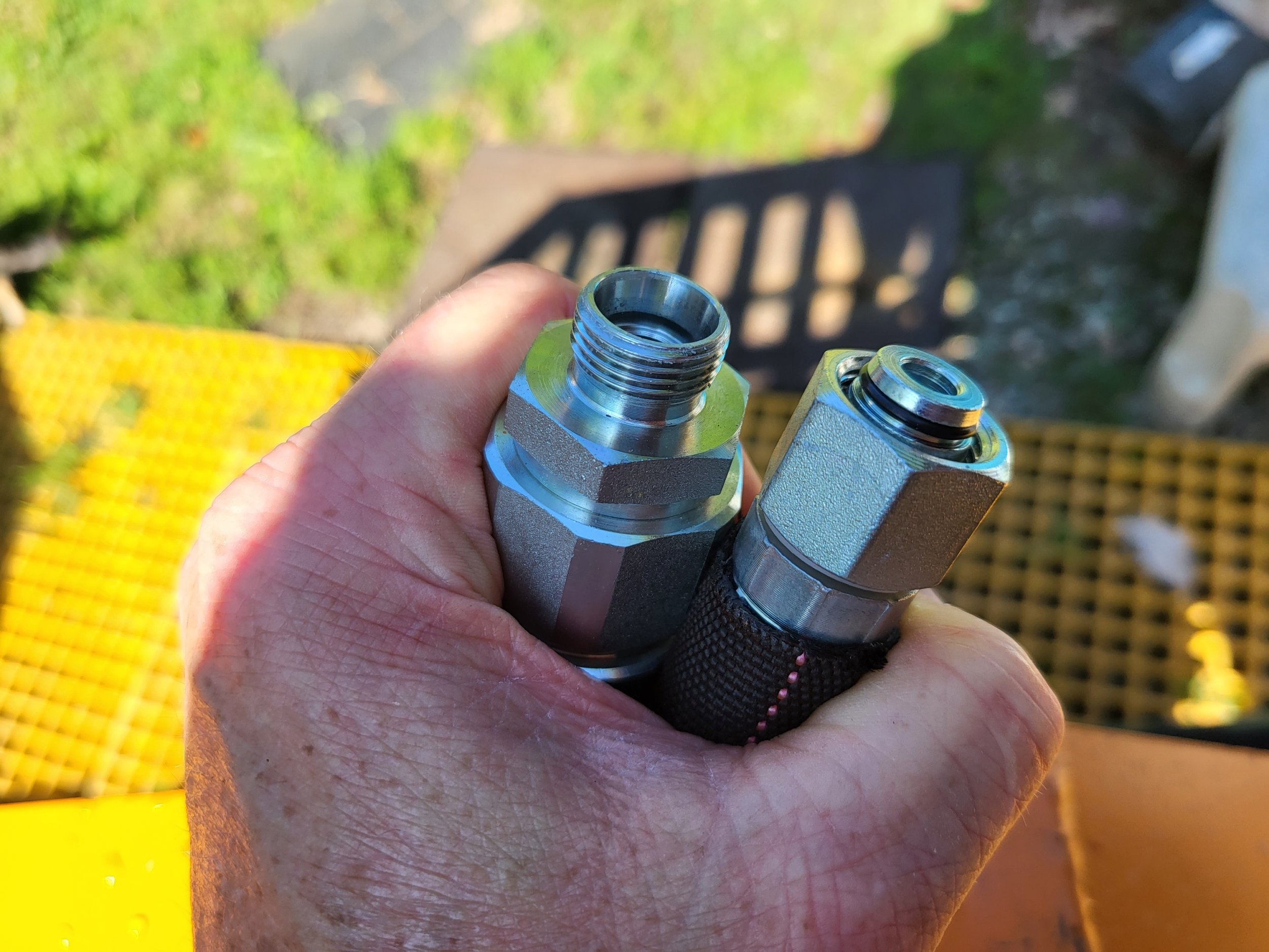

I found, on the grapple side, 18mm-1.5 straight female threads with an o-ring. I am not sure what this thread configuration is called, as it isn't NPT.
I'll head up to tractor supply to see if they have anything.
Tractor side, in thumbnail. I suppose they are "pioneer" style.
This is the skid steer side, coupler on the left and hose end on the right:
That threaded end looks like a DIN fitting.
