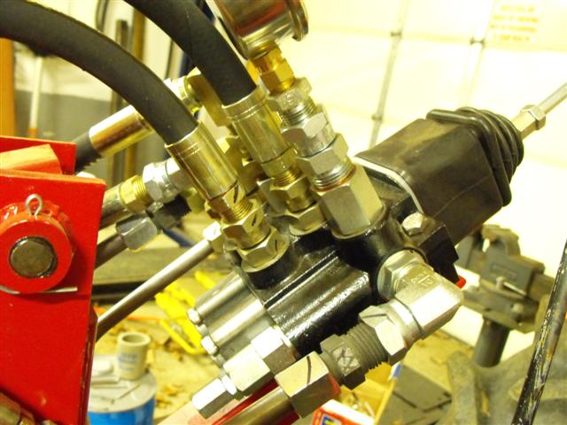

Thanks. I just realized I got the 1/2" hoses with NPT ends instead of the JIC ends. So I was looking around on tractorsupply's website and found this adapter. It's says it's a ORB to Female pipe adapter. But doesn't say NPT.
So is this the one I need for my NPT hoses? Swivel Adapter, 1/2 in. Male O-Ring Boss x 1/2 in. Female Pipe Swivel - 1818626 | Tractor Supply Company
Thanks
Chad
If this helps understand the fitting you are asking about, the hoses are all NPT ends into swivel fittings.

:mur::mur: Why oh why can we not have a single world standard... I'm a millwright and I find it confusing, God help us all.
Gary, in your picture, the male pipe thread seals in the upper part of the fitting, but what seals the swivel portion? I assume it's an "adjustment while installing" kind of swivel, not meant to pivot during operation?

These type of swivel fittings allow you to set the hose to the direction you need and then tighten down. Once they are tightened, they don't move. They are not a "live" swivel that will move during operation.
