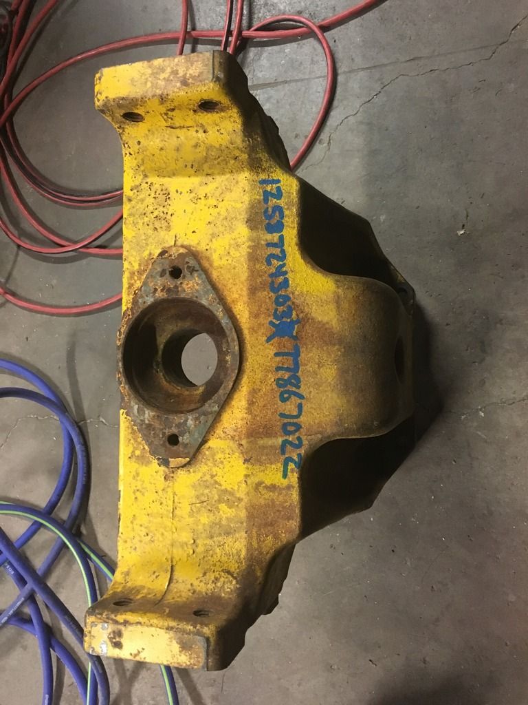

One thing I missed on the review of the tractor is this:
This is the front axle carrier. I did look at this area when I purchased but the assembly is broken at the very front under the nose cone and I didn't see it.. I already found and purchased a used axle carrier for $350+shipping so at the end of the day, it's not the end of the world.

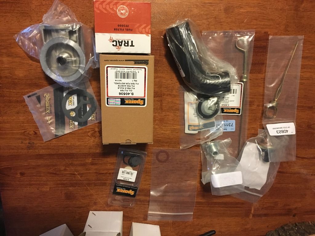

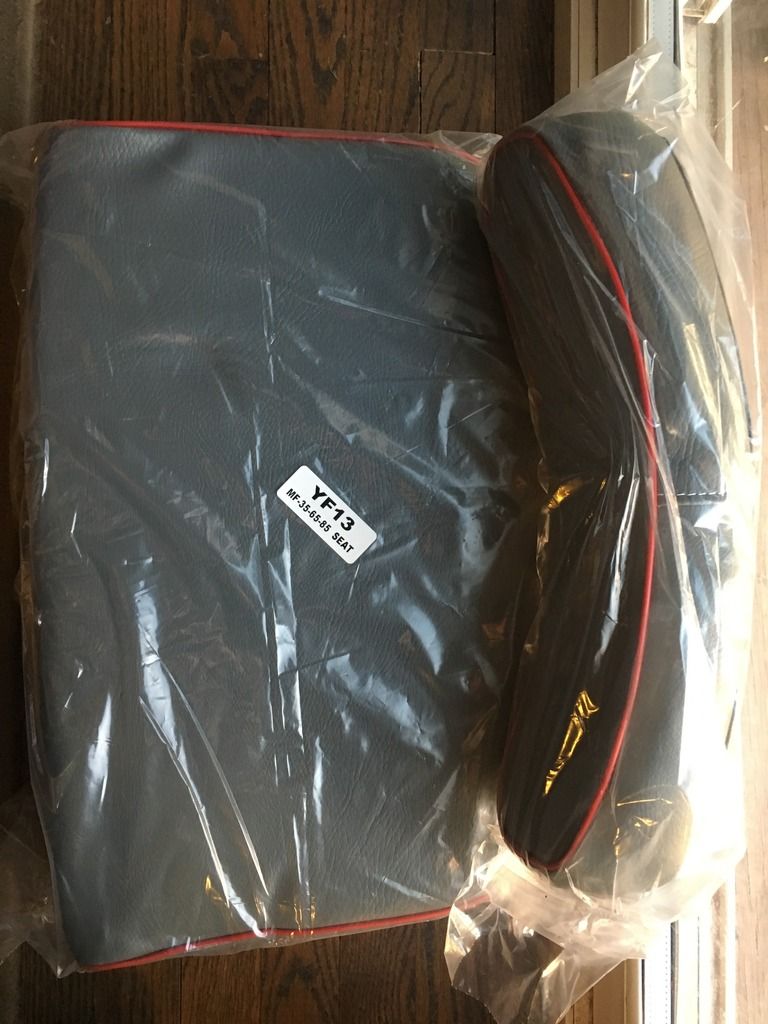

Some goodies came in; spin on filter conversion, new small items like filler caps and dipsticks, rad hoses, gauges, tach cable, 15 gallons UTF, two new rear R1 style rear tires, steering wheel, a new seat, etc.
I'm used to dealing with car restorations so the parts for this tractor are fairly cheap and I got a little carried away. I will be rebuilding the motor soon (she smokes pretty bad) but for now it runs fine. The main objective for this tractor is to move some Dana axles and a cummins 6bt around while I finish up the restoration on my Dodge Ram, then it'll get a full makeover and go to field work.

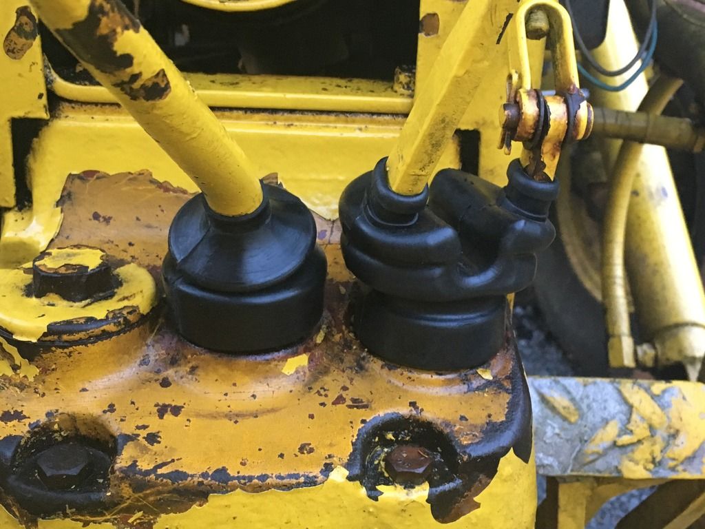

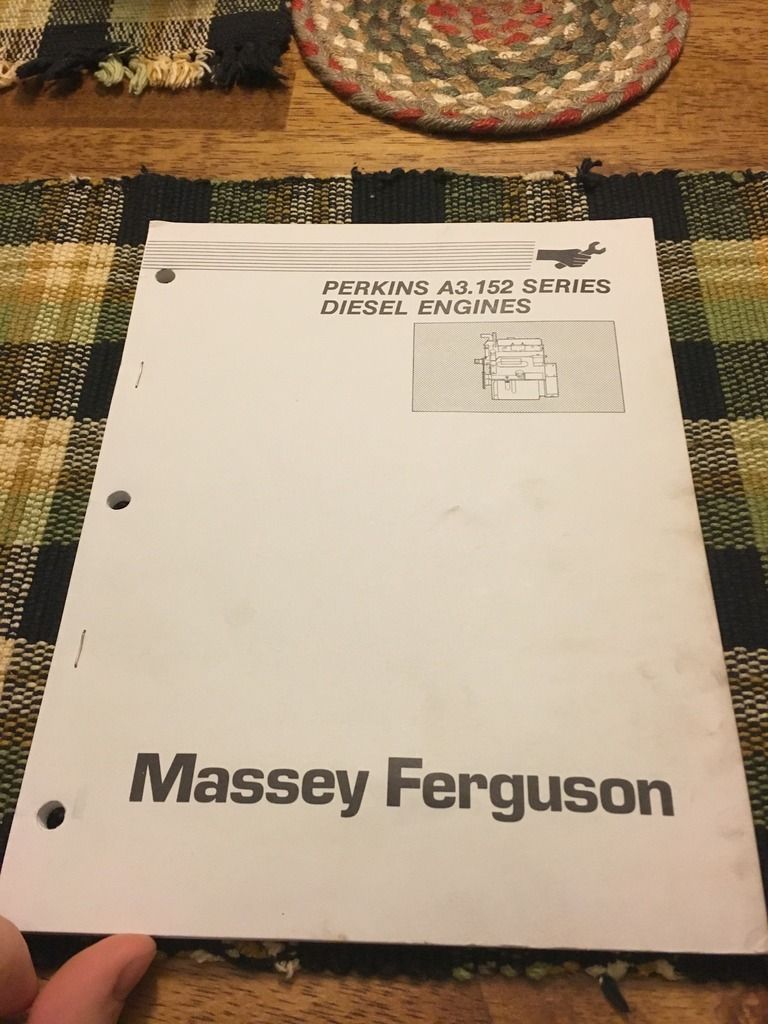

#13
More goodies came in the mail..
Hoping the mph registers are close on the tach. The speed ranges appear similar to what's called out in tractordata for the 40.. the gears seem to be a little longer than the AG 6 speed but similar to the tractor with multi power. As long as they're within a few percent of correct, it'll give me a constant to compare to when using this in the field (which I do plan to do).
Also picked up labeled shift knobs (I believe the oem were just round balls), newer style shift boot to match the dual stick boot, fuel sediment bowel, parts books and service manuals for the tractor and loader, a service manual for the perkins AD3.152 diesel.

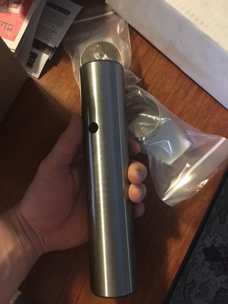

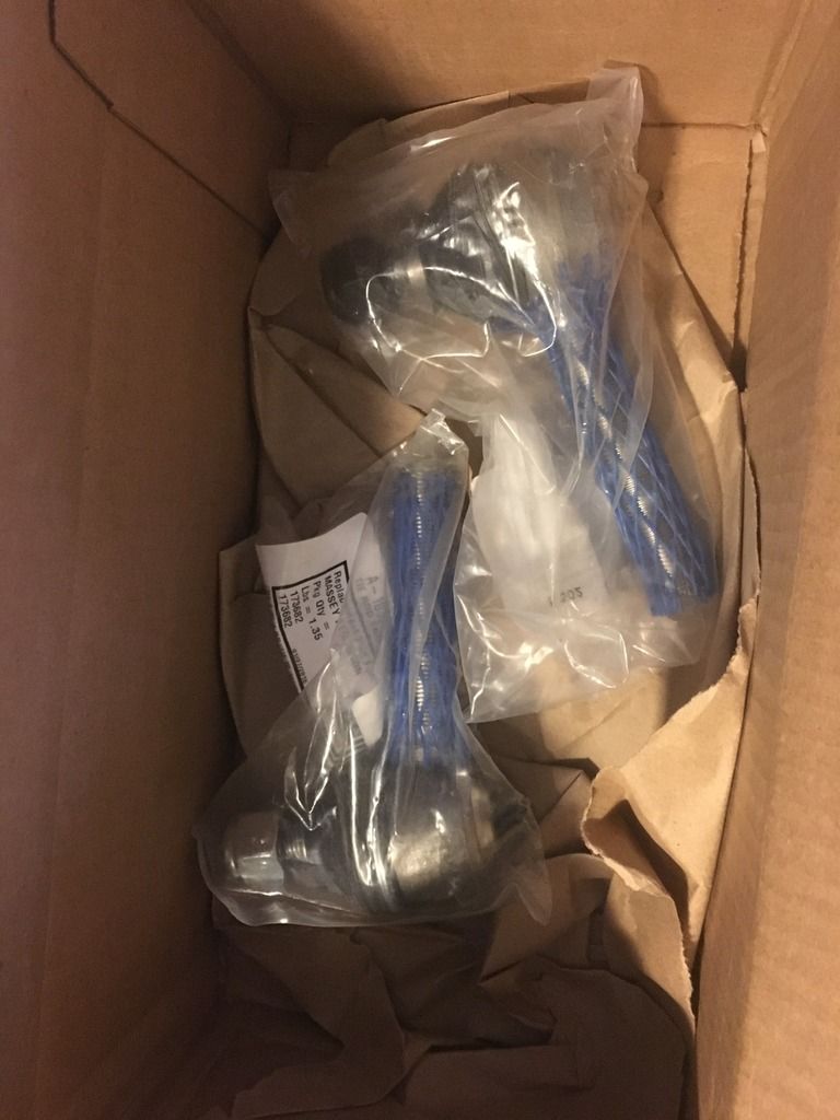

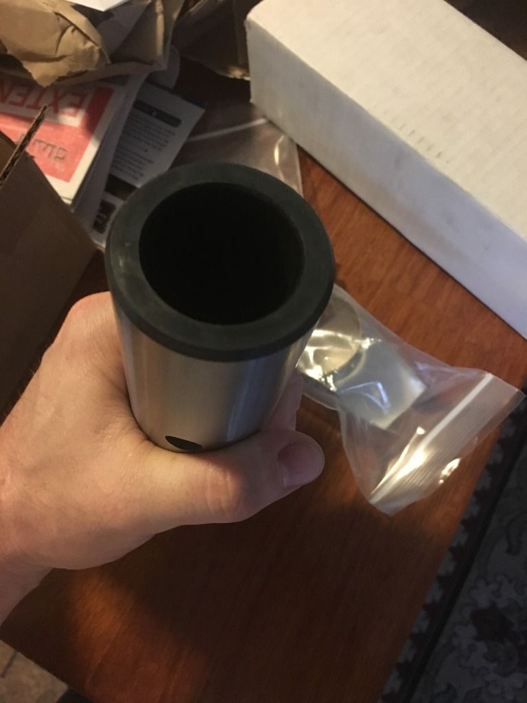

#14
New axle carrier was delivered. Also picked up a new pivot pin and bushings, tie rod ends for the drag link, and injector nozzles.
