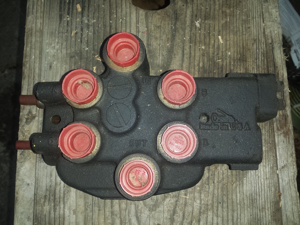

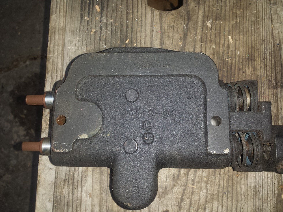

A friend gave me this valve and I can't make out what the brand is. I am wondering if it could be used to control a top and tilt system on my NH 2120. It has a rear remote with a single spool valve which I think has power beyond. He also gave me a hydraulic cylinder which I'd like to use for a power angle setup on my york rake which the existing rear remotes. Is it doable? Thanks. If it is I will need a little guidance from the experts here. I have a Weatherhead machine so I can make hoses to mount the valve where ever is convenient.

I don't see a relief valve or PB.
It could be a closed center valve.
You can test the valve using air.
Inject air to the IN port.
If no air comes from any port, it is a CC valve.
If air flows from the OUT port, it is open center valve.
/ help identifying valve
Thanks J. J. Did the air test and it is a closed center. In retrospect I guess the C stamped on the back should have clued me.
Not a showstopper for me, after all the reading I've done here on top and tilt setups I think it's time.
/ help identifying valve #4
The brand is Cessna.
Thanks. I couln't make it out. No good for my intentions.
