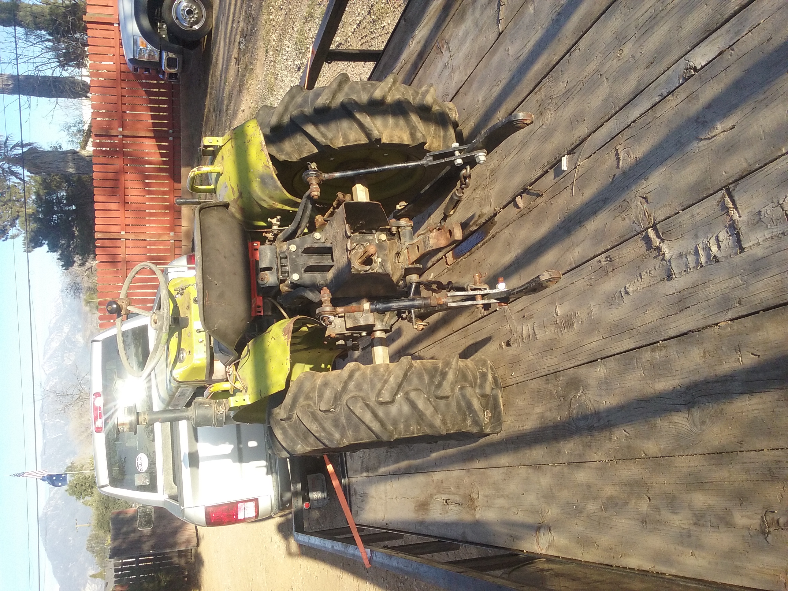

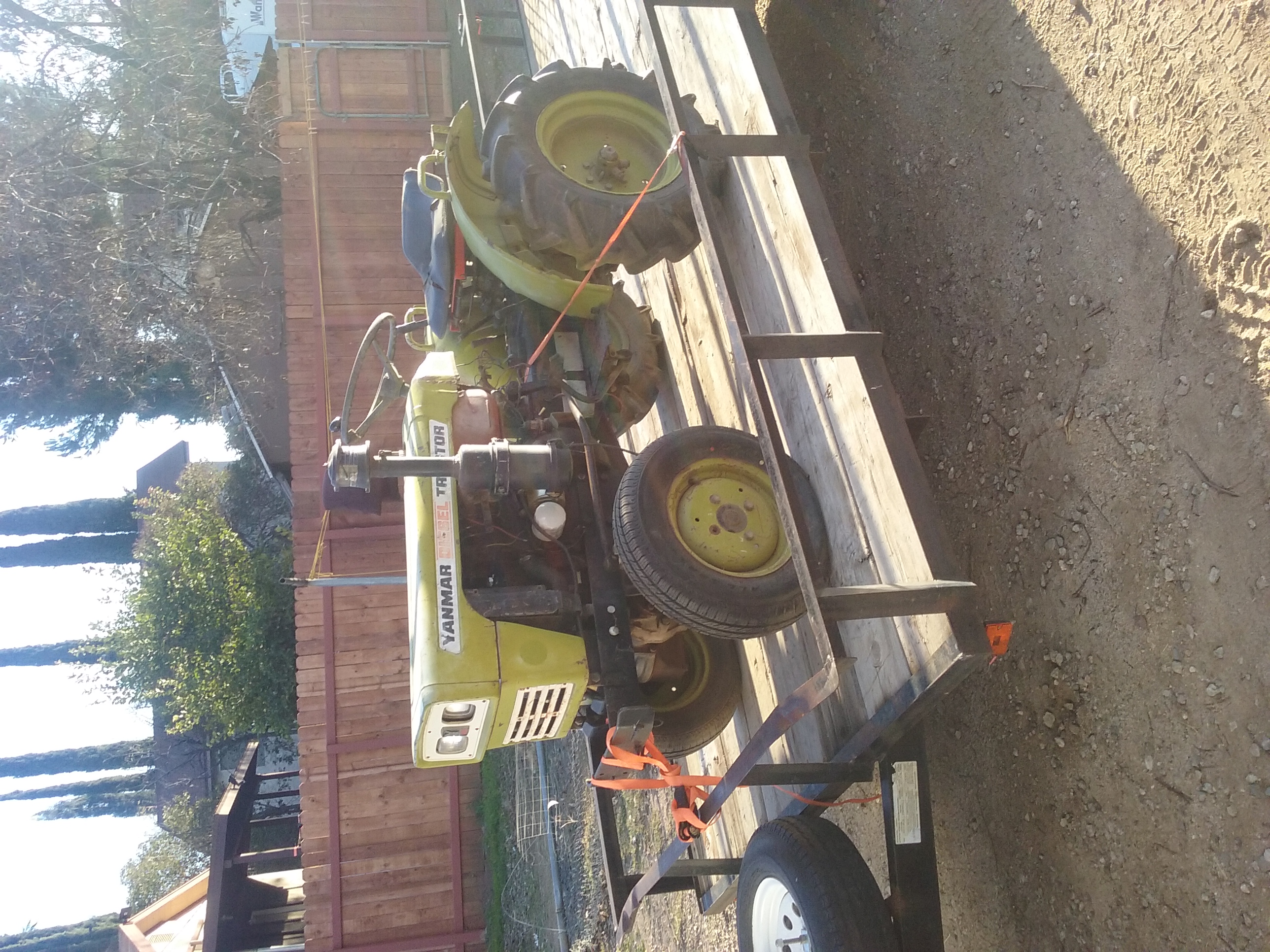

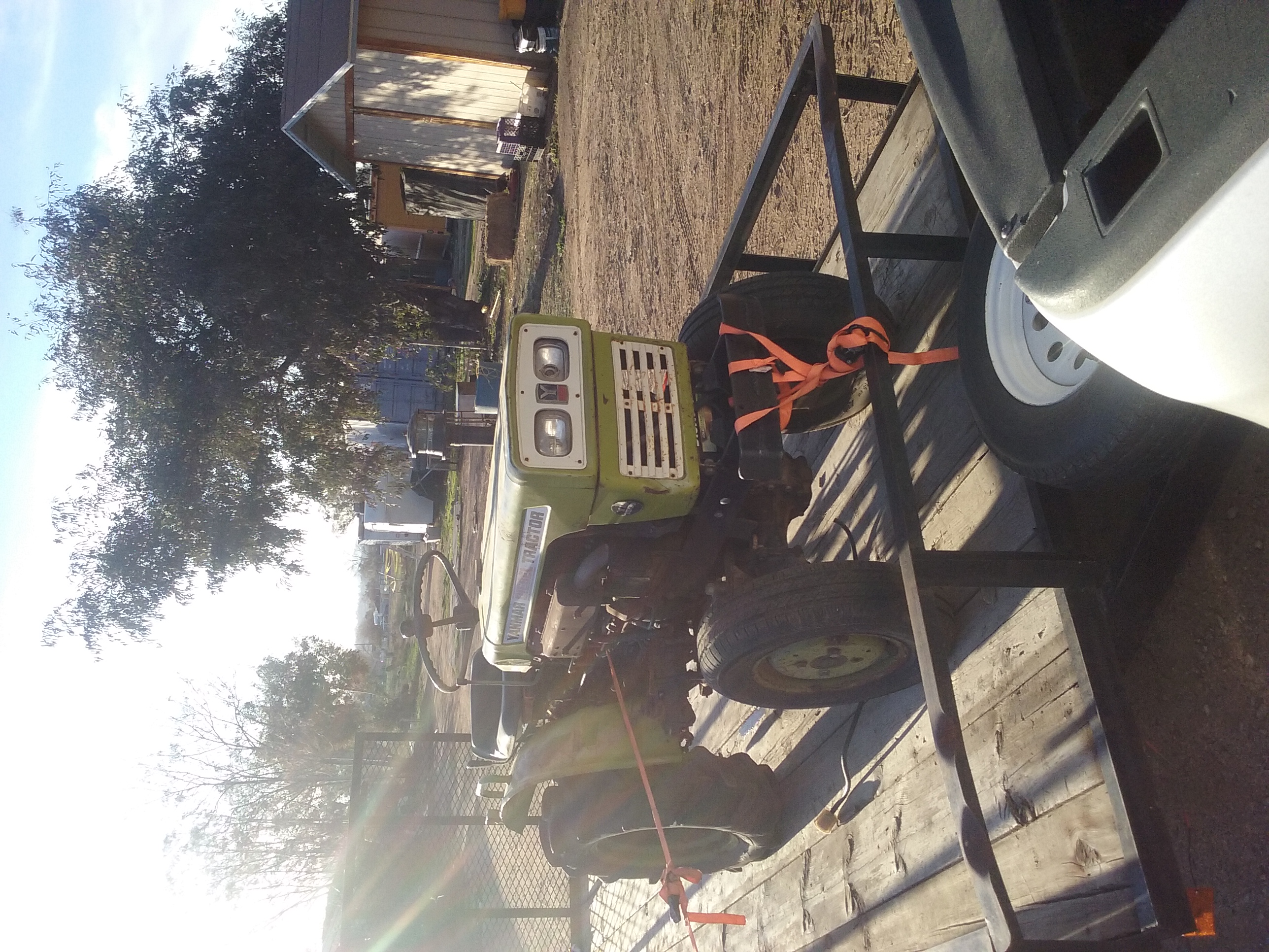

ok I type like a chicken so bear with me an ill try to tell as best I can the run down on what has happened to the 155d from the start when I bought it I was told that it was running tell it ran out of fuel then they tried with out success to restart it the fuel pump was taken off some wiring was also taken off and maybe some other thing so I bought it and now what I have done to it ok here go's at this point before I spent a lot of money on it I wanted to make sure that the engine even ran oh ya it needed the starter put back on as well so I put new studs in for the starter because they were all stripped out and put the starter back on drained the oil and put new oil in with a new oil filter as well put the fuel pump back on with the shim that came off of it back as well put water in the radiator as well I thought I would trey to start the engine by it self with out the rest of the tractor wiring being hooked up like say bench starting it because if I knew that the engine ran the I'm more willing to put the money in it as a restoration now the fuel filter set up that in my serves manual is also nonexistent ok that is were it stands as of now and I'm sure I have left out at least one or two things that's been done to this pore 155d now do you all thank it still has a shot at coming back to life I wish I knew of some one that could or would do it for me with out spending more then say $500.00 to just getting the engine running and I'm sure the rest of the restoration I'm more then able to handle ok I'm ready for some insight on it all now lol

Your photos show it was well maintained. Probably up until the most recent owner started doing bad things to it. It should be easy to restore it to running condition.
First things first, if he didn't give you the fuel filter assembly then for now get any kind of inline filter that matches the hose sizes. Something intended for a lawn mower or similar motor will be fine if the hose size matches.
Diesel pumps and injectors are reliable and run for years, decades, but this is conditional on never running debris through them. So that filter is critical.
If you are getting black smoke (combustion) or white 'smoke' (vaporized fuel) out the muffler then you are close to running.
