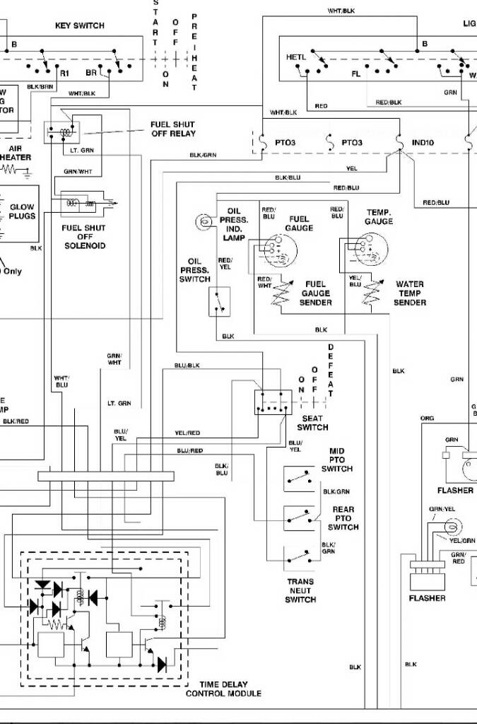

Hello,
I recently bought a JD 1070 (2WD, FEL, 8B backhoe, finish mower, box blade). Runs and drives strong, and I've enjoyed using the loader to clean up my small property. Unfortunately, I discovered an issue when I went to cut my grass with the 3 pt finish mower for the first time.
The problem: the engine completely dies/shuts off when I try to engage the PTO with the tractor in gear. The PTO DOES operate fine while the gearbox is in neutral, but as soon as I put it in gear, the engine gets killed.
Am I doing something wrong?
This is my first compact tractor and I'm learning as I go. I believe it's some sort of electrical interlock that's causing the problem, but I'm just not sure where to start troubleshooting. The seat safety switch must have been bypassed by a previous owner because it continues to run fine if I dismount the seat with the PTO running. I can also stand up fine while the tractor is in motion/in gear.
The combination of the PTO engaged and a gear selected IMMEDIATELY kills the engine; it doesn't bog down or stumble. With the PTO running, I can push the clutch in, but as soon as I click it into gear, the engine cuts out even before I release the clutch pedal. With the PTO off, I can clutch in, select any gear any range, and cruise around without any issue.
Has anyone had this issue or have an idea of what could be causing this?
Thanks for any help!!

Possibly the PTO switch is bad, but probably not since you can run the PTO with the tractor out of gear.
Most likely the 'black box' part that the safety switches feed into, and it makes the decision to kill power to the fuel solenoid (killing the engine just like you turned the key off) if the switches are in the wrong position safety wise.
A wiring diagram would be extremely helpful in this situation.

   / Help!! JD1070 - Engine Dies When Engaging PTO in Gear #6
This may help. Looks like switches interface so over-riding seat switch may foul things up.

Just glancing over the wiring diagram. The seat switch has three positions. On - Off - Defeat. Make sure the seat switch is in the on position instead of defeat.
   / Help!! JD1070 - Engine Dies When Engaging PTO in Gear #8
Raise the seat and pull up the black switch post. This is the defeat position. Push the clutch in and pull up the pto lever. The tractor should stay running or if you didn't start it, you should hear the clunk of the fuel shutoff solenoid.
If the seat switch tip is broken off or the tab on the seat doesn't engage it, then the motor should quit and the fuel solenoid should release. I put a new seat on my 1070 whose seat pan is a slightly different shape. Same problem. The OEM seats are black. If yours is yellow, it's definitely a newer seat and a candidate for causing your problem.

Thanks to all who assisted with this issue. It turned out to be the simplest of problems, as they often are. The seat switch had gone bad--it didnt matter if it was up, center, or down, a multi-meter proved that it was sending continuity on the "defeat" pins. After removing it and jumping the 1/3 wires, everything works as it should!!
