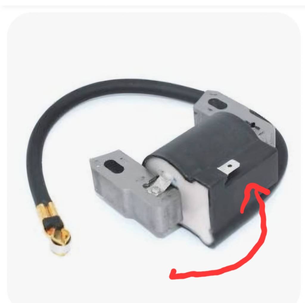

I connected a jumper between the clutch frame and the chassis ground, started the engine, engaged the PTO and it kept running! I then removed the jumper and it continued to work correctly. I am going to connect a wire just in case, but I think my problem is solved. Thanks for your suggestions!

I am trying to figure out how adding a ground would change anything unless existing ground is very marginal and the PTO surge was causing some ground overload causing ignition coil to not create a spark. Once coil is pulled in surge goes away and ignition coil now works again.
Strange failure and kudos for sticking with it and ultimately finding a solution.
/ Engine dies when pto engaged #27
Still doesn't explain why it was a problem when close to the engine, but not when farther away.... But if it works, run it!
