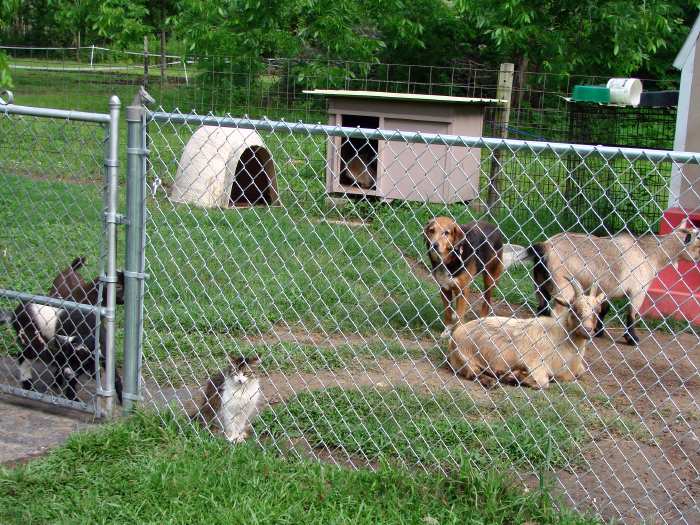

My wife raises pygmy goats to show so I built her a small pen by my barn. If you have a small pen and small goats you can use heavy gauge chain link but it must be built sturdy. Besides having all the posts set in concrete, I have stakes in the ground between posts connected to a heavy wire that I ran through the bottom of the fence to keep the goats from pushing the fence out. Very heavy wire ties must be used as the goats butt the fence and rub on it continuously.
I had field fence on the back side but had to reinforce it with cattle panels to keep the goats in.
I keep my horses in with one strand of white electric tape on portable posts which you can see in the background because they are much easier to control than goats.
