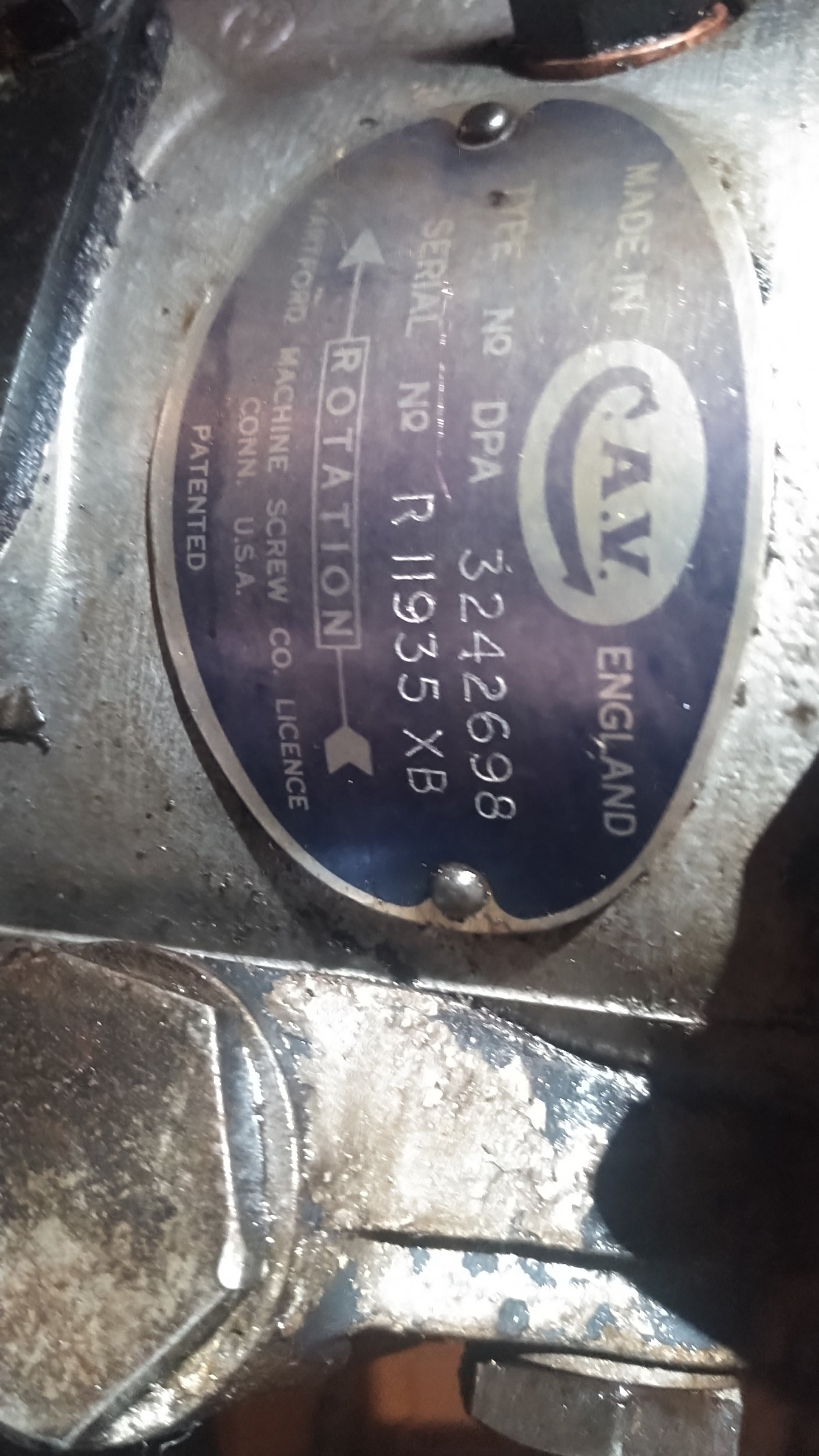

Forgive highjacking this thread.
Am trying to determine the correct throttle spring position on the fuel injection pump on a MF65. I have the chart, but the numbers on n the pump do not match up - no slash ("/") on the pump as indicated on the chart.
Thanks for any reply.
   / *help* Lucas cav injector pump govenor spring location *help* #13
It’s the # IN FRONT OF the 2300.. the crease goes right thru it..
THAT # looks like a 5..??
