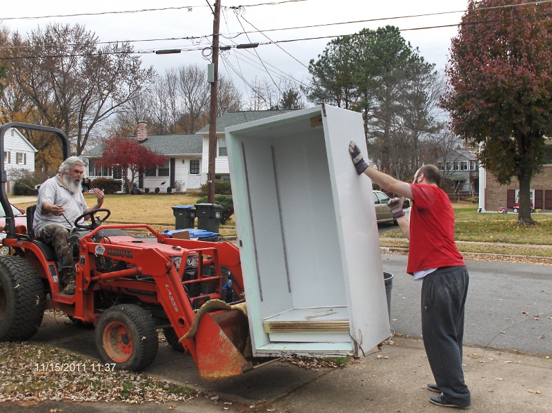

I also own both small and large. My 23HP B7610 fits through my 5' gates and can do most things my 50HP M4700 will do, just smaller pieces at a time. Smaller mower, moves shorter logs, lot less gravel in the bucket.

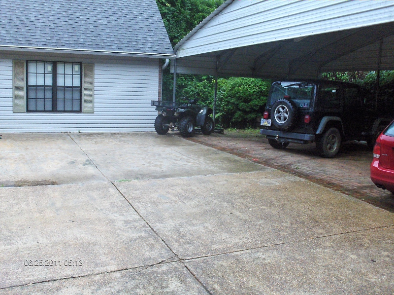

I fully understand your need to have a tractor you can "squeeze" past your choke point.
I've also a house in Mississippi where the ONLY outside access to the back is through a carport and down a brick paved path. My B7610 fits fine,
my M4700 doesn't fit in the carport.
But I can still move some big stuff with my B7610,
