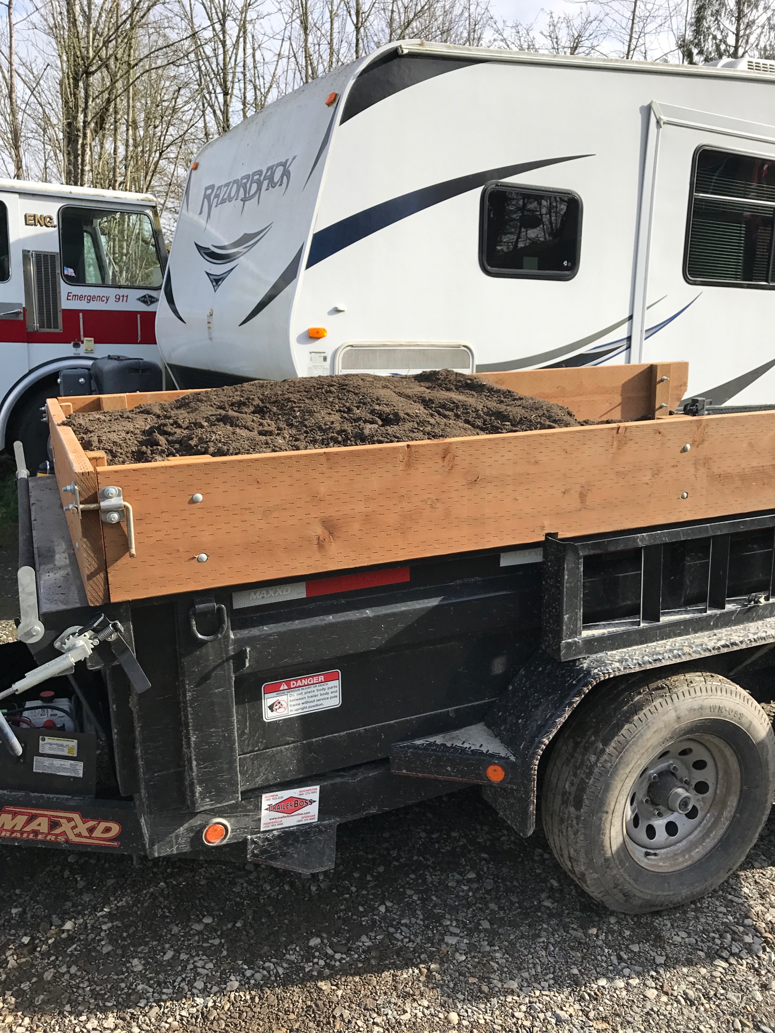

Insurance is as of now, I haven't heard if they are going after the landscape supplier or not. When I first call the company right after damage happened they offered me free material lol .. I don't need $5k worth of dirt. So if insurance doesn't want to recoup the money from them I will go after my deductible at least.

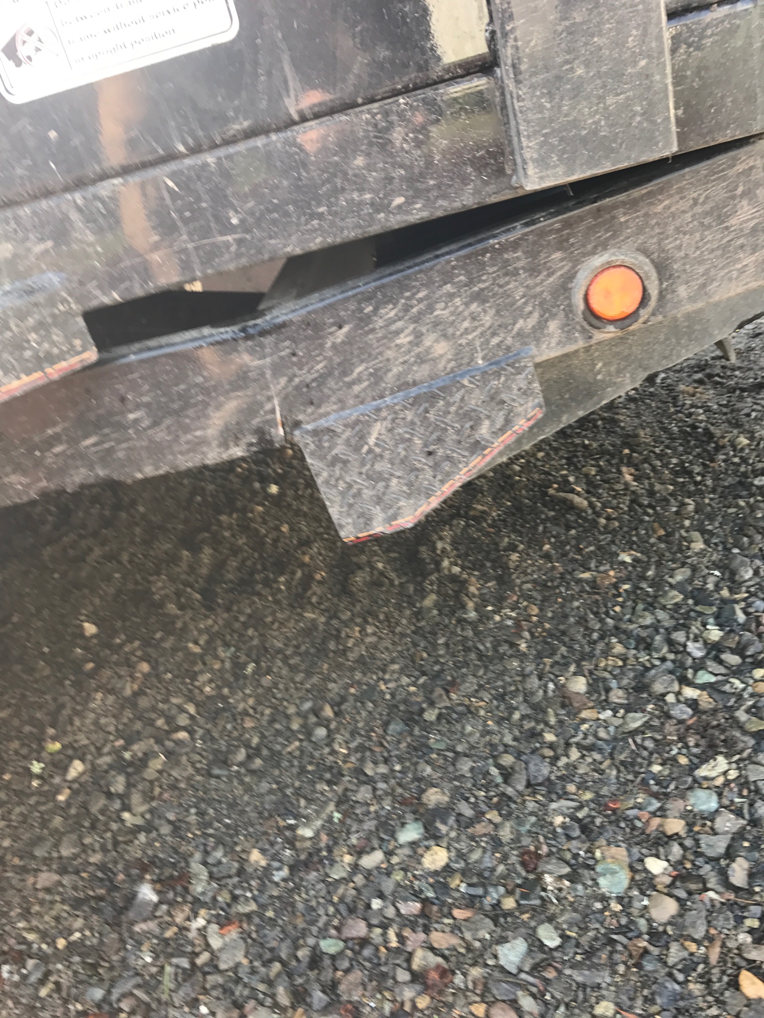

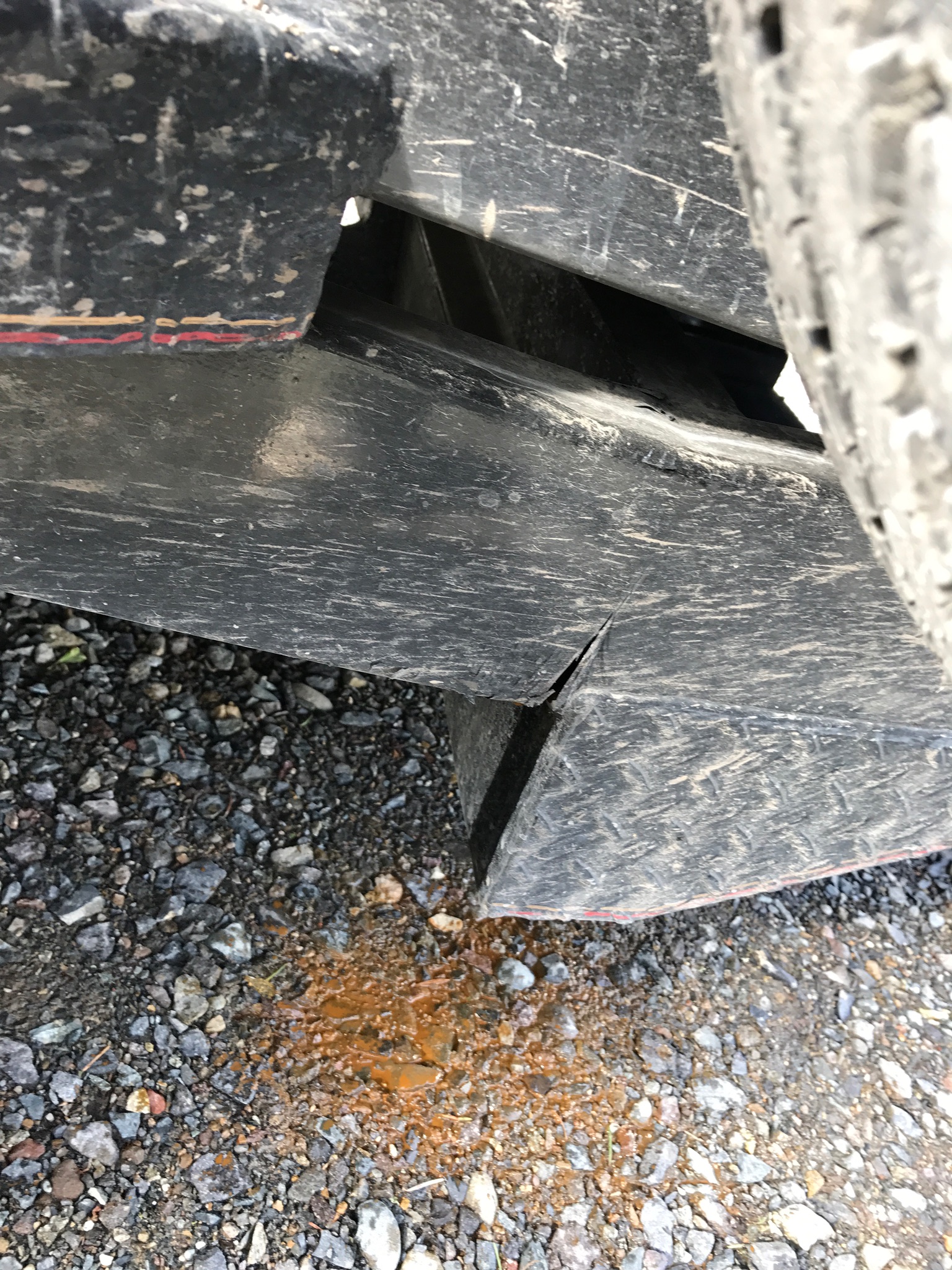

I'm finding that almost all manufacturers, if not all, use box tube for their bed frames. Many will use channel steel for cross members attached to the bed frame. The boxed bed frame materials differ in dimension(2" x 3" to 2" x 6") and thickness(0.120" to 0.188"). The smaller dimension box material is usually the thicker steel. It looks like BWise is using a heavy boxed material for their main frames. So my question is that since almost all 10k to 14k dump trailers use box steel somewhere in their frames is the concern only open ended boxed material ? Clearly dimension and thickness are key for strength if using box.
Chevyistop - It's disappointing that your MaxxD trailer cracked. Thanks for sharing with us as we can learn from that example. It looks like the main frame material was boxed 5" x 3" x 3/16"(0.188"). Looks new enough to not be a rust weakened example.
