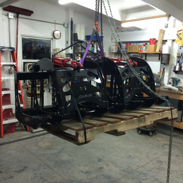

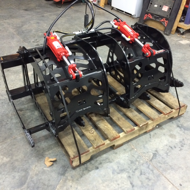

Thanks for the help guys! The grapple arrived at the local FedEx terminal this last weekend and I picked it up last night. I had to see what it looked like on the tractor so I dropped the bucket and put on the new toy, I mean tool.... No hydraulics hooked up yet, they arrive tomorrow from Discount Hydraulic Hose. I have the brush guard off right now, adding some expanded metal to it. Will post pics in a different thread when I finish it. By the way, having a hoist is a handy thing! With any luck at all I will be up and running this weekend! It is the Everything Attachments 60" dual lid

It looks really nice on that blue tractor.:thumbsup:

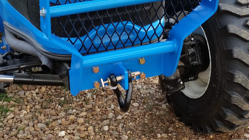

Here's how I modified my XR4046HC grill guard. Feel free to copy anything you like.
I added a padeye and install a clevis for tie down chain when I trailer the tractor. I put a clevis on drawbar also so no chains touch the tractor.

What are the 2 crossbars on the guard made of? Are they bolted on?

Cross bars are just pipe I had around. Tack welded a nut onto one side of a fender washer, then welded washer to each end of pipe with nut to inside of the pipe. Bolts attach to pipes thru the slots in sides of the guard.

You do nice work.:thumbsup:
