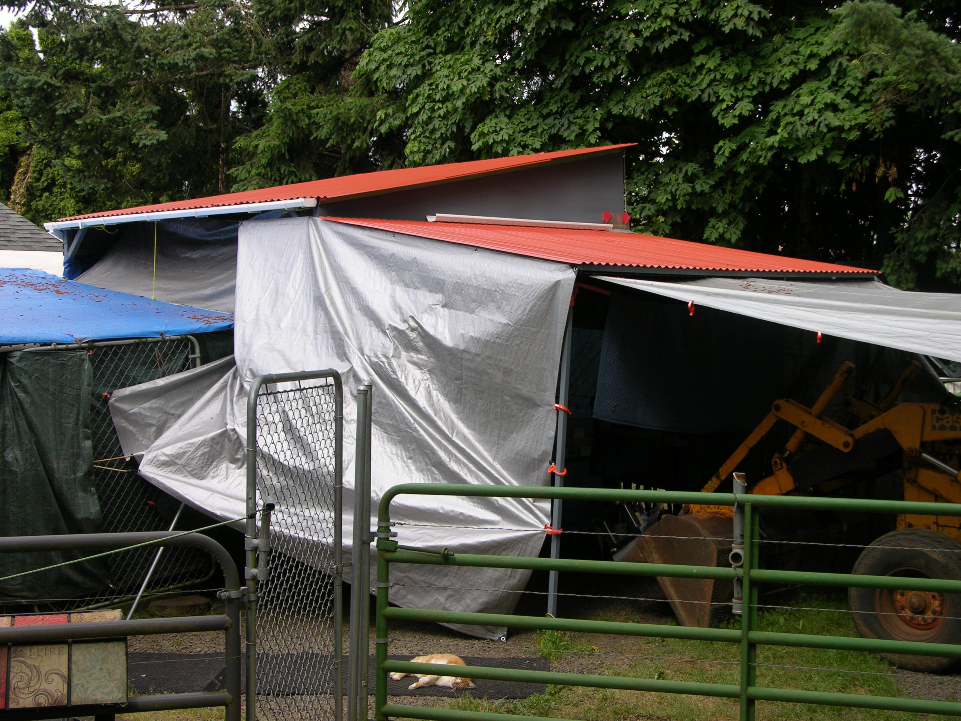

If you're still planning on the mm211, keep in mind that outside you'll have two choices - either run flux core wire, or come up with a wind-proof tent - otherwise you'll lose shielding gas if there's any wind whatever.
I went more with the "tent" idea, 'cause I like the cleaner welds with 75/25 gas -
The two red roofs are one "porta-shed" - larger part is 12'x12', smaller is 8'x12' - side roof verticals fold under and roof drops down, main part is framed in 2x2 square tube, roof "purlins" are spaced so I can drive my backhoe inside, raise the loader and pick up the entire shed, drive wherever I want it and set it down.
This might be slightly more extreme than you're willing to go :D
In my case, I know I'll always need portable shelter somewhere - next year I will drop several trees so I can build a new shop and studio, since the other shop is full of woodworking gear/materials - but that project will take a few years, so for now I have a dry, calm area I can weld in and (hopefully) get enough done on the tractors this winter so I can take advantage of good weather when it finally gets here.
Oh, I think you'll like the 211 - I liked mine, did a great job, but I wanted more :rolleyes: So when I found a deal on a mm252 with 2 tanks and spool gun I sold the 211 to a friend... Steve

What's that shiny stuff in front of the bucket?
Terry

Terry, what "shiny stuff" are you referring to - the black shiny stuff that's welded onto the bucket, or the sunlight peeking thru too short a tarp in the background? Here's what's part of the bucket - The three inboard receivers are for heavier stuff, center is boxed in with 10" channel so I can lift anything centered without worrying about bending that pristine bucket :rolleyes:
The 4 other receivers at the outer edges are for future projects and current brush bucket - future being hydraulically articulated 30 foot linkage for either an electric chain saw or my Samurai hydraulic cutter. I have all the fittings, etc, for adding 2 solenoid diverters to re-route the curl function, plus a high flow motor circuit with a flow divider. One of the diverters will also be used for the 930 pound grapple that's sitting on a pallet waiting for my QA project to get done.

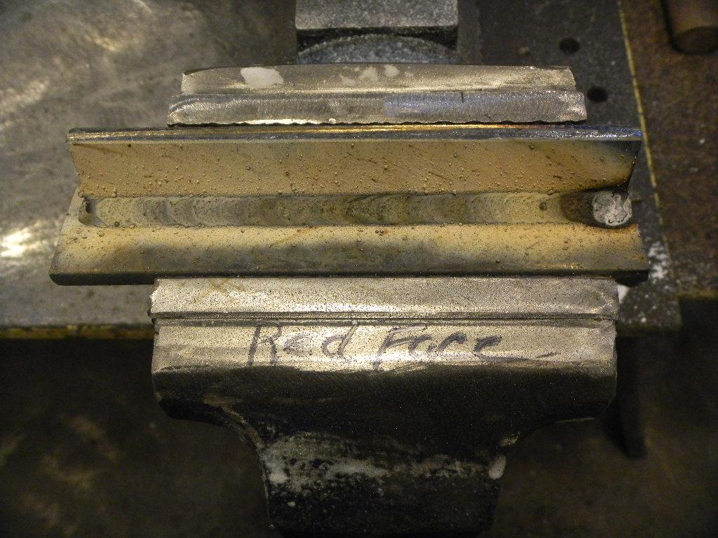

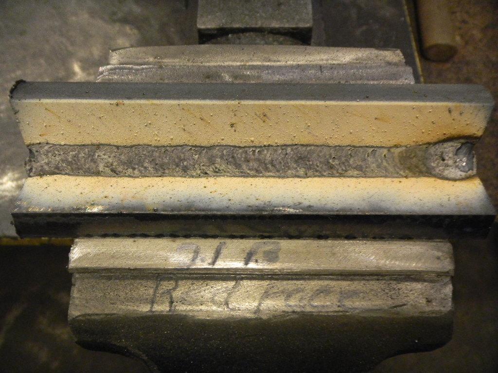

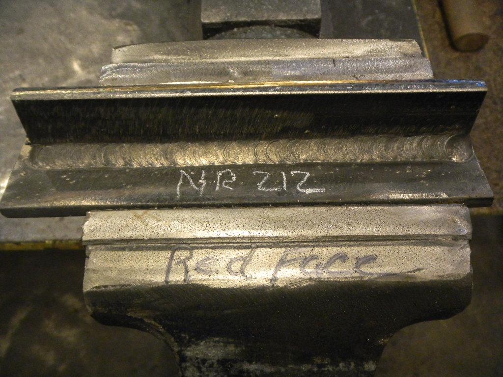

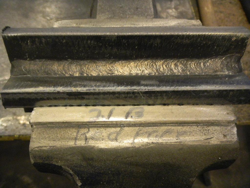

Colonel Monk according to Miller's spec sheet for the MM-211 you can run .030" to .045" shelf shielded wire. I really like Hobart's Fabshield 21-B, and Lincoln's NR-212. Both will run great on a CC only machine, but seems everything runs better on a CV machine.

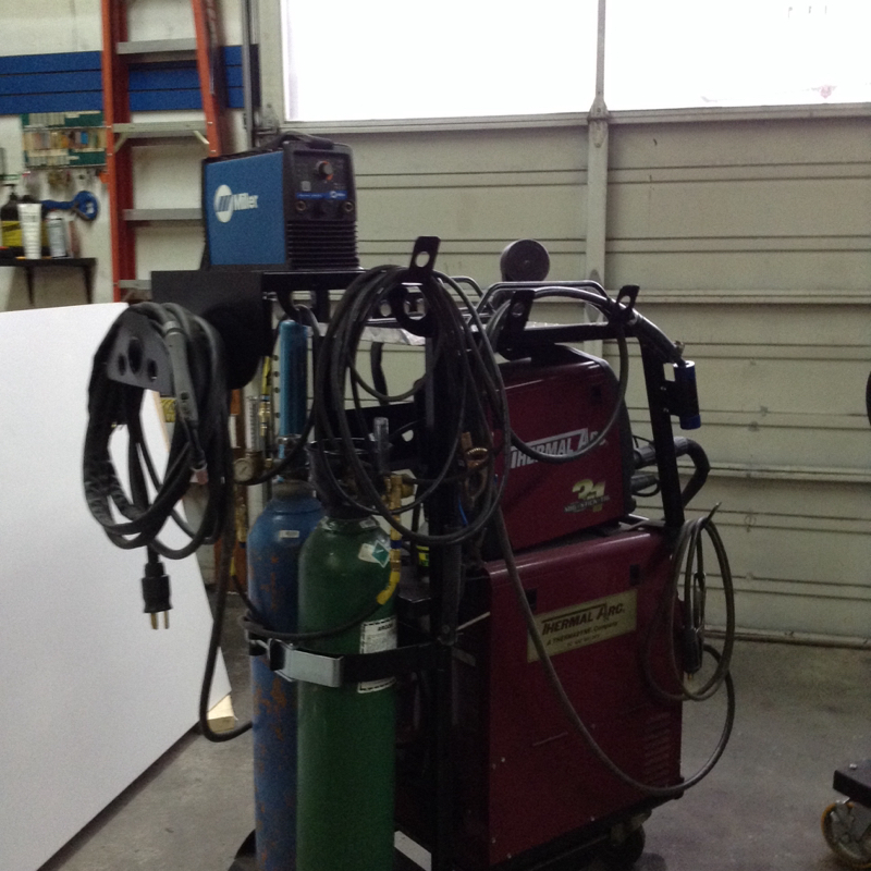

Colonel Monk if you are building your own cart here are a few random suggestions.
If you are at all considering adding a spool gun to your 211 at some time, make provision for two tanks as you will require argon for aluminum welding.
If a plasma cutter is in your future, provide a space for it also. I mounted my small inverter Maxstar and plasma on a rack above my tanks. They are interchangeable as they share the same case dimensions.
Be sure to integrate several "hangers" on your cart to facilitate neat (disregard this aspect in my photo) cable management.
To keep the machines secure I usually bolt them from the underside by building a tray if necessary. I really hate the look of a welder secured with a ratchet strap or tie downs.
On a similar note tanks secured with a strap or chains don't appeal to me. You may consider a system I use on my welding and oxy-acet carts. I purchased propane tank clamps used on forklifts etc., 'massaged' the clamps in my hydraulic press and fabricated new straps and hinges.

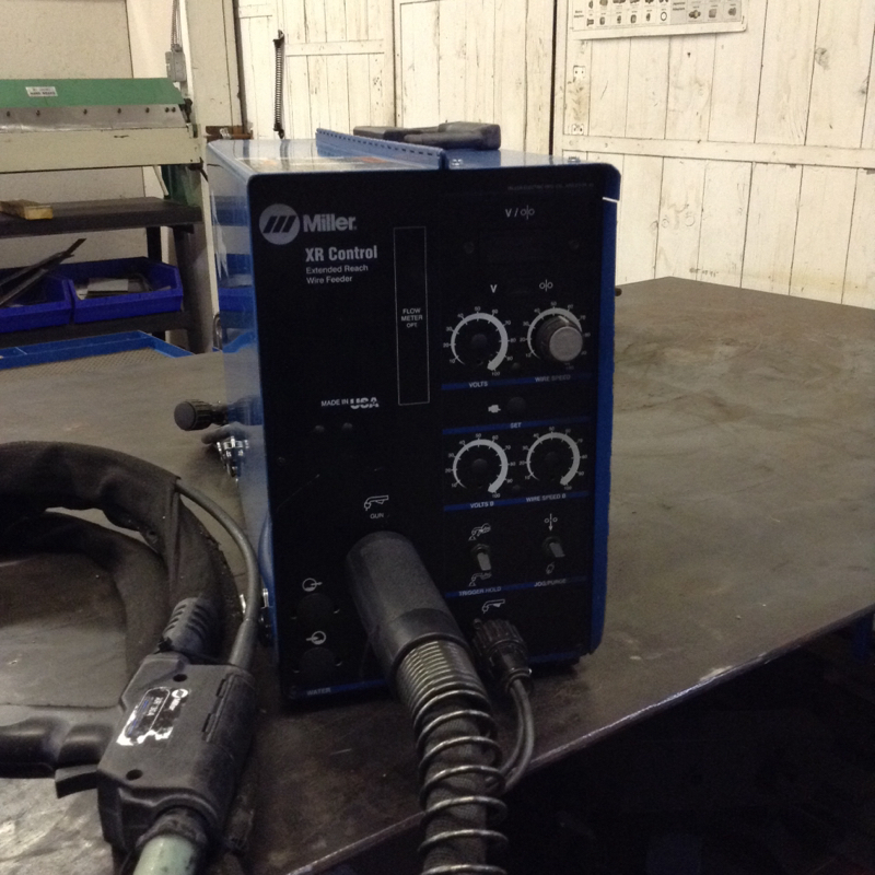

Finally, plan for expansion. I thought I had it all figured out earlier this year when I built the cart for my XMT. Didn't want it to be top heavy so I left just enough room on the bottom shelf to accommodate a water cooler if I ever needed one. As it turns out I'll now have to build a new cart to accommodate the push pull feeder I ran into. ( I think it was S A that said ' you can never have too many welders'. (?).
I'll post a few pics in random order. If you need any close ups for detail let me know.
Terry
