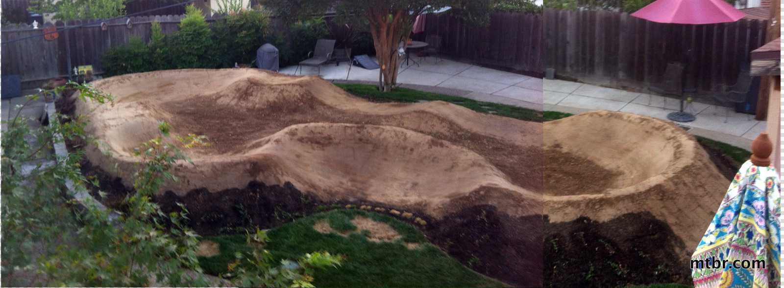

A smaller tractor will be better for mowing, a larger tractor will be better for ground engaging. Either should do most of your tasks well, with a couple of exceptions. First, moving 30 yards of material will take a while, the bigger the bucket the faster it will go, but the tractors in a reasonable size for mowing will still have a "small" bucket. I spread 30 yards of mulch this year with my little tractor, it was a LOT of buckets! Second, the trees. I assume you'd like to remove the stumps? You wont be able to do it easily. You won't even come close to being able to pull them out, and trying to dig them out with the bucket will create quite the mess. A backhoe is the best way to remove the stumps with a small tractor, but they are very expensive, and hard to justify unless you have many tasks for it. I would just rent a stump grinder.

Thank you for all of the suggestions so far. I'm still leaning towards the JD 2520, but keeping my eye out in case a nice JD 855 or Kubota B2630 pops up. I'm also researching MMM vs. RFM for my mowing needs. That decision could push me one way or another with my purchase. Storage space is a limitation, so I won't be pursuing the zero turn mower plus tractor / loader option.
To Fiziksgeek's concern about a smaller bucket for my 30 yards of dirt, that shouldn't be a problem. It'll actually be a benefit as I try to place the dirt. Here's something like what I plan to build.
