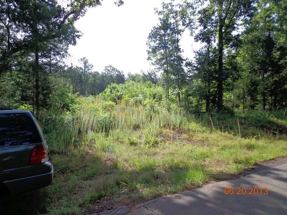

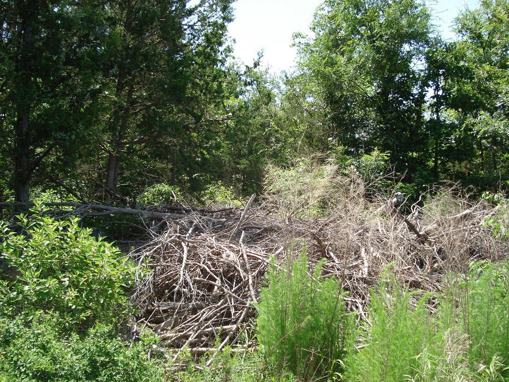

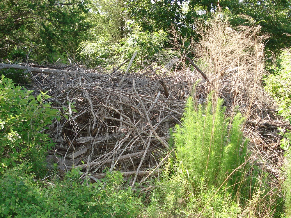

Trying to find out what some of the more experianced operators think. I found an older D4c that the undercarriage was in good shape. But,it did have worn blade pins and holes(Where the blade attaches to the blade frame and dozer frame) and grouser pads(30%). This dozer weighs around 11k lbs. But, probably more, as it has Orops and sweeps. So, maybe 12.5K. I have also found several track loaders in the same price range and wonder if they might be better overall for me. There is a Case 455c and 855D. There was a JD555G and lastly a Komatsu D53s. All of these were in the $13K price range like the dozer. There was also a Cat 931 that was an old farm dozer. Owner said it had an undercarriage of 30-40% for $9,500. I know that weight and power are your friends. All of the loaders have the 4 n 1 or multi-purpose bucket.

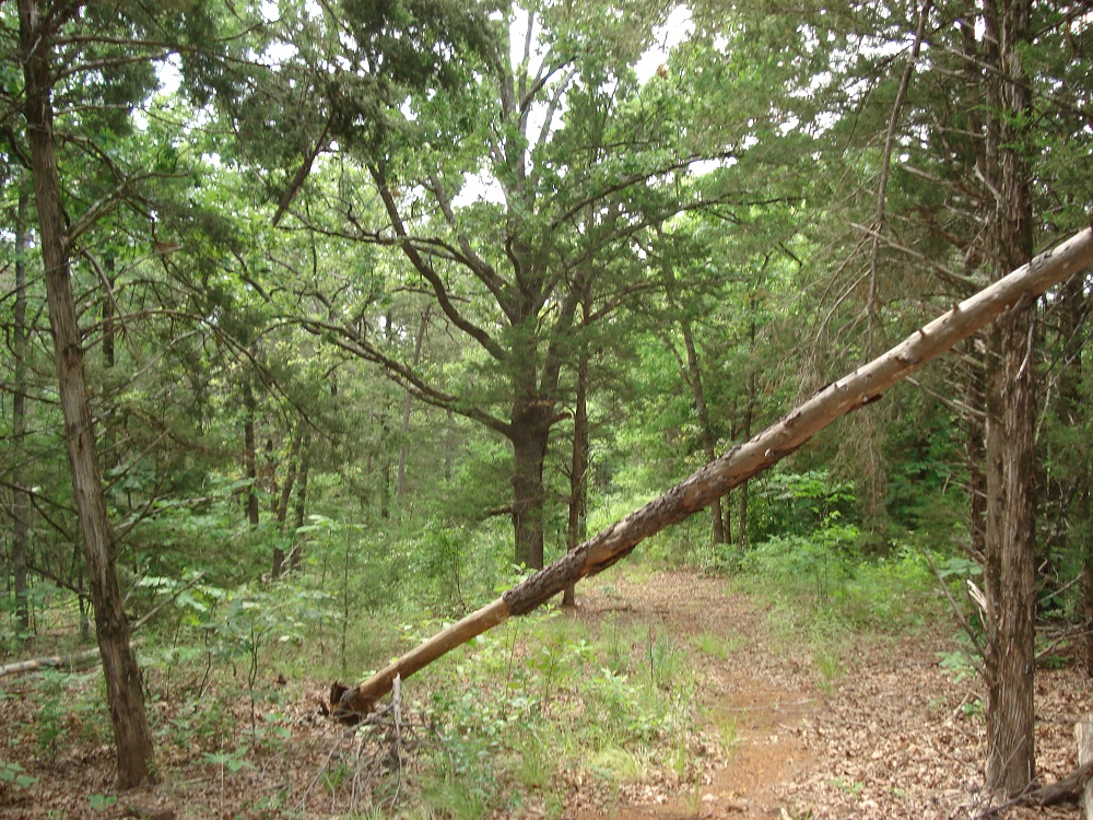

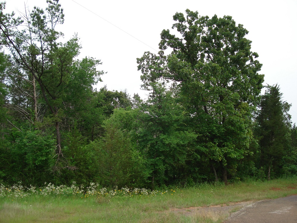

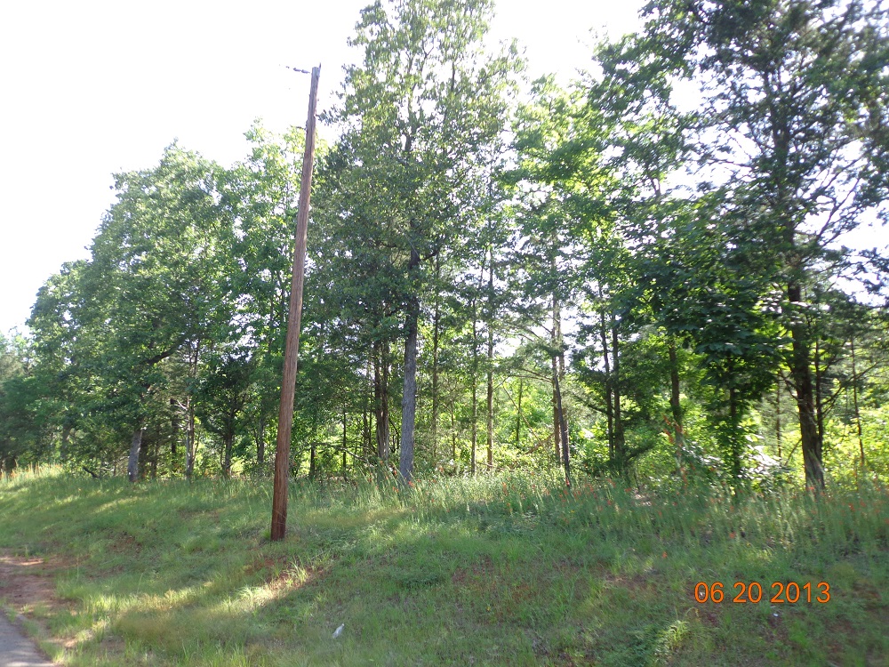

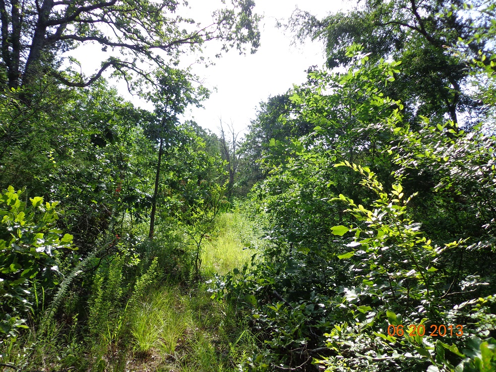

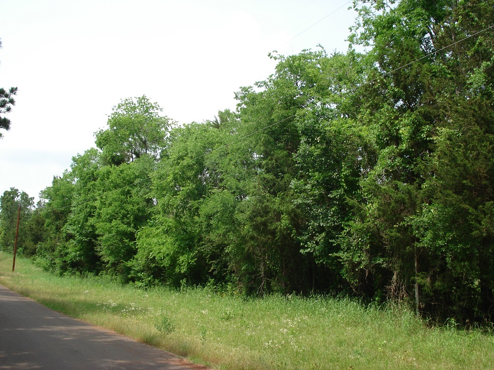

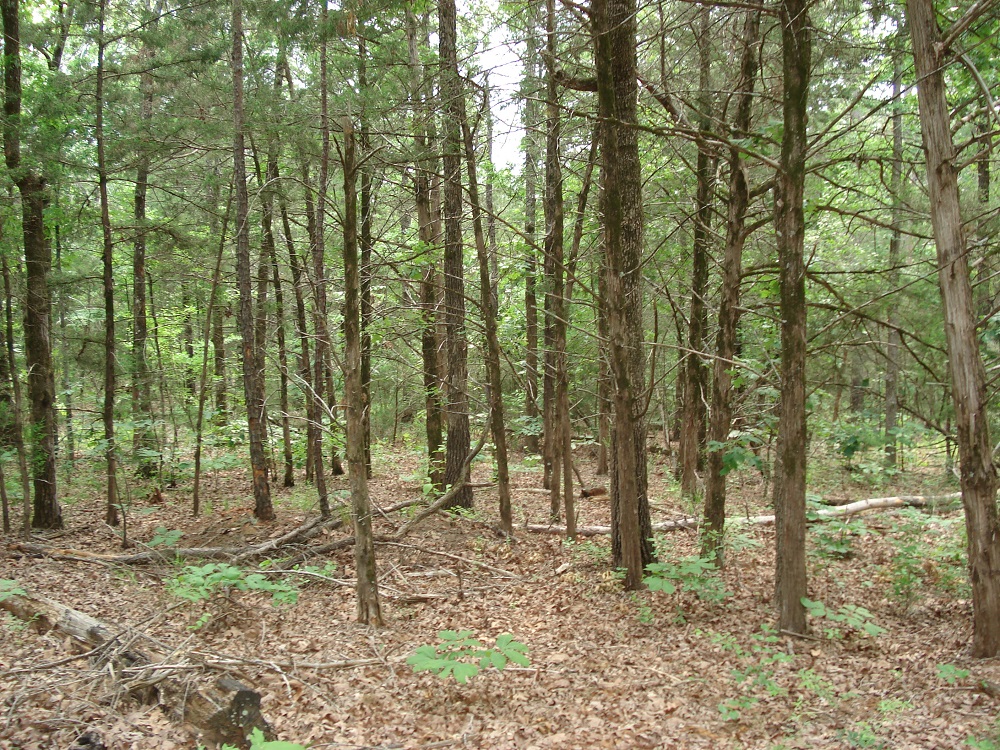

I recently purchased an old neglected timber tract and need something to get it into shape again. I don't have time to go the rental route and it's taken 6 months to get someone to come out and look at doing the work and he's 2 months behind. But, he's expensive I thought. But, I'm still having him do it because I needed it done by Labor day and that has come and gone. That's why I'm getting somethingto do it myself.

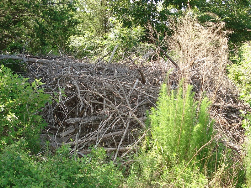

Basically I'll be using it for fence-lines, cleaning up underbrush, pushing up the underbrush and hauling it to the burn pile. There's also some brush pile that someone before me that need moved and burnt. I will occasionally push and clear out some smaller sapplings and larger dead trees. In one area I thought about a small pond 1/2 acre or so.
So, do you think in your opinions I'd be better off with the small dozer or do you think that the loader whichever one I decide to get would work? Any opinions on the loaders. I will appriciate your responses. I was originally going to get the dozer when I thought it weighed 16K lbs (newer one)vs the 11-12K (older one).
