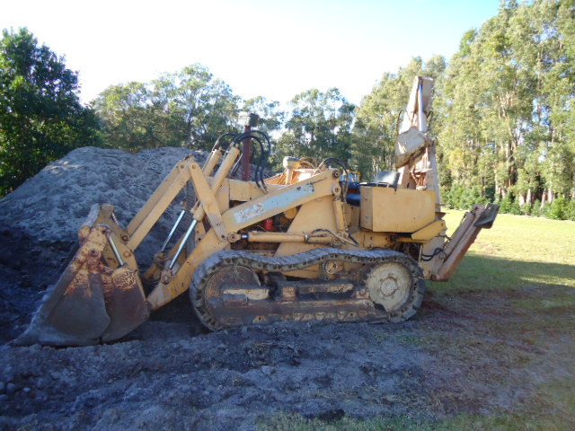

A few days ago I saw a track loader with a backhoe. About all left to add would be a crane on the side. :)
Bruce
Track Loader Backhoes are great in theory but poor in practice, the backhoe unbalances most machines & hinders the departure angle significantly when the going gets rough - a backhoe on a skid steer is big compromise, a hoe on a track loader takes it to a whole new level...........
We used to run a 977 with a 4/1, logging winch & a very large rear mounted hydraulic crane which proved a fantastic combination for culvert/pipe work, bridge construction & greenfield shed building.

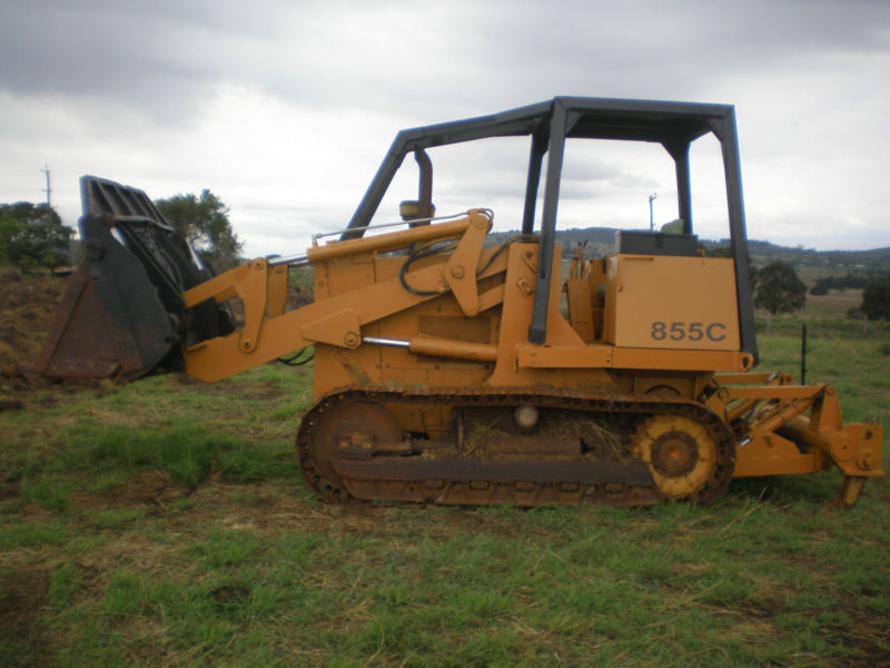

I just watched a large chunk of land get cleared and a large deep lake built by a friend of mine. His father is an operator and they purchased a 953 for $25k. I looked at a lot of machines with his family they are/were long time mine mechanics. Amazing the stuff people pass off as "good undercarriage". If you see a 75% undercarriage that usually means 25% unless you plan on turning pins. Most were below 50 and when you pulled a oil plugs on a final one would be good and crap. Lots of people bought something didn't know track maintenance and now have a machine with a mountainous repair bill. Some even seemed offended when his family would politely point out issues like letting pins go too far to turn or other things. "well it works fine for me" was a popular saying. Sorry for derail OP I vote like others do for a trackloader.

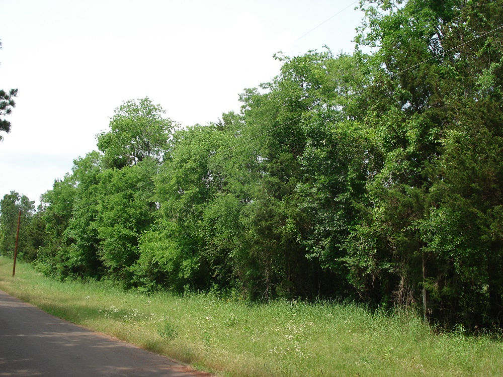

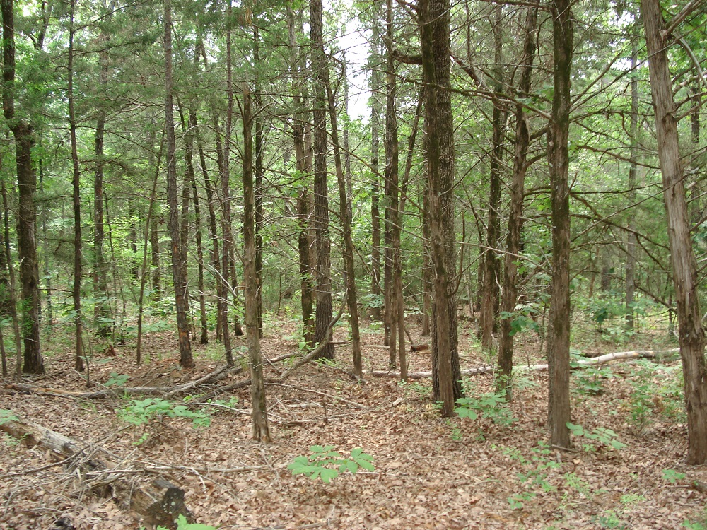

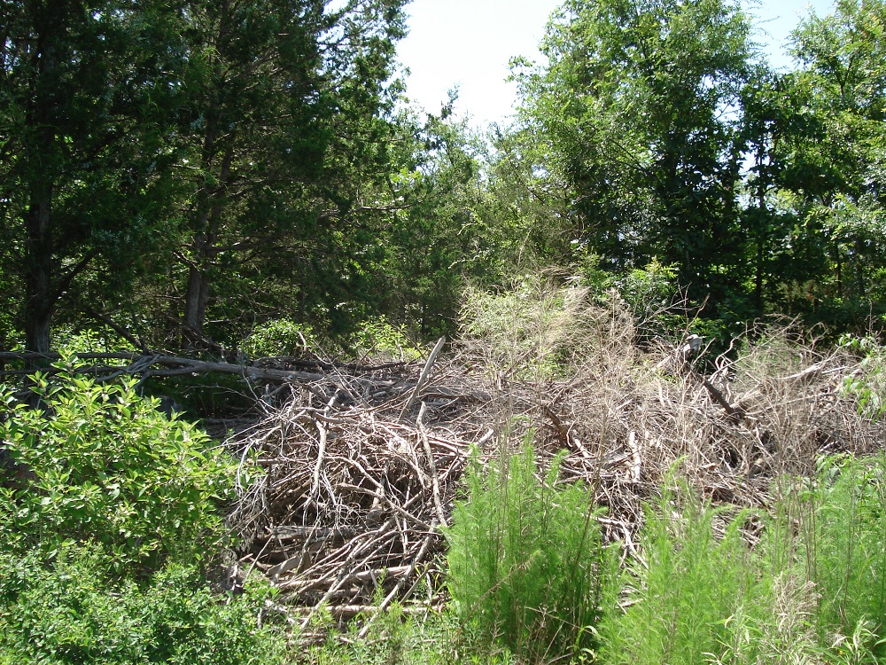

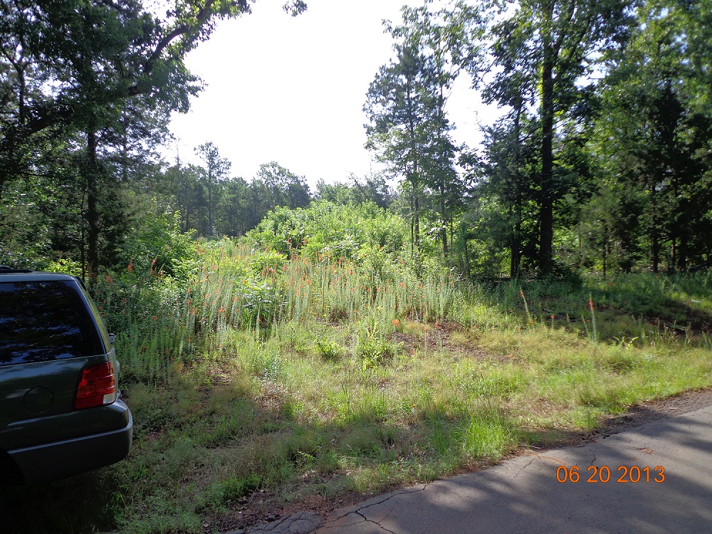

Well, right now I haven't come up with anything better than the D4C I originally looked at. I will keep looking though. But, I was thinking if I got the D4 then I could do the undergrowth clean-up and leave the larger stuff to the other guy. When I looked at it I figured (my estimate) that it would take about 8-10 hours. Based on what I've had others do for me. I figured $1000.00 - $1200.00. The owner/operators estimate was 2 days and $3000.00. So, basically it came out 2-3 times what I thought it should. That's $150.00 an hour for a 10 hour day. I thought that was a little high. I know, if you buy one and have to repair it you might appriciate the $3000 for two days. But, buying my own, I could do it when I could as needed. Then leave him the big stuff for later. My analogy may be flawed. But, even if I spent $6000.00 on repairing it that would only be 4 days work and I'd still have it the rest of the year to use whenever I needed it.
Any thoughts,comments or ideas?
