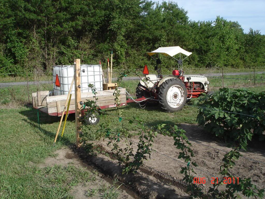

Here's why I built mine. We own some pasture ground, about 3 miles away as the crow flies, and wanted to develop a market garden on part of it a couple of years back. I had already worked up a good size deer plot in the back of it, that bordered a sanctuary area of THICK brush and blackberry briars, and didn't spray anything to burn down before I plowed. Talk about a workout on the 8N and a 2-14 Ferguson! Hey, seat time is seat time, right? Got to looking for a decent priced boom sprayer, never found one. Searched this site and found this thread, http://www.tractorbynet.com/forums/build-yourself/82223-building-boom-sprayer-w-foam.html . There are some excellent ideas to be gleaned from it. I decided on a 3 point unit with a roller pump for the versatility and easy hook-up. Although my sprayer tank is pretty small by most standards, 30 gallons, it works for my application. Water is 8+ lbs/gal, the 300 lbs or so the whole sprayer full of solution weighs is not too much for my tractor to work with. It's been plenty of product, too. I had 2 garden plots 140 x 140 to work up, had enough to do both and spray the fence line, too. Plowing was oodles easier. If you're wanting the sprayer for no tilling, I wouldn't think you'd want to have to apply herbicide on your plots out of your truck, or a trailer. Boom sprayers are fairly simple to fabricate. I like the added satisfaction of the build. I'm upgrading mine with 12V solenoid valves for ease of operation from the "cab" of the 8N, better spray wand, and a slightly larger (35 gal) tank. HTH Mark
   / Help me decide on a herbicide sprayer #6
Oh, here's my solution to no water at the market garden problem. Pump it on and off with the same roller pump used to power the boom sprayer. :D Another reason for the 3 point sprayer. Mark
