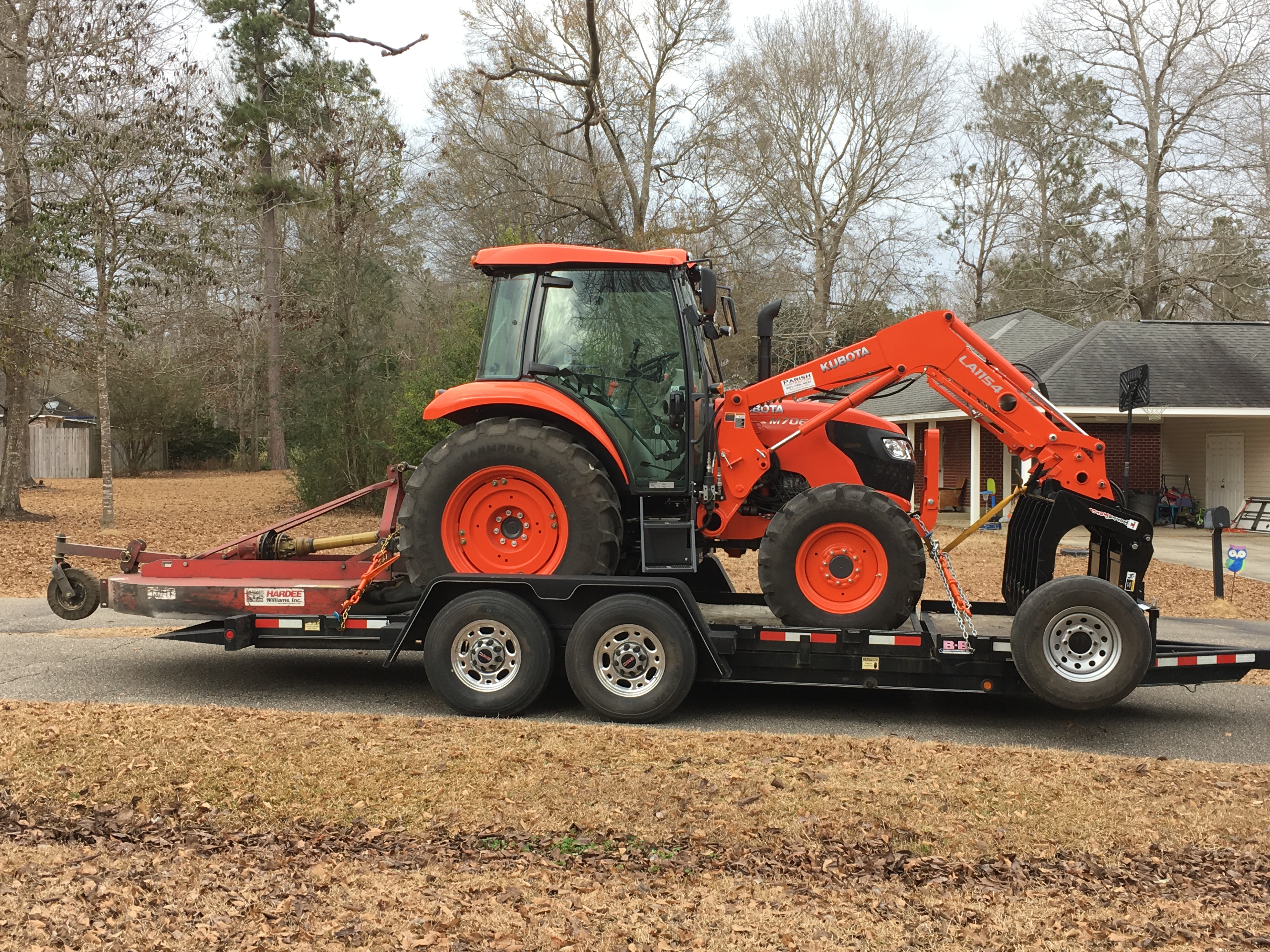

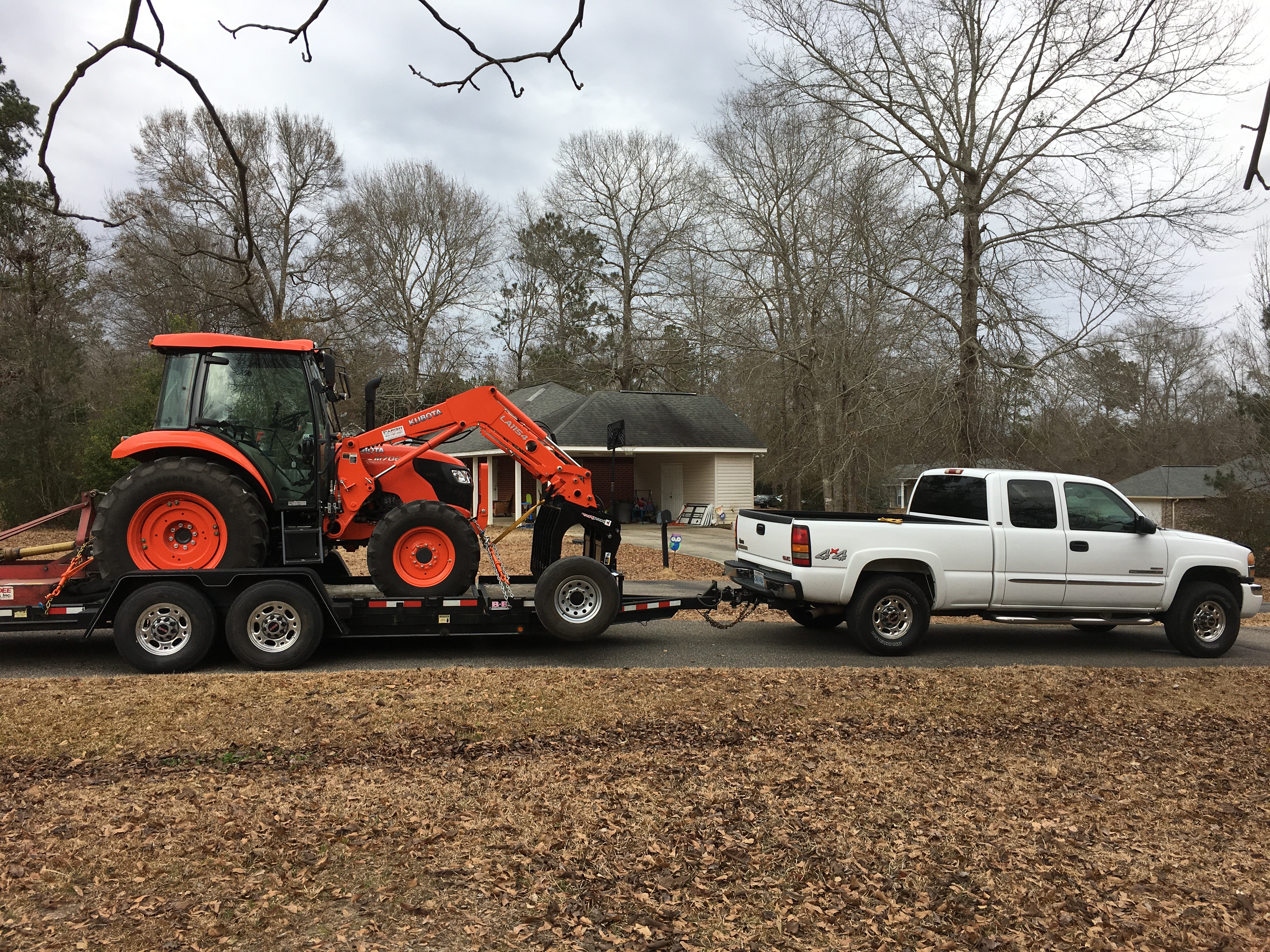

You will love the tilt trailer! I have had mine for over 10 years and will never have a ramp type non tilt for my main trailer again. This trailer is a little over 20' overall with the front 4' fixed. It just fits the 7060. My next trailer will likely be a 32' overall with a hydraulic powered tilt gooseneck with the 10K axles with the 17.5 super single tires.
