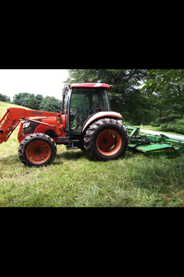

Here’s my M-7040 with an 8’ Deere twin spindle about 15 years ago.
