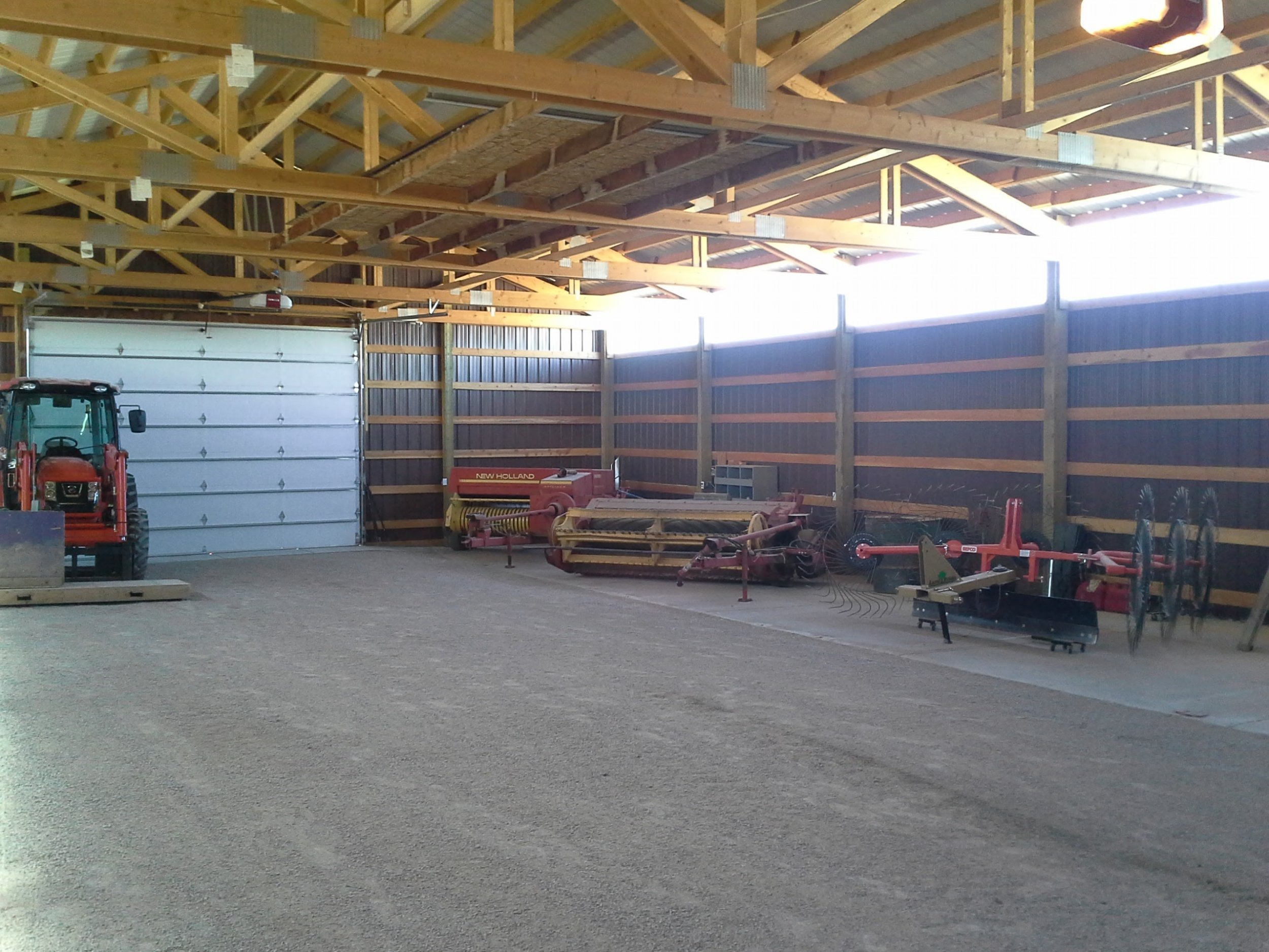

I prefer doors on each end so you can pull in back your implement into it's space and unhook. I don't like moving this to get at that. With that in mind this is how I have done mine. If you can use wheeled dollies to move stuff around that's a good idea.
This is just a small part of my barn but you get the idea. I also poured concrete around the outside walls to prevent rodents from getting in.
