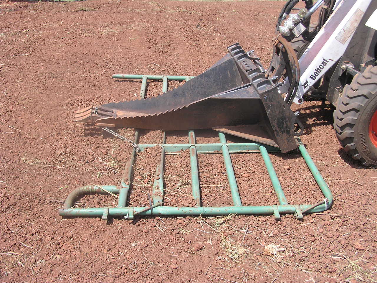

I pulled this gate out of the scrap pile, suspended it with chains. Worked great for dirt:
If you made something heavier, the chains provide float going forward.

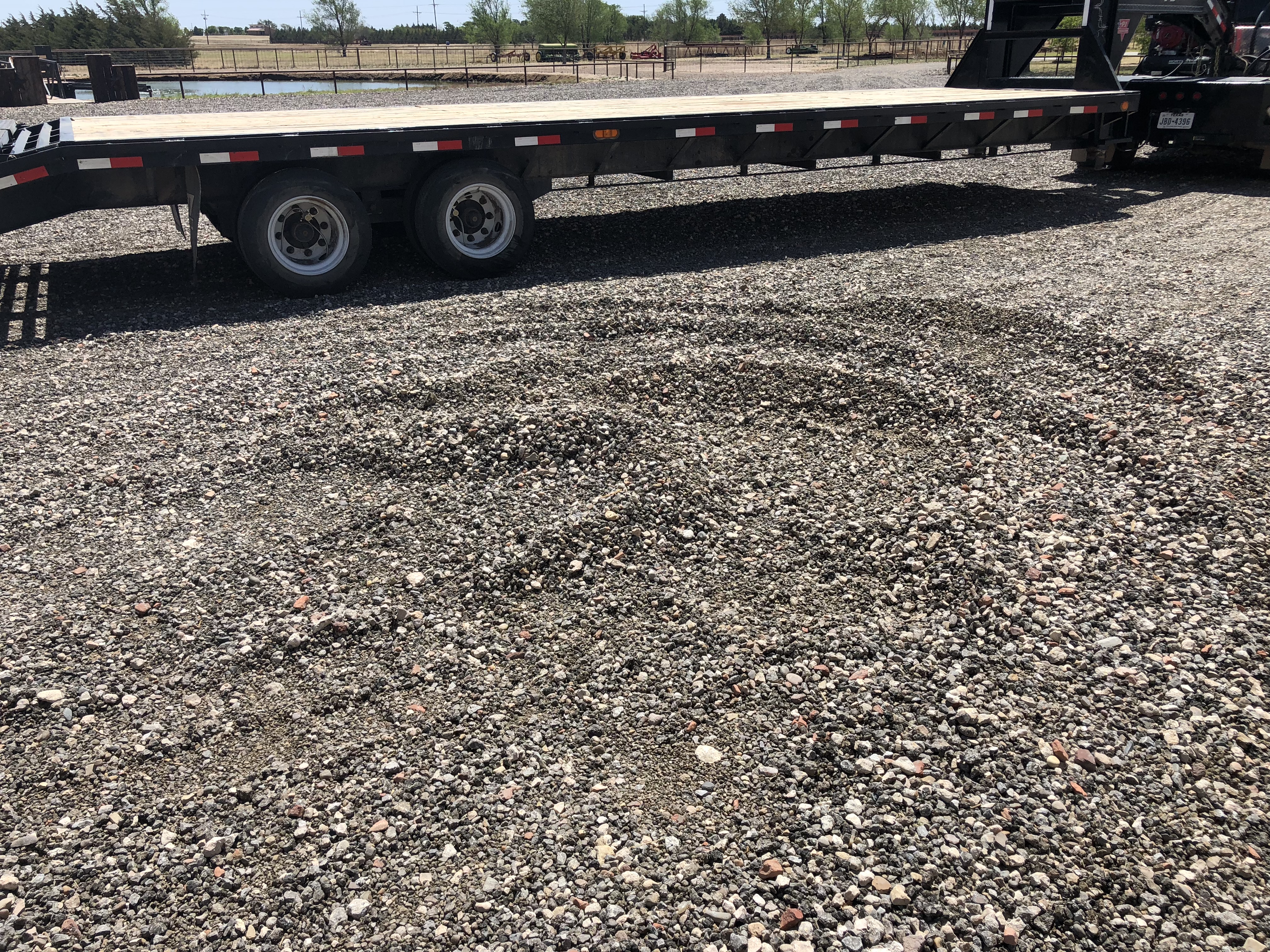

Here is a picture of what I am up against. This area was graded smooth a few days ago. These track marks are from unloading some steel from the trailer this morning. The picture doesn稚 really do it justice those humps are probably 8-10 inches high. Now imagine the tracked machine moving around this area all day doing things and it is easy to see how messed up this area gets in a hurry.

I think your REAL problem might be the gravel itself. You have no fines to hold the gravel in place. I would dump some high fine, small size gravel on top of what you have and pack it in. In a bit, you will have a good surface. Right now, you are working on rough shaped marbles which will always be an issue unless you put something in the spaces between the gravel to keep it from moving. That gravel just isn't good for the purpose you have it doing.
Yep, needs some fines hauled in and then with use and grading they will mix up and help a lot.
   / Help me design the best attachment for smoothing gravel #30
Agree...need fines in there to mix in. Get your self a large HD wood skid and drag it around. Being that your gravel is loose, you don't want to get aggressive with it and make it worse. You just need something quick and easy to level the surface.
