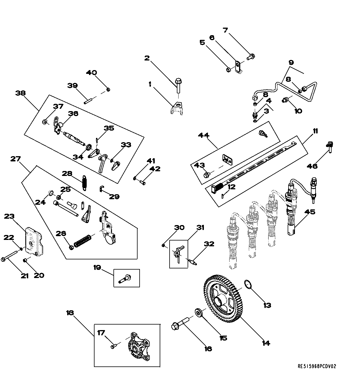

On the Compact 4320? The dealer told me it was more complicated than on the older tractors and that it involved approx 6 hours of labor. I hope they are not pulling my leg.
   / Help Me Diagnose an Engine Problem #14
It is more complicated by a long shot. Each injector is also its own injector pump. I don't know if it would take 6 hrs to tear down, but I can believe that it will take that to change it out and re-time the injector pumps to the rack etc....

   / Help Me Diagnose an Engine Problem #15
Hiya,
Hmmmm, betcha it's the injector or one of the electrical connectors to it that's your issue.
Modern injectors operate under higher pressures and have much smaller passages, any contamination of the fuel may result in clogging. The current generation are Multiple Event Digital Injectors where the ECM triggers multiple injection events during the combustion cycle starting with a "pre burn" event to "soften" the knock of a direct injection Diesel and then 4 or more injection events as the piston descends in the bore during the power stroke providing more uniform cylinder pressure and thus more torque output with much less wasted fuel and emissions. This is why Diesels sound so different nowdays, gone is the ear shattering knock at idle of the mid '90's in-line direct injected Cummins.
That being said, and I may be wrong on this as I haven't seen your tractor and I'm not 100% sure if Deere was using multiple event digital injectors on your model year, but the newer injectors "should be" pretty simple to change out as the "adjustment" is taken care of by the ECM and all the mechanic needs to do is swap the physical part and connect it up.
Tom

Thanks for all your input and assistance.
Yep your problem and the one other I have read about scare the crap out of me as I also have a 4320! Your engine dose not have an ECM, its injection is all mechanical. The pumps run off the cam and are controlled by a rack that interconnects them. On the bottom of the pump is a roller like you would find on a roller valve lifter. The other one I read about that roller was destroyed and it took out most of the engine! You may have noticed that when your tractor starts it sounds different for a few seconds, this is due to the cold start advance running the control rack and adjusting the timing. In 2009 the 4520 and 4720's went to an "E" version of the engine and have some electronic control of the system, I'm not totally sure how much was changed out tough as they still appear to have the mechanical injector pumps, maybe just the rack is now controlled by the ECM?? In any case my engine service manual dose not cover the new design so I'm only guessing about their operation:)
I do know that if I ever have to change out any of the injector/pumps out on mine I will "tune" mine to the pre 2009 4720 specs and add the correct turbo and intercooler.
Hopefully your problem will be some slight problem with the injector and not too $$$. And no you shouldn't have some thing like this happing on a low hour machine. As I recall the other tractor was also rather low hr's too.
William....

It is more complicated by a long shot. Each injector is also its own injector pump. I don't know if it would take 6 hrs to tear down, but I can believe that it will take that to change it out and re-time the injector pumps to the rack etc....William....
I just looked up the individual inj pumps. Reman ones re $275 ea.
   / Help Me Diagnose an Engine Problem #20
Yep they are not that $$$ I have even seen new parts (OEM) new for about that price point. I bet a good pump shop could re-"MAN" the stock 4320 parts to the 4720 specs for a few hundred $ for a set of 4.
I wish the original poster would update the status of his machine, I would like to know what the problem was/is and the damage $$$
William....
