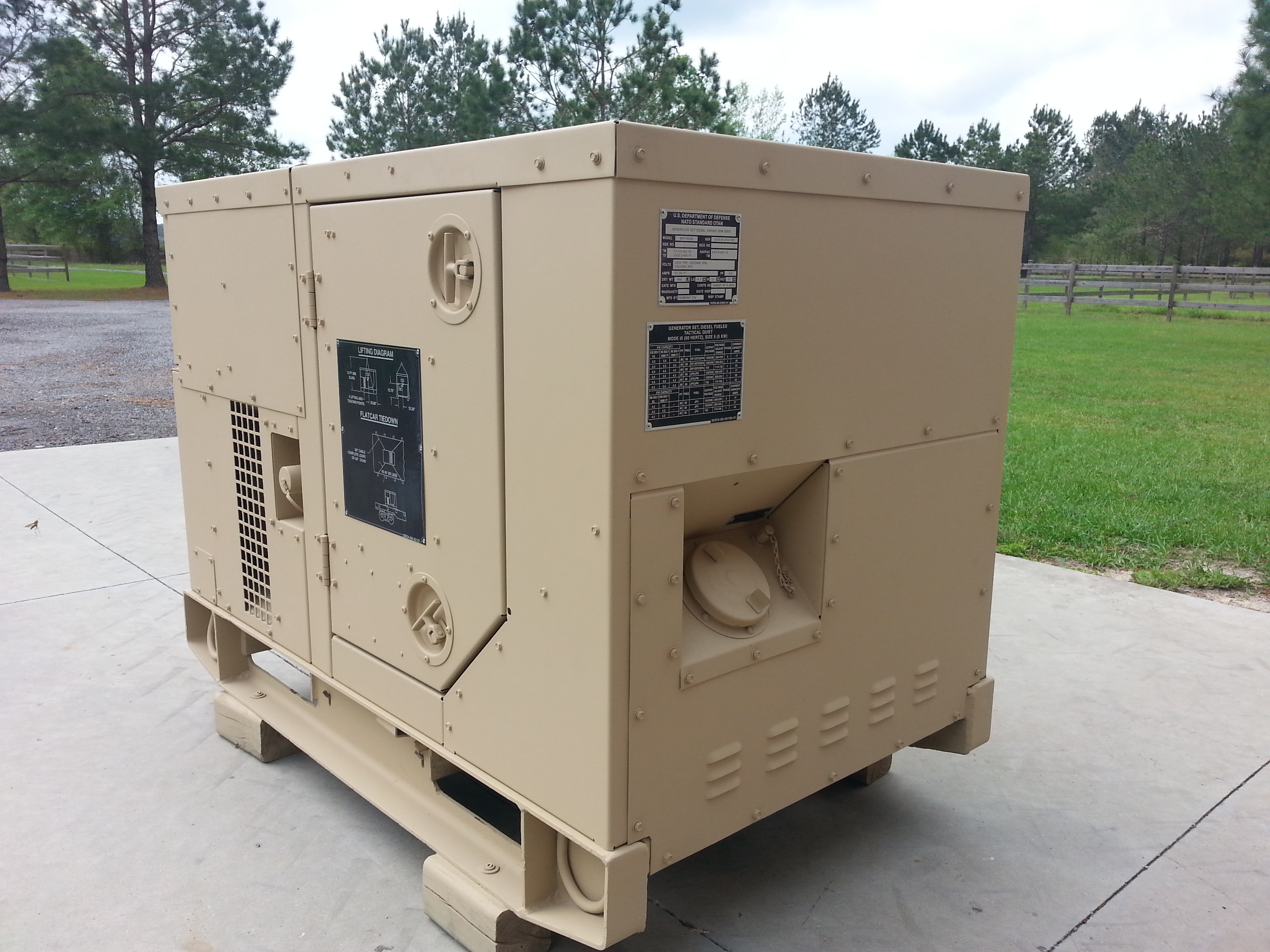

Thanks for the good info guys. What I will be wanting to lift are diesel generators that have build in skids. The 5kw version weighs approx 800lbs and the 10kw version weighs approx 1,200lbs. They also have lifting hooks so probably a safer bet to lift with a four point strap so the weight is under the bucket. My dealer is welding a couple hooks on my bucket as part of the sale.
