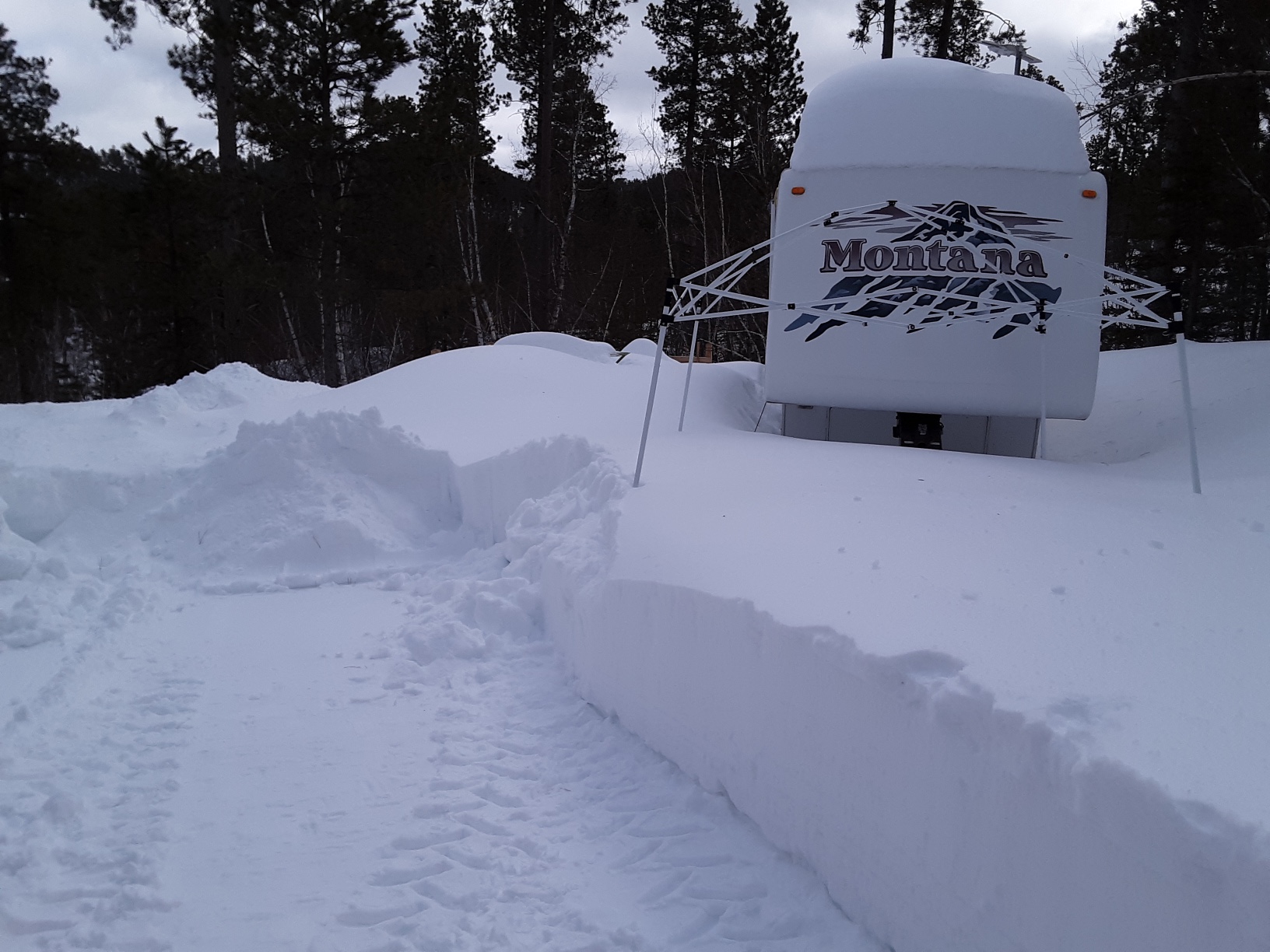

Snow removal has varied requirements. What is the average snowfall in your area? We average 140" a year. Some years its been over 200". A front or rear blade would soon run out of room to blade the snow off our 1600' road. A rear snowblower was required.
Nothing like it used to be... We average 70-100 inches per winter season...
