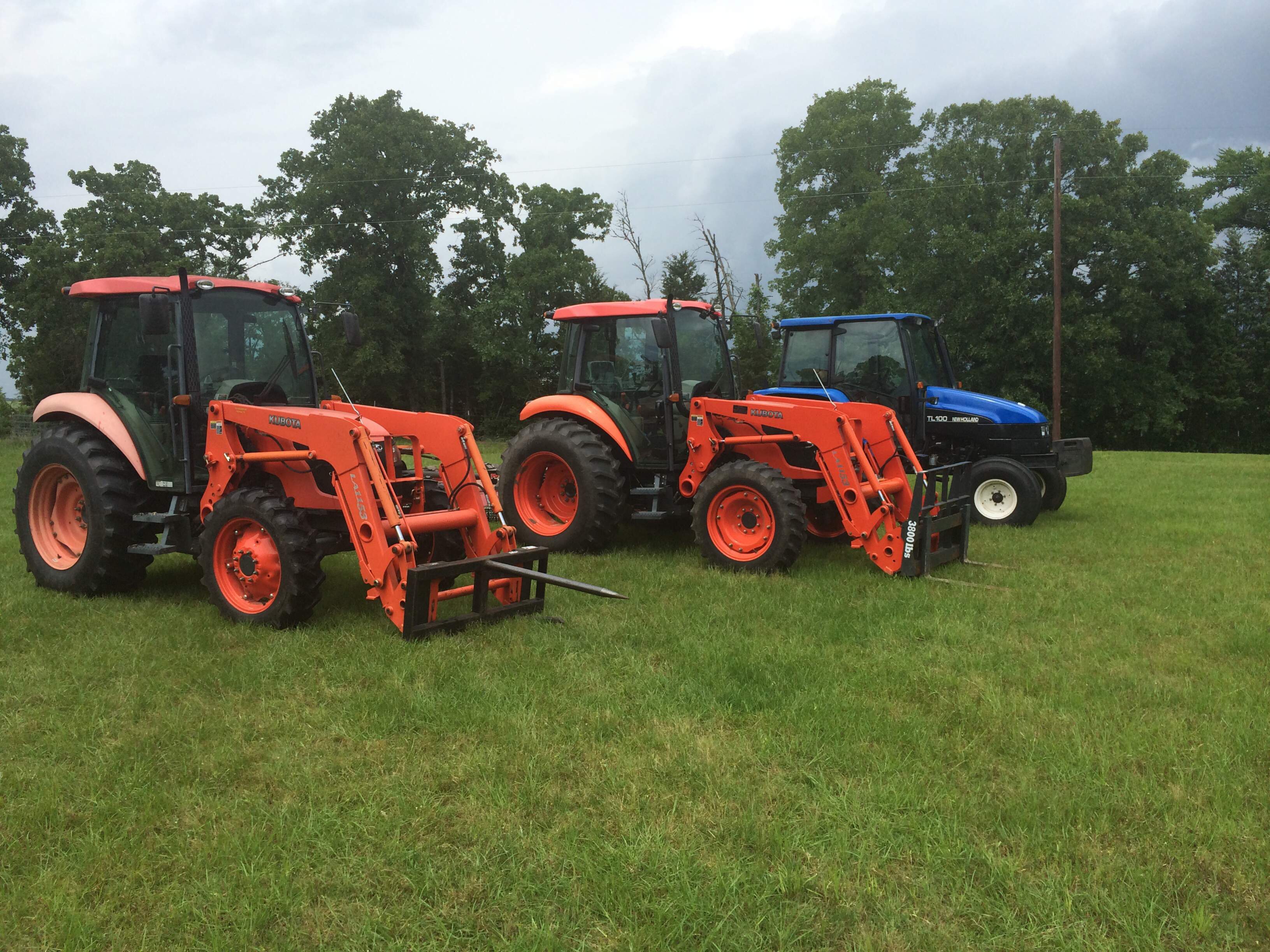

I didn't drive the TYM T430 since I was still really wanting an HST and SSQA. Most of the tractors on his lot didn't have the SSQA. But his offer of allowing a trade-up to a more expensive tractor got me thinking that I could go for a smaller (24-30hp), more basic tractor first and then trade up next year if it doesn't fit the bill.
I read through most of your post.....It is cheaper to buy enough tractor the first time, and fit your implements to that machine, so you don't have to do that all over again.
By moving up to the 40 to 50 horse frame size in a make by say kioti, LS, Massey, you double your lift capacity over most 30 to 35 horse machines.
My DK 45 will lift 2765lbs to full height properly ballasted.....more than most tractors this size, it is a decent sized tractor....but to put things in perspective, It doesn't hold a candle to a full sized 580 case hoe.
Its is an awesome tractor and I really like it, but I would not want any thing less.
My Dad has a 97 John Deere 970..Made by Yanmar, Awesome tractor for its siz 33 horse and I have spent some time on i,t it has a much smaller bucket and is much narrower and tippy than my DK45....stability between the two is night and day.
You have a lot to do, you start getting a lot of gravel and rock hauled in, and start shuttling it around with the little weeny bucket on the 35 horse units and you will think you will never get done, I sometimes feel that way on mine, and it is a fair amount bigger than the 35 horse units.
I am not retired and work every day, when a project comes up I need to get it done in a timely fasion, you need enough tractor when this matters.
Good luck, buy enough tractor!;)
   / Help me find a tractor to manage my 40 wooded acres #212
I'm leaning toward the R1's. I have sandy soil and have gotten stuck before in my 4x4 truck. When it rains, it's muddy for weeks, it seems.
Sandy soil, the R4s are going to give you better traction and flotation.
