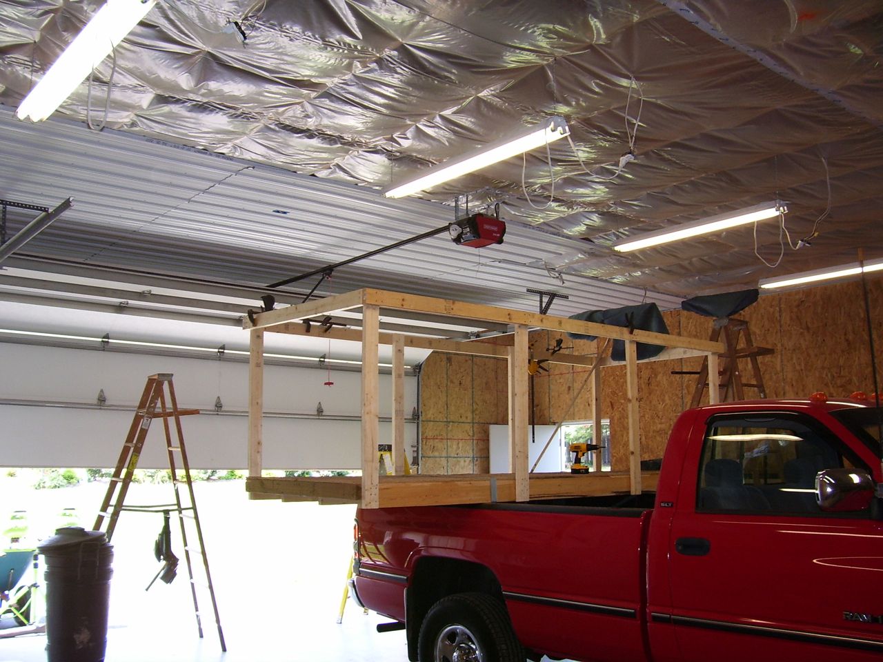

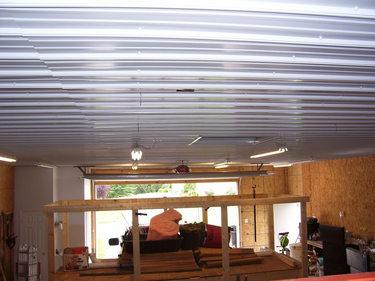

I got a high lift drywall lift and I have two rolling bakers scaffold units. There was a lot of climbing up and down but nothing that hard to do. Other people have done things like build a platform on the back of a truck.
I installed a metal ceiling myself but the interior height was only about 10 feet (can't recall the exact height). I made a temporary platform on the back of my pickup truck. You would be better off getting a drywall lift and rolling scaffold unit as mentioned above or the kind that is powered by battery due to your height. You can't go wrong with a metal ceiling, nice and bright too.
