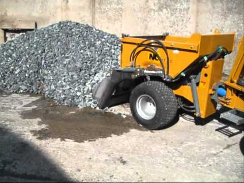

2nd idea is like a backwards loader bucket lifted by the winch. At first I thought of running it backwards, but thought the ball coupler would hijack once I touched the gravel.
kind of like this;
https://www.youtube.com/watch?v=VaRNs2M2fVs
Thoughts on why these wouldn't work, what would work better, or possible solutions?

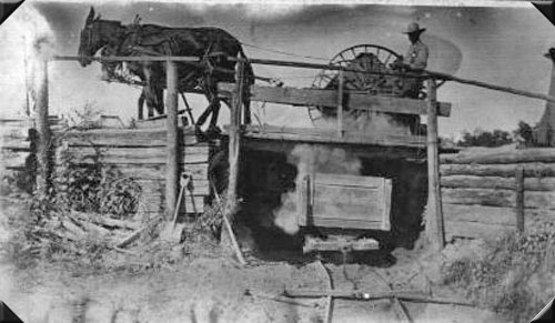

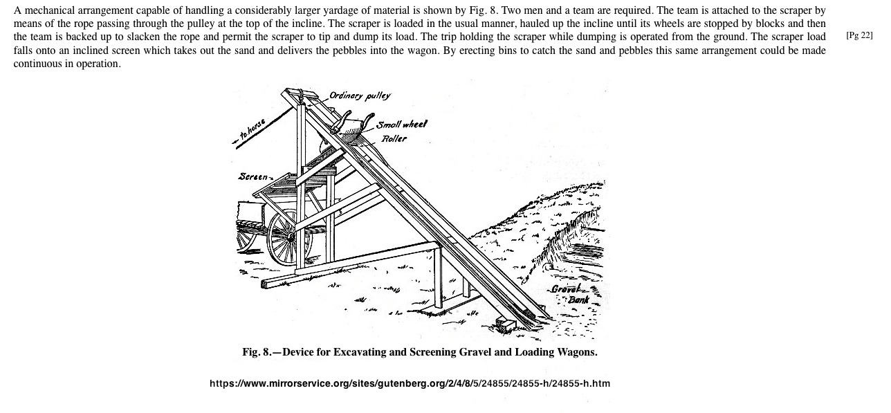

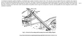

The answer may be in the past.
"Return with us now to those thrilling days of yesteryear, when from out of the past come the" many ways of loading gravel without machinery.
A low route with a bridge over it was often used. The bridge had a hole or slot where the horse-drawn scraper dumped into the truck trailer, railcar, etc. You could pull a scraper with ATV or Jeep instead of a horse. I've seen the same arrangement used in later years with a dozer used to push material onto the bridge. The bridge then often didn't have the fill on one side as the dozer didn't need to cross.
Or you could build an elevating mechanism that pulled a scraper up and over the trailer.
Bruce

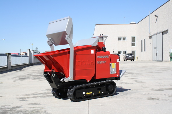

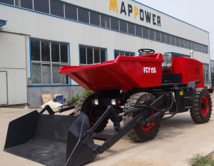

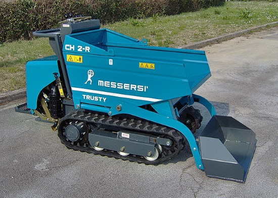

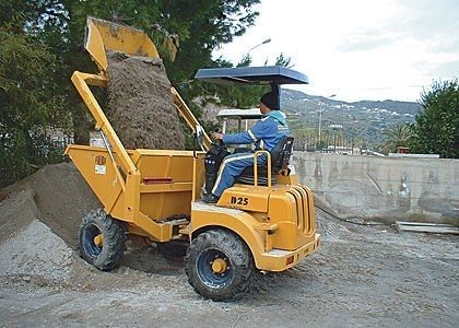

   / Help me make my trailer self loading #8
Your 2nd idea is used by self loading Dumpers, but with hydraulics:
hinowa-tracked-mini-dumper-hs1102-version-with-self-loading-dumper-bed-923354-FGR.jpg
