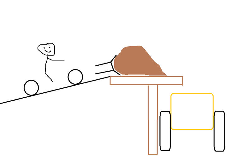

It'll be easier going down hill...
   / Help me make my trailer self loading
#24

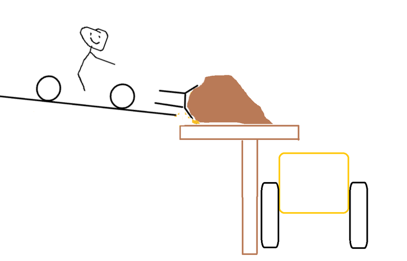

I'm sure it would be. How do you suggest I do that!?
A couple thoughts on this method; my home made plow/ scoop could be quite narrow....maybe 2 or 3' wide so as to not overload the bike....and also I could put the tracks on the bike to get max traction. In that case I'd rather tow the trailer with something else (my offroad s10 maybe) or even build a dump box for the S10.
You dig a trench wide and deep enough for the trailer next to the pile and shore it up well. Build your material ramp so it hangs out a foot over the edge of the trailer so that the material always falls off the ramp into the trailer instead of onto the edge of the trailer, or you'll be scooping out the trailer trench periodically and/or the trailer tires will ride up over the spills a bit higher each time until you have to clean out the trench. You don't have to make the loading ramp as downhill as exaggerated in the drawings. Level would be fine. But uphill will cause a lot more work to be done VS level or downhill. When loading, gravity is your best friend.
