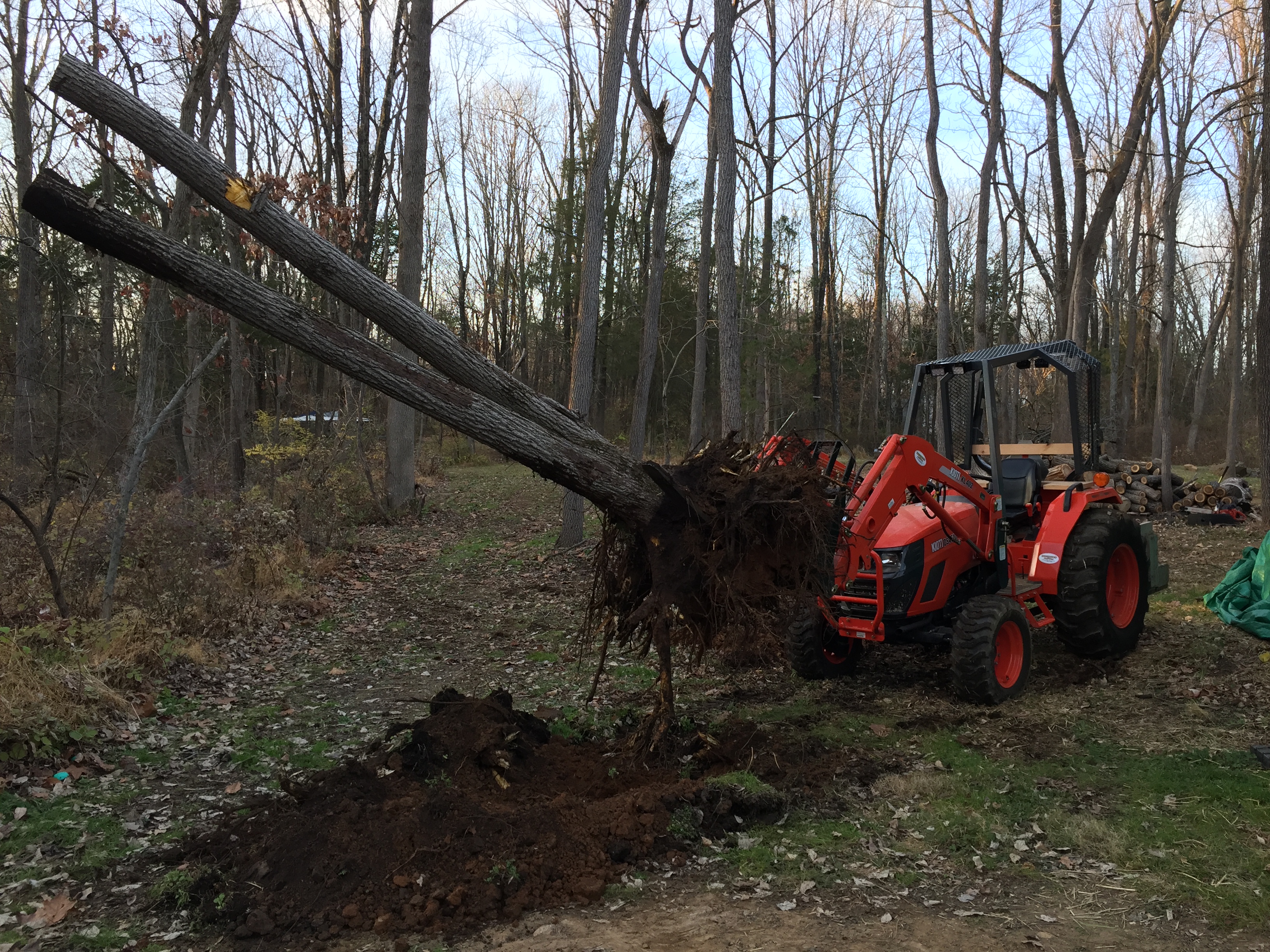

My main tines are 1/2? The in between pieces are less. Don稚 know what steel it is but probably nothing fancy. As far as impaling things, I can see that with hay bales but nothing else. I can scoop up anything. And my argument for a narrow one is it digs much better, when trying to uproot a 6 tree. Kinda like digging is easier with a spade than a snow shovel. But if you don稚 dig and only scoop, a wide one is fine. But my 48 will scoop up a bigger pile than you can see around. The other problem I would have with the unconnected tines is that when I knock down a tree, the first thing I do is push it from high. Then back up, plunge under the root ball, and curl up while inching forward. Those widely spaced tines would not allow that. The tree would wedge between them and bend them. I don稚 care what steel it is, for a big tractor will bend it.
As far as two thumbs, my narrower one doesn稚 need it. Once I grasp it, it goes no where. Now of course a wide grapple needs two.
I'm definitely going narrow and single lid. I do push over trees on occasion and my stump bucket is my favorite tool for pushing them over or digging out the ball if needed. However, if the tree is small enough to pry out of the ground in one motion then forks are my go to. It's amazing what you can pry out of the ground with a set of forks! I like to stick my forks about half way under each side of the ball and use the dump and lift function while driving forward to pry the other side of the ball out of the ground. I calculated that I'm getting something around 12,000 pounds of lift this way.
The tree in the picture came up in one motion...
