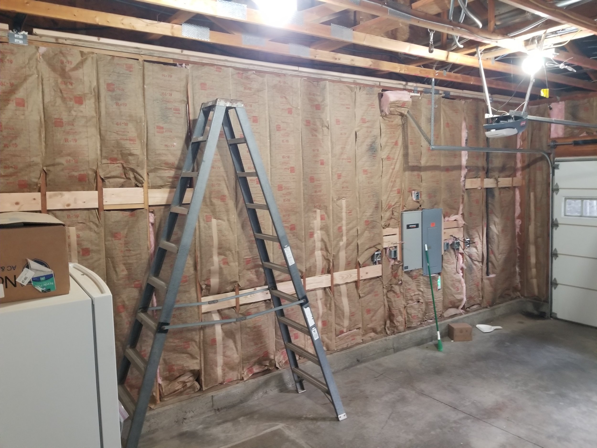

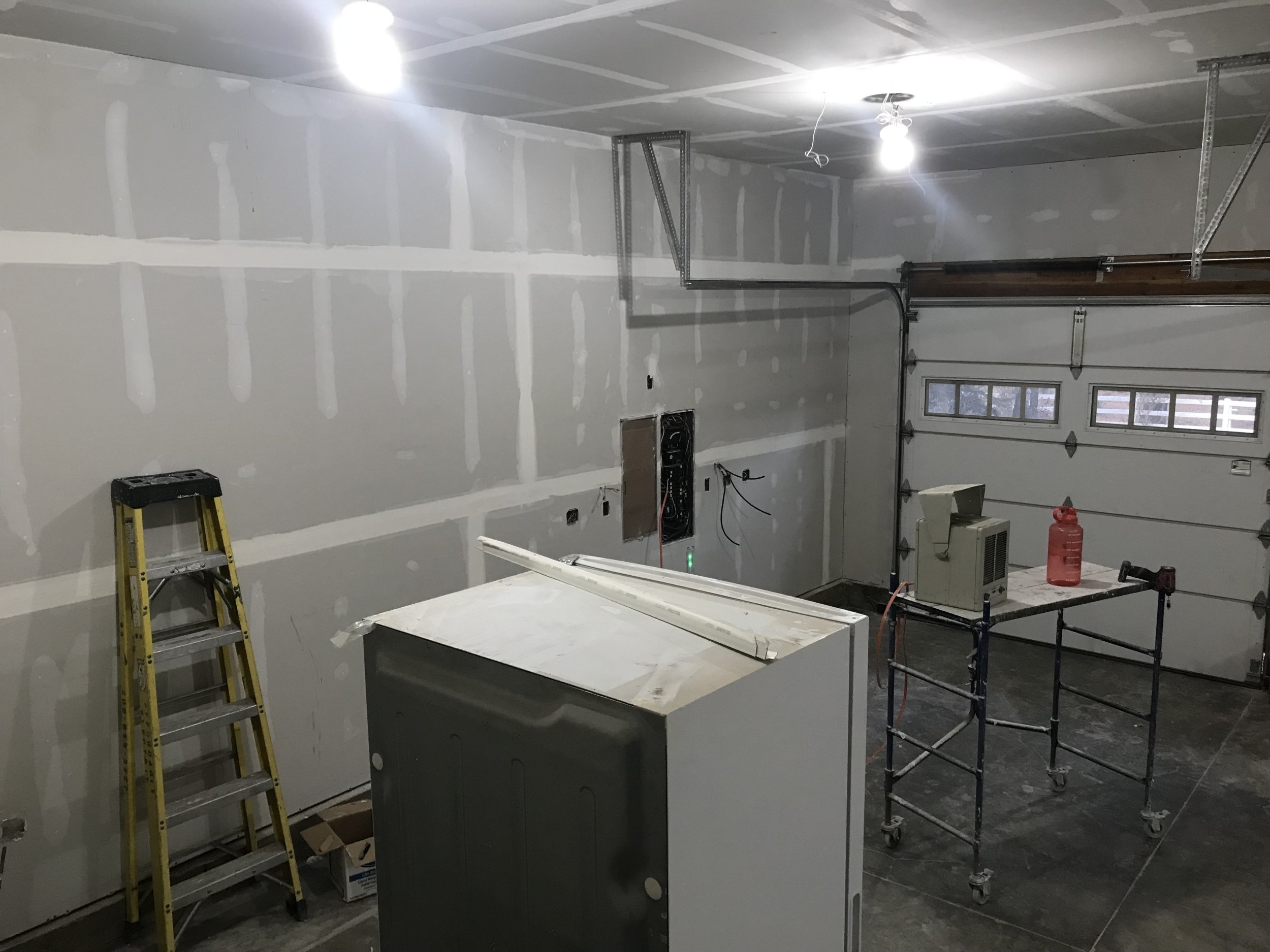

One good thing about doing your own framing is you can put extra backers/blocking in foreshadowing where you might need it so you don't have to use drywall anchors or less secure means to fasten stuff to your walls and ceiling, especially helpful with young ones in your life lol.
   / Help me save money on an addition. #50
I just did that in my garage. To hang tools and such.
