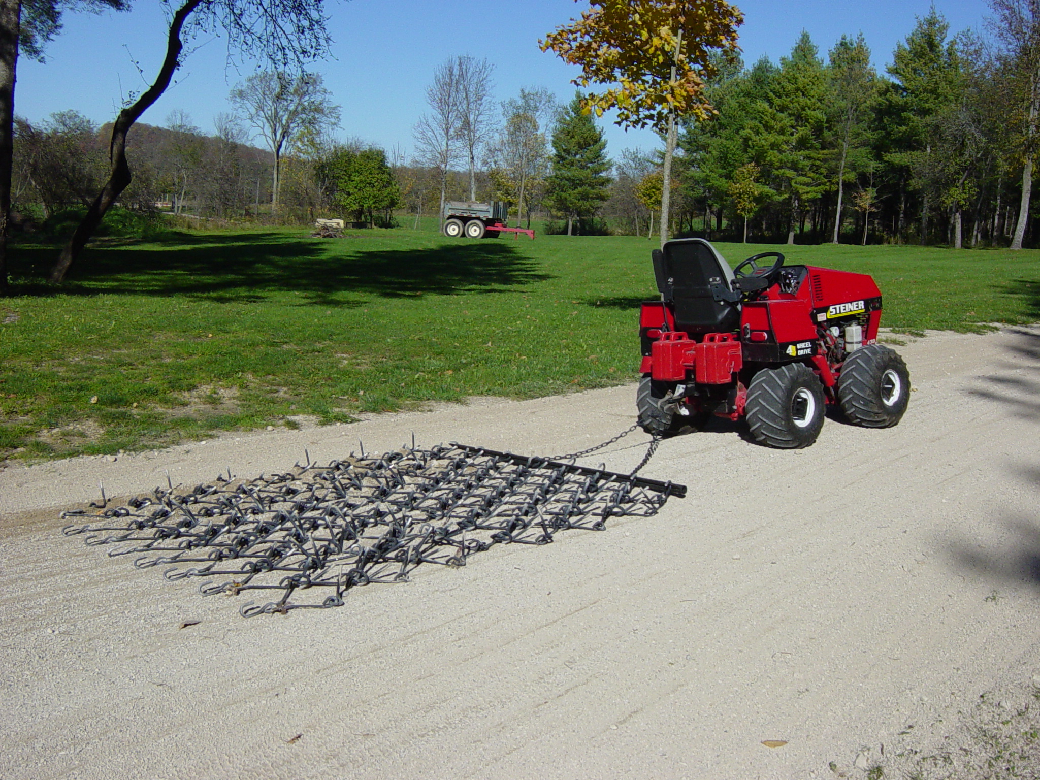

Don't know how hard your ground is, but if you've got the time and the patience, I don't see why a heavy duty chain harrow won't work. I'd use it tine side down, so it gets through the layer of grass and actually moves some surface soil around. It will take multiple applications to have any decent effect. Or, see if you can rent a pasture roller locally, wait until just after a good rain, and roll it all in one go. Won't do anything to stop the gopher mounds from coming back though.
The grass will grow back after harrowing.

As you have figured out, a flexible Chain Harrow is probably your best bet, as you have time. A dragged Chain Harrow collects a lot of trash, which is one of its functions. Shaking out accumulated trash is heavy work. A frame mounted "lift" Chain Harrow allows the tractor to shake out accumulated trash.
In ground contact work implement weight is your friend. Don't buy a chain link drag with the intention of weighting it. Chain link drags are for settling seed, not for contouring. Buy a real Chain Harrow, which is built for stress. Chain Harrows are adjustable for abrasion. Chain link drags are not. Chain Harrows usually have 3/8" to 7/16" mat and each link is a hinge. Chain link harrows are 3/16" or 1/4" mat and while flexible are not hinged. I am not an engineer but I can tell you a 3/8" mat is multiples stronger than a 3/16" mat.

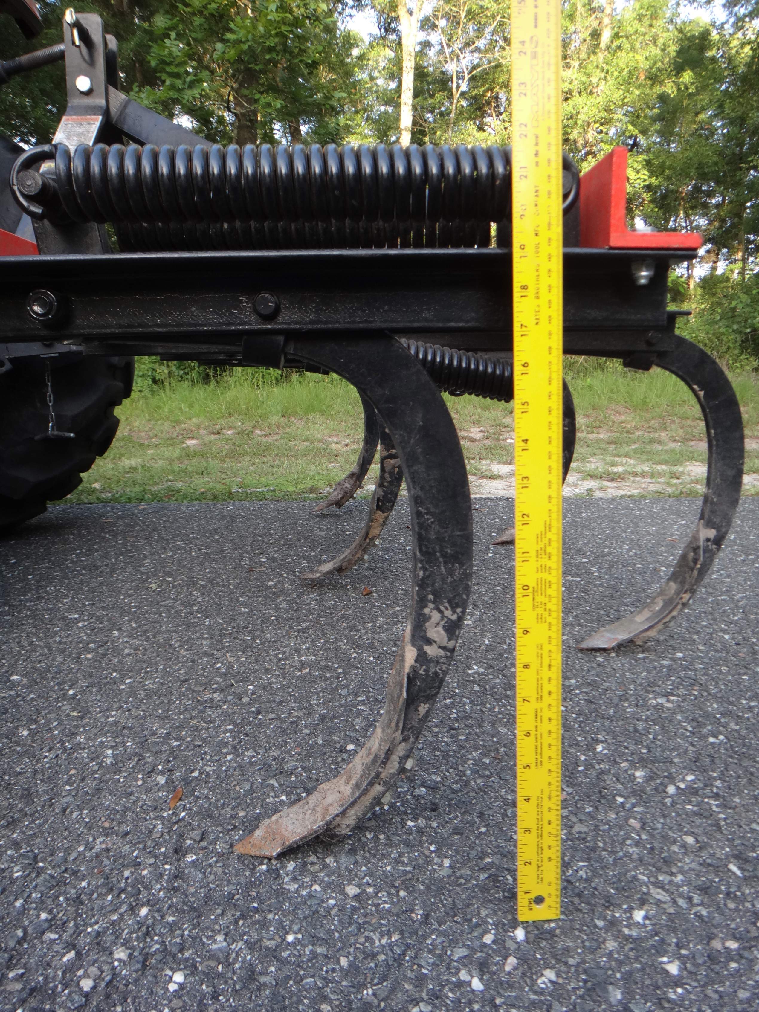

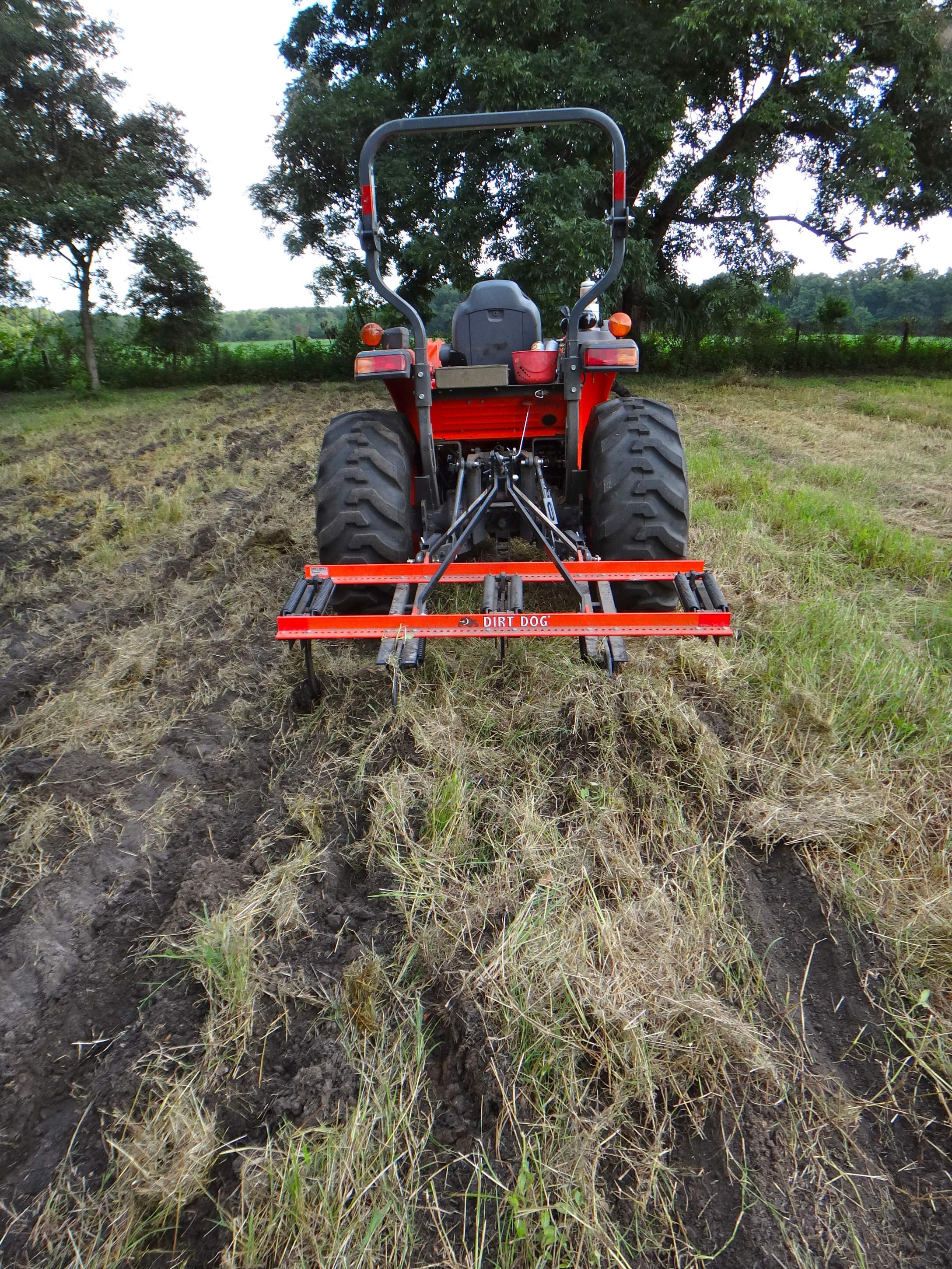

A Conservation Plow will discourage the animalitos yet preserve the grass. A light duty conservation plow is called a Field Cultivator.
In my area of Florida, aerating with a Field Cultivator every five years stimulates pasture grass growth. After horse compaction, aeration will make your four acres much more productive.
MORE: https://www.tractorbynet.com/forums/attachments/339095-dirt-dog-all-purpose-plow.html?highlight=

Redman, Oosik: By "3-point hitch leveling bar", Redman, do you mean something like this? It's the only image I could find that seemed to match. I was initially thinking about making something essentially similar to this and/or to Oosik's construction out of 4x6 landscape timbers, of which I have a surplus. I was going to use shorter spikes to just score the surface of the land rather than the giant spikes that Oosik is using, but essentially it would be the same thing. I veered off into chain harrows due to their contouring of the land, but these constructions would be very inexpensive and easy to construct - a real bonus.

I'm sold on the more aggressive chain harrow, but which one to get? There seem to be unending configurations of various pokey bits in each harrow that I see on various sites. Are there any suggestions for one that will tear up the grass a bit without removing all of it? I've seen a few videos where the drag literally rips the entire sod off the ground and leaves only dirt in place - I'm not interested in that if I can help it.
