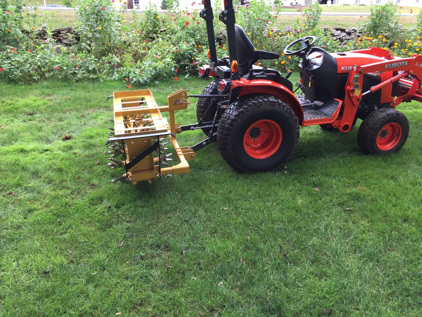

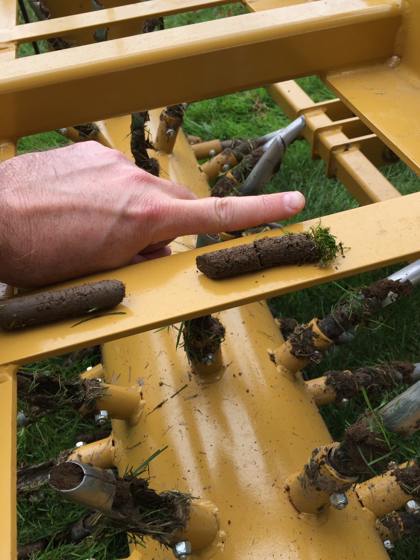

Here is a right brained thought ...
I agree. Core aerating is your most effective route. It won't be a one-and-done, but it will relieve compaction and move a very small amount of soil without damaging what you have.
