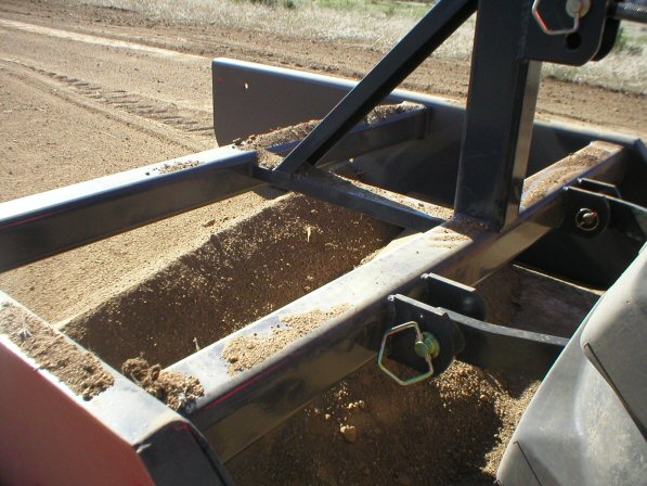

I can not give any advise your lawn mowing solutions, :eek: but I can on your driveway maintenance.;) Since your road is already in good shape, I highly recommend a road grader type of blade. You can get these twin bladed graders from 5'-12' wide. Depending on what size tractor you end up getting and how wide your drive is would determine the width of the grader blade that you would get. I would also consider only medium to heavy duty blades, they have the weight to get the job done right. I have 5' & 7' widths of these types of blades and a good 5 footer should work fine for your 600' drive. These blades will fill potholes, remove washboard, smooth and level your drive. I use a Mahindra 3215HST to pull my 5' grader blade.
