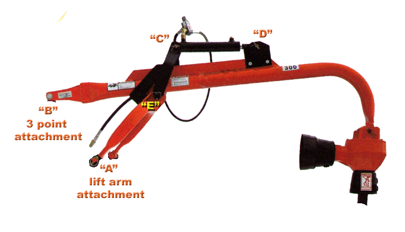

Help me understand how downforce is generated on a PHD. I know it works, but I just don't understand it.
Per the attached picture, A is attached to the lift arms and B to the 3 point connection. A & E are a fixed distance as is B & E. These cannot change. If a separating force is applied to the cylinder points C & D, then the only possible reaction is for point A to move away from point B, since point B is definitely an immovable point on the tractor.
Point A moving could only occur if the lift arms were in a "float" condition.
How does this result in downforce on the auger bit?

Your lift arms are always in a float position. There is no down pressure on your three point. Now I don't know for sure it that's what makes it work or not. But your lift arms can be picked up at any time from any position, with the exception of them being all the way up.

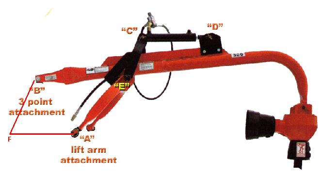

Added a point F to your drawing to form a diamond/parallelogram/whatever, where F is the point where the lift arms attach to the tractor.
Now, when you extend the cylinder, you are increasing the angle BEA, so you will also be increasing the angle BFA. Given that points B and F are fixed, the only way to increase that angle is for point A to move downward. Since A and E are a fixed distance apart, when A moves down, E moves down, pulling your auger downward.
Clear as mud?

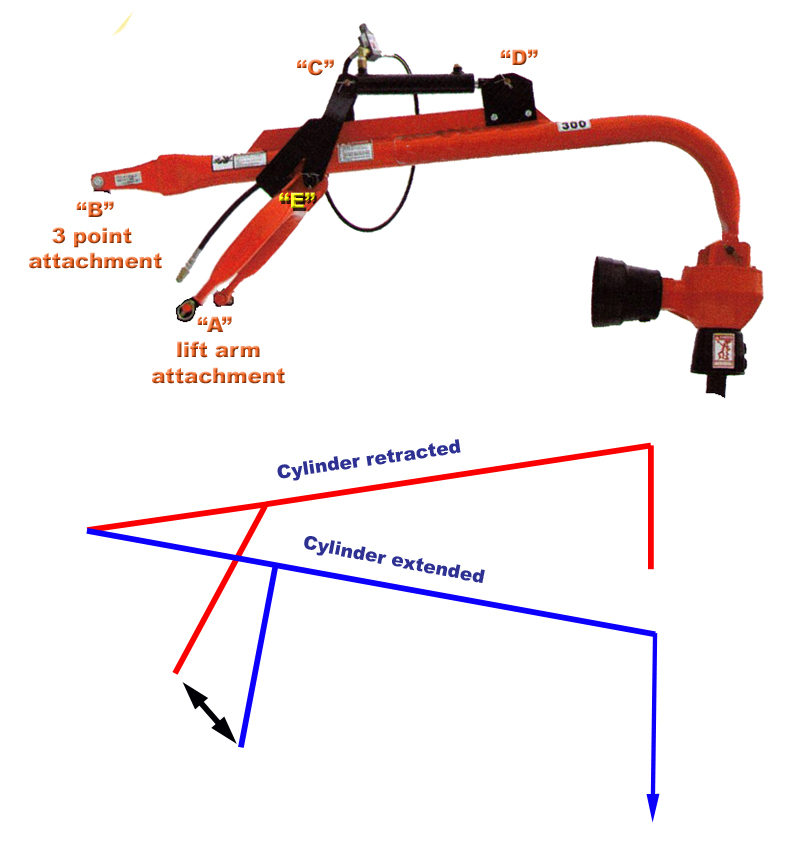

OK. I think I got it per attached. The cylinder force is actually pushing the lift arms downward.
.and incidently if it was clear as mud I wouldn't have a problem, but it's caliche!

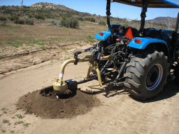

/ Help me understand "Downforce" #5

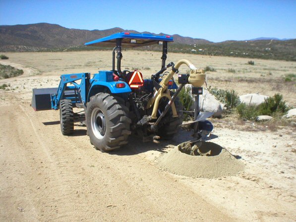

Orezok, not sure of your reason for asking other than to understand how it works. You said that you know that they work, just not how. I just wanted to let you know how well that they do work. I have a lot of DG (decomposed granite) at my place. Before I bought my down force kit, there were holes that I just could not dig without water.:( I would get down about 30" and then have to put 20 gallons of water in and come back another day to get down to 42". After a few of those holes, I bought a down force kit for my PHD. Have not had a problem since, can't say that any hole has taken longer than 2 minutes with the down force kit.:D No longer have to use water, just drill the hole when and where I want or need to.;)
Just thought that I would put the info out there as it has worked for me. :cool:
