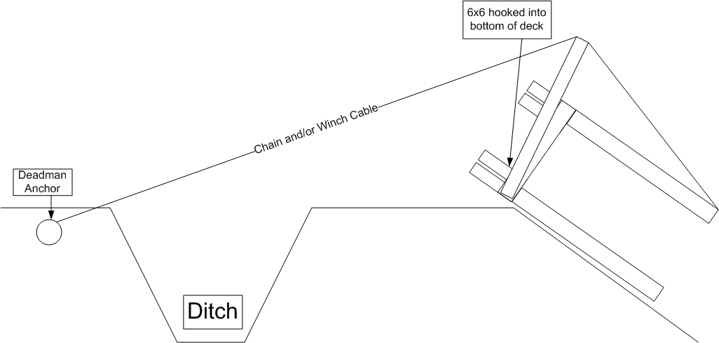

Would it be possible to dig in a deadman anchor on the other side of the ditch to winch the upper wing back over with? See: Land Rover - 4x4 Off Road Vehicle Recovery and Winching - How to Dig a Deadman Anchor for some examples.
To get better leverage, you might try using a "tower" to help put your force to better use as seen in the diagram below:
