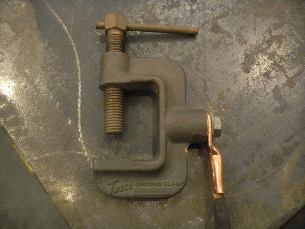

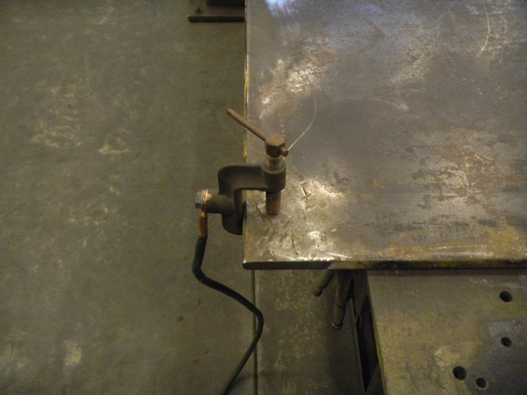

I like this type of ground clamp.
   / HELP! Miller 211MVP Transformer Welder Quit!
Yeah I am now definitely in the market to upgrade my stock clamp. It's too light with a weak spring not to get overpowered by the dang wire! :smiley_aafz:
   / HELP! Miller 211MVP Transformer Welder Quit! #9
That's about all we got on the job. They work great too!:thumbsup:
I should say, we always got the 400-amp ones.
