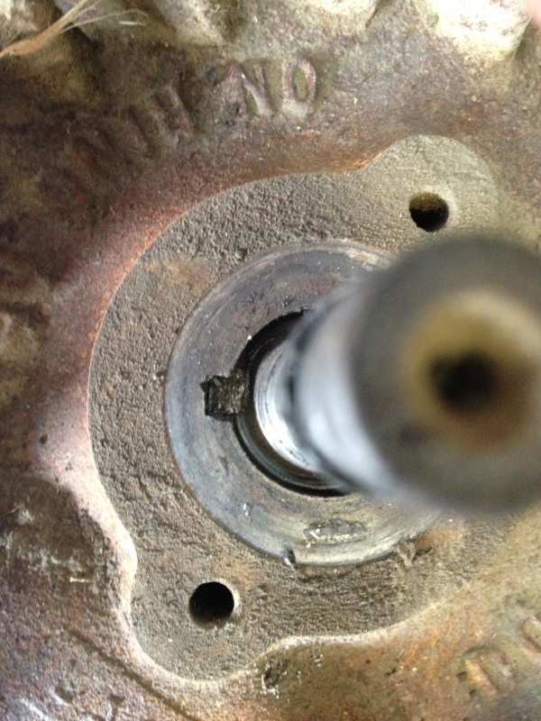

I need some small engine expert help. We've been using a 30 year old Snapper RER from my wife's childhood to keep a "lawn" mowed at our land weekly this summer. When my father in-law let us have it this Spring I was skeptical, but it's turned out to be quite dependable. Until this past weekend ran smooth and started easily.
On Sunday, I started to mow with it, and after mowing about 2 minutes it just lost power and died. Kind of like the Millenium Falcon coming out of hyperdrive. Wouldn't restart. Yesterday I brought it home to take a closer look. First thing I tried was a new spark plug. The old one was way corroded and I got a spark to ground when I put a screwdriver in the socket wire. That didn't work. I tried changing the gap on the plug, but no effect. It has good compression using a "finger test". I tried spraying starter fluid in the chamber, no fire. I sprayed starter fluid into the intake while trying to start and on one occasion I got a fairly impressive flash of fire coming back through the carb, but otherwise nothing. I also took an identical plug off of a working engine and swapped it in, but it still wouldn't fire.
I took it by the local small engine repair place, but they have a 2 week waiting period. So I told them I would try to fix it while I waited. I'm at a loss for what to try next. I fear something catastrophic. I seem to have compression, spark, and fuel. What else can I try? By the way, this thing has all of it's safety switches removed.

I can think of a couple of possibilities; Water in the fuel and, if it is a Briggs engine, a valve spring keeper that came loose. Start by loosening or removing the nut on the bottom of the carb bowl catching the liquid (gasoline, hopefully) that comes out. If it is water, drain it off, refill the tank and go mow. If you get only gasoline coming out, retighten the nut. Then I would remove the valve spring cover and check that both springs are attached firmly to the valves and that the valves open and close when you turn the engine over. Try that and report.
   / Help! Mower won't start #3
You post is a little confusing. If you are not getting spark at the plug but it will give a spark when using a screwdriver, then i would be the end of the plug wire has come loose. Of course this is if you have a known good plug. Please clarify, because trying to point you in the right direction will depend on if you have fire or not.
If you are not getting any fire to the plug electrode or the coil wire end, i would take the flywheel cover off and remove the rust on the outside of the flywheel and ends of the coil. Use a index card between the flywheel and the coil when putting it back on to insure proper air gap. If your engine uses points, then you will need to remove the flywheel to check them. If you dont know how to do that, you would probably be better off finding someone who can do it for you. Good luck

I had thought of water in the fuel as well. I typically put Sta-bil in the fuel, but I went ahead replaced the fuel with fresh anyway. I tried the starter fluid after that and the lack of ignition made me think it wasn't the fuel. I'll try the valve spring when I get home from work if I can. Thanks!
Sorry my post is confusing. I agree the situation is confusing. I made sure the spark plug socket is making good contact. I get spark with a scredriver. I get spark with a sparkplug in the socket and if I ground out the little central post. But I don't get a spark if I just ground the threaded part of the plug. Is that normal? It does the same no matter if I use the old, new, or donor/working plug. Is it possible for a spark to be "too weak"? I called the farm&home where I bough the plug from and they suggested dipping the plug in gas. That didn't work either.
The coil appears gapped correctly, which I didn't question since I was getting spark (even though it wasn't in the place/circumstances I would expect.) As to comfort level, I'm pretty mechanically inclined. It is a Briggs, and I have rebuilt 2 small engines in shop in high school, but that was 20 years ago. I wasn't planning on having to change the points, because I was getting some spark. But if I have to remove the flywheel that would give me an excuse to buy a new tool...

I would think a 30 year old Briggs has ignition points and condenser that probably need replacing.

Just called my FIL. He says he replaced the points once but doesn't remember when. Can points be "partially bad". What I'd like to know before I go to the trouble of removing the flywheel is can bad points and condenser cause no starting and "weak spark"? Could that cause it to run for a while then die like it did? Or are bad/worn points all-or-nothing?
   / Help! Mower won't start #9
I didn't know briggs even HAD points, at least not the smaller ones - everything I've worked on had a magneto, which needs to be "gapped" (a match book cover works OK) -
you didn't mention this, but did you by any chance hit a rock or something during mowing? Reason I ask is because I've had a couple small engines "lose" the woodruff key that keeps the flywheel/magnet locked to the crank - so even tho you get spark, it's at the WRONG TIME and won't do you any good.
If you have the complete "combustion triangle", air, fuel, spark - about all that's left is timing... Steve

No points huh? Great. No I unfortunately didn't hit a rock. Mowing fine one moment then died.
