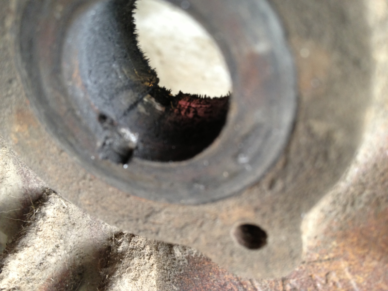

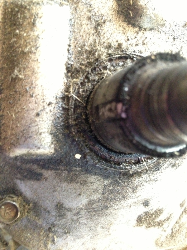

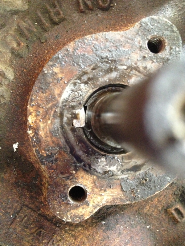

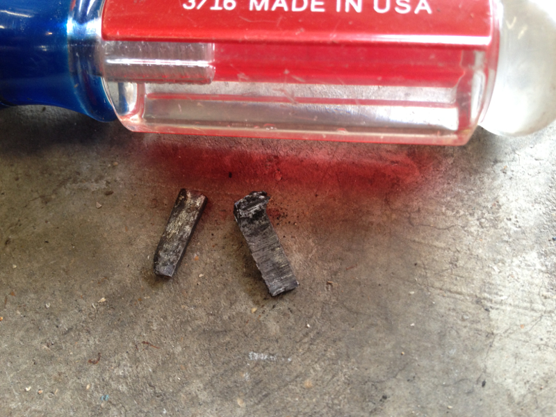

Yep. Sheared. Ill check the points next. Will be headed to parts store for pin, points and condenser. I may try reassembling with just the pin first.

It just takes the flywheel key to be off a few thousands to prevent spark when the engine has points.

Shoot! I replaced the shear pin, put it mostly back together, and tried to start it. It fired once and then nothing. So I figured I would go back in and replace the posts and condenser. As I'm doing that I've found the pin sheared again! Now I'm not sure what to think. Maybe I'm on the wrong track.

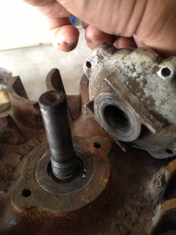

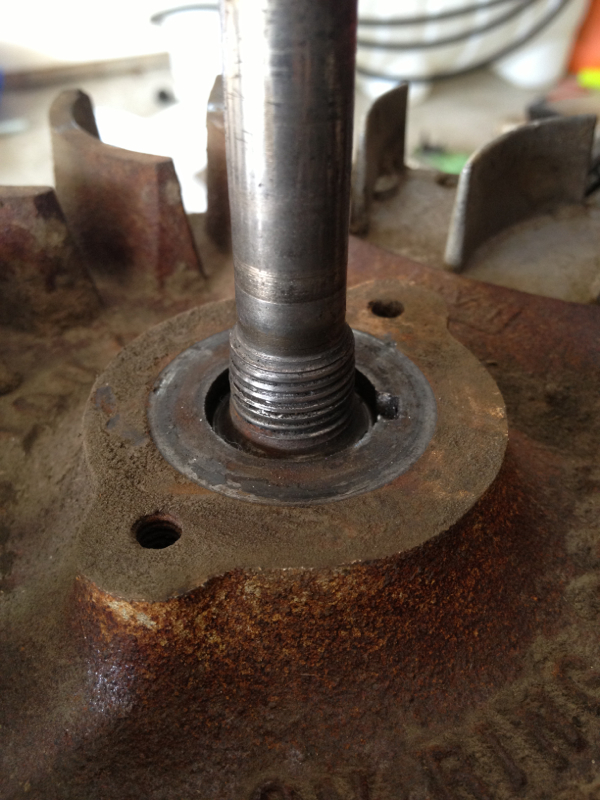

One thing I forgot to mention is that during reassembly I notice the retainer that screws down onto the flywheel is stripped. I tightened it some but not nearly as much as required. Could the lack of the hold down pressure simply contributed to the sheared key and I'm still on track with the bad timing?

Reassembled. One big fire then nothing. Sheared again. I was able to get the retainer threaded and I torqued the bejeezes out of it. Maybe I'm assembling it wrong, but u don't see how.

After more research (thank you google) I'm thinking the sheared pins is a combination of inadequate torque on the retainer, the stripped threads, and I didn't clean the shaft and flywheel were they mate before assembly. Resting now but will try again this evening. It's muggy in Missouri!

FIXED on my last flywheel key! It seems that it was the sheared key/bad timing all along. I believe what led to the failure was the stripped threads on the starter clutch that led to the flywheel becoming dislodged from lack of downward pressure.
Unfortunately I couldn't get the starter clutch tightened enough with the Belleville washer in place but I could without it. So I don't know how long my fix will last bit if it goes out again Ill start with a new key and clutch.
I ended up not doing anything with the points and condenser other than verifying the correct gap. As for new tools I ended up with a feeler gauge and flywheel puller that I didn't have before.
