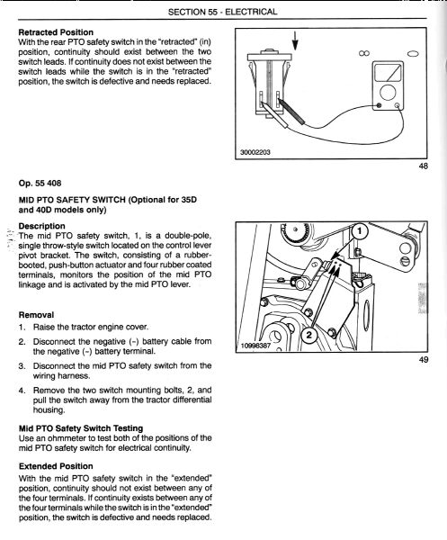

</font><font color="blue" class="small">( Unfortunately, the pages that you attached are not legible due to the resolution(?) of the scan. )</font>
How embarassing - poor quality work - being obsessive-compulsive, I am so sorry. /forums/images/graemlins/blush.gif
Hope these can help, page one attached.

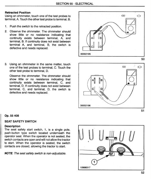

   / HELP - My TC33DA Won't Start #17
Re: HELP - My TC33DA Won\'t Start
Page 2.

Page 3. I lost a lot of resolution dropping a 1200kB scan down to <100kB file. Try Right clicking on the opened attachment and then printing it.

Chris,
Thanks for resending the attachemnts. Much easier to read.
