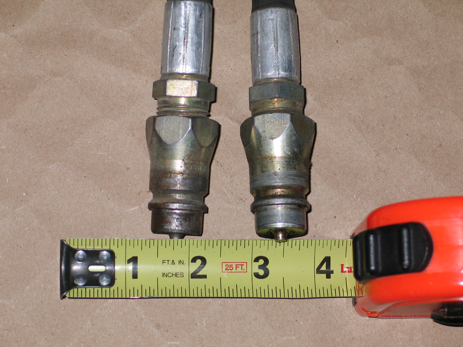

OK, lots of letters and abbreviations and new information that I never had any clue existed makes me go HUH??? So I got the bright idea to take a picture of the drill connection. Take a look....
Also, is there a website that can teach me some of the terminology?

Those are Pioneer style couplers, but in 1/2" rather than the 3/8" you need. Take one of those with you to TSC or a hydraulic shop and see if they can hook you up-literally:D

I'm not sure why JD would use such small couplers on the tractor. Around here virtually anything used by a normal farmer has 1/2" Pioneer couplers. If you're going to be borrowing much equipment you might consider changing out the couplers on your tractor to 1/2" size. Or make some short male to female adapter hoses. Changing the nipples on the drill will let you run right now but you can expect to have the same problem with the next piece of equipment you borrow.
