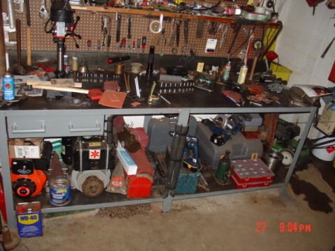

i built this bench in february. heavy drawer for nuts and bolts. plenty of room underneath for ??. cost for the steel was $200.00..

Jim, if you could post a pic, that would be great. It's the weekend and I'm trying to cypher again on building my workbenches. 1962 put up a pic of his bench, and it is nice. I think I've about decided to make one bench with a very sturdy wood top, and the other with a steel top. I figure I can mount my vice (if I can find a good one!) to it and use it for a welding bench. I can use the wood top one for quite a bit as well.
I found a guy who has some 3/8" flat stock that I can buy for the top for the steel bench. By the time I go 30" X 84" or so, that makes for a heavy piece! His stuff came from an old shipyard. I now wonder how those ships float!! /forums/images/graemlins/shocked.gif
