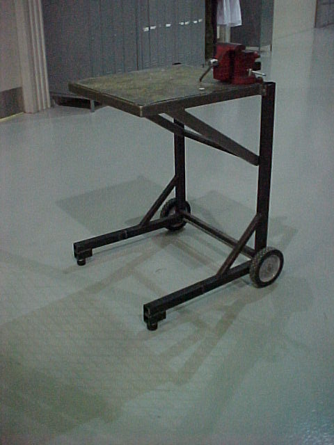

Here's a pic of my portable welding "bench". The wheels allow me to move it where I need it, the vise is small, but will hold pretty much anything I need long enough to tack it or weld it, the rubber feet on the front legs keep it from moving around much. It's fairly light duty, but then so are most of the things I need to weld on it. I've found it really handy tho.........

That is exactly what I need! Thank you! I even have an extra
vise laying on the floor that I can attach to it. Now I just need to find some sheet steel for the top.
Mike

Of course the interesting part of that picture is the background. lockers, a white outfit, very clean floor -- hmmm. a hospital?

No, it's a manufacturing facility - food plant, hence the cleanliness needed, I am the facilities manager. The top is 1/4" plate, not sheet metal. I made it out of leftover pieces I had lying around the shop, which is why the lower legs are made of two pieces butt welded, at first the legs were too short and it would tip over easily. (I guess that doesn't show up in the pic -darn sizre limits!) The little rubber feet really work well to keep it from scooting around when I'm working on it, and with the wheels, I just tip it up and roll it where ever I need to work.

I use one all steel welding table on wheels, approx 42"x48", removeable vices which interchange. The table has expanded metal top.
If solid top needed (which is seldom for me), throw on a sheet of thin steel.
If wood table is needed, throw on a piece of plywood.
If a paint table is needed, throw on a piece of cardboard.
Works for me.

sorry I didn't really mean "sheet metal" I knew it was at least 1/4".
I was thinking steel in sheets and it came out sheet metal. Thanks again for the pic. I'm very good at building things once I see something, but I'm not very good at coming up with the idea from scratch.

I picked up a piece of expanded metal to use for the "shelf" under the top. Now my problem is that I went and checked out a friend's welding table with a 1/4" top. He showed me why he would use a thicker top. With the constant need to hammer or pound on some thing, he showed me where he gets too much bounce with his top. /forums/images/graemlins/frown.gif Now, where in the heck am I going to find a 4' X 8' sheet of 1/2" metal?! /forums/images/graemlins/mad.gif I called the scrap metal places and they laughed. I'm afraid to check the price of new.
