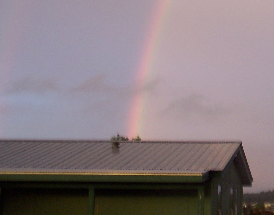

I have a metal roof from Home Depot - It is not as flat as yours but I can tell you that my roof is clear of snow much faster than any of my neighbors house with shingles. I can also tell you that you do not want to be on the roof when it has even just a frost on it, you will fall on you behind - It is slick! I have a fairly flat porch roof as you can see in the picture. It is corigated. Now that I have a metal roof I will not have any other. We get some strong winds around here and I see shingles lift and remove all the time on other houses.
I have had the roof for three winters and have not had a problem with leaking. I bought special screws with good neopreme washers and forced myself to use the clutch on my drill so I did not over tighten and squish the washer out.
