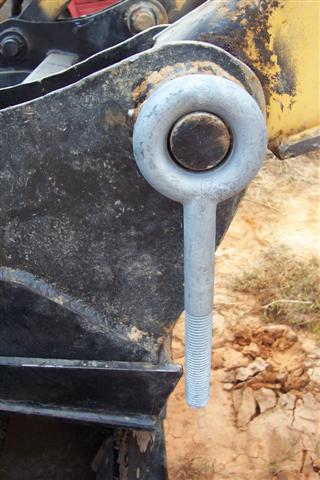

Here's my solution.
The pin extends out far enough that it should work as an anchor for an eye bolt. I bought a pair of them for $39.
Now I need to make an anchor on the attachment (grapple and then bucket) onto the QA.
My plan is to make a sort of U out of some 3/8's metal so that I can slide the threaded end of the eye bolt into it, and then tighten the nut.
This seems to be the simplist, strongest way that I can think of. Too many pieces and it loses strength and become dificult to take on and off. This should be easy to install and remove.
Thanks,
Eddie

A couple of thoughts. For a 10,000# WLL you're going to need a 1" eye bolt. BoltDepot has them and they have a 2" ID eye. A quick drawing of some brackets that could be welded up to anchor the nut end of an eye bolt or both ends of a standard bolt

Thanks for the drawing, that's pretty much what I was thinking of in my brain. The 10,000 number was an estimate that I thought up out of thin air, but probably pretty close. I figure half of that for each eye bolt, which I think I'm pretty good with the ones I bought. The problem will be in the quality of my welds. If I get it right, I'm good, if not, they will snap off. It's happened before, so maybe I'll take the extra time to get it right the first time.
Eddie
