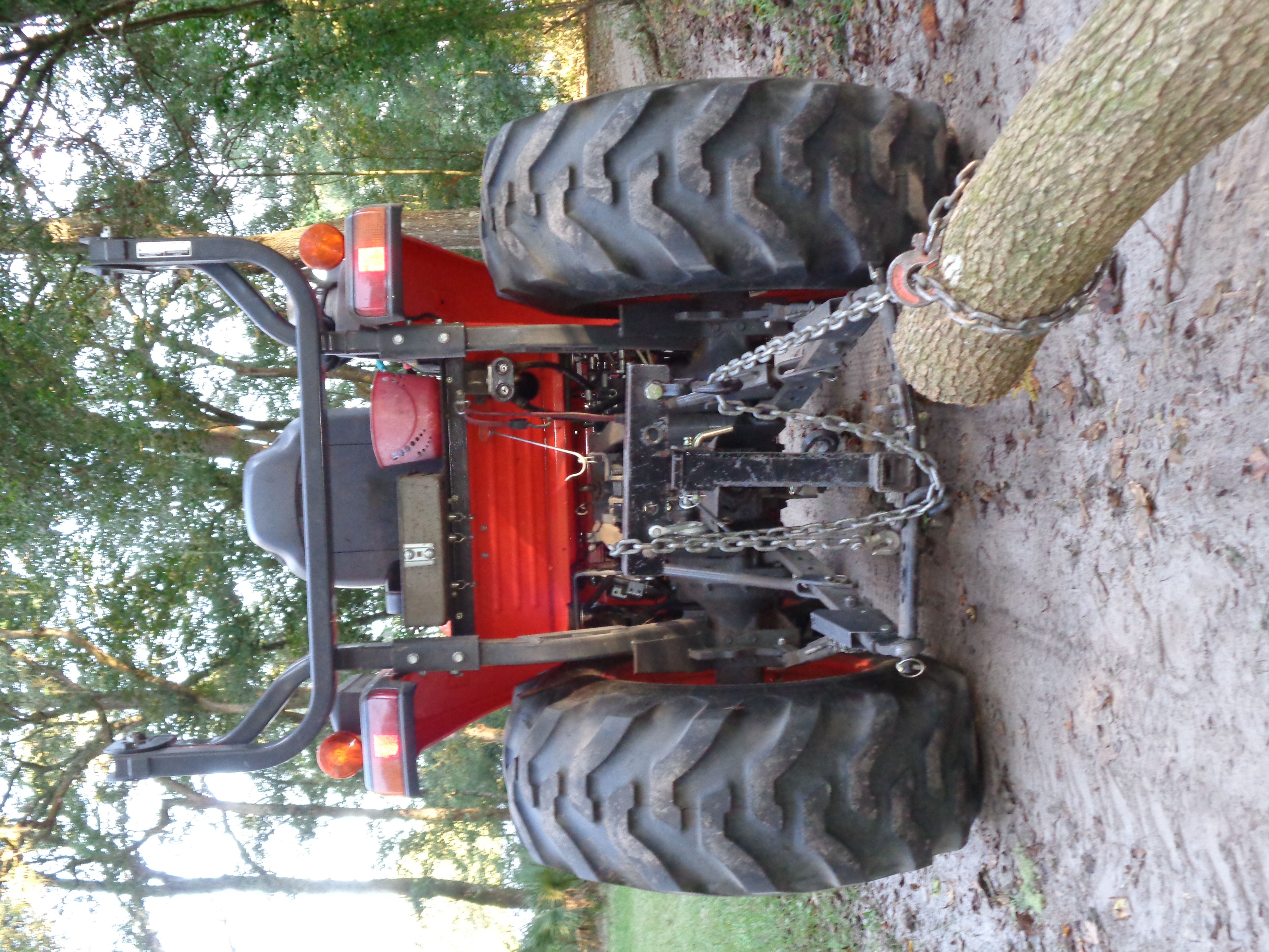

Are you towing logs with a Three Point Hitch cross-drawbar, which allows you to lift tractor end of logs a few inches to decrease friction of logs against the ground? Or are you towing logs from the rear-center drawbar so the logs are flat on the ground?

Are you towing logs with a Three Point Hitch cross-drawbar, which allows you to lift inboard end of logs a few inches to decrease friction of logs against the ground? Or are you towing logs from the rear-center drawbar so the logs are dragged flat on the ground with ground irregularities increasing friction?
Some skid logs on an old car hood from the junkyard, using the hood as a sleigh.

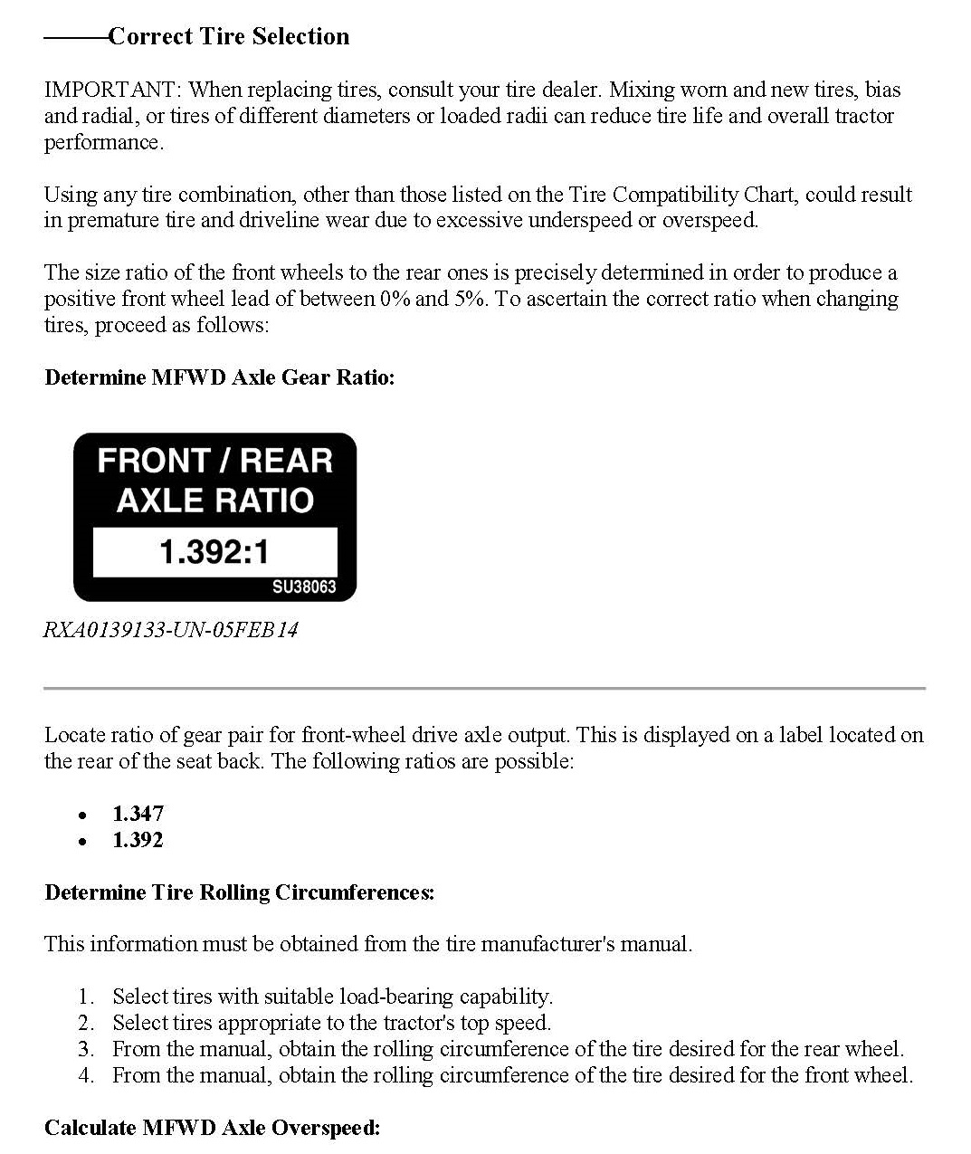

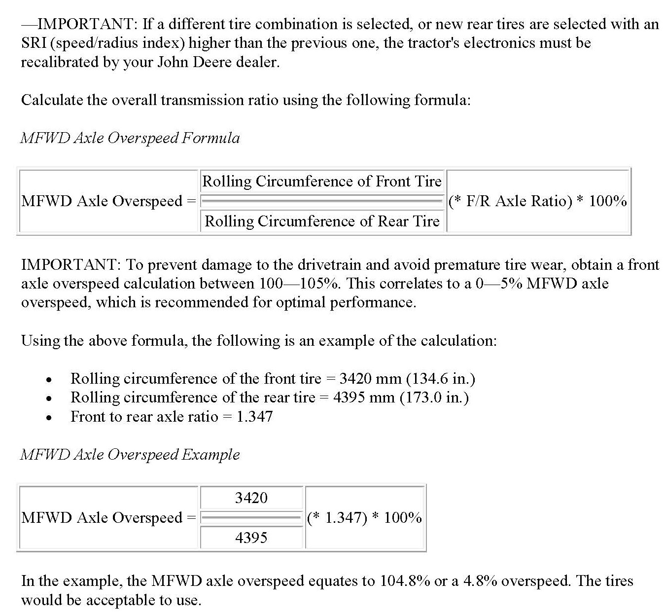

Since you have a 4 x 4, you need to not just focus on the rear of the tractor.
I know you spoke of replacing all 4 but getting the proper sizes when switching styles can be next to impossible and you need wheel changes as well.
The tractor is designed with a fixed tire circumference ratio between the front and rear axles.
Years back, manufacturers like John Deere stuck a label on the back of the seat advising of the front to rear ratio.
If you ignore this fact, you risk doing serious damage to the tractor.
I think high quality chains will be a big improvement. Most real forestry companies use chains on their skidders
Dave M7040
