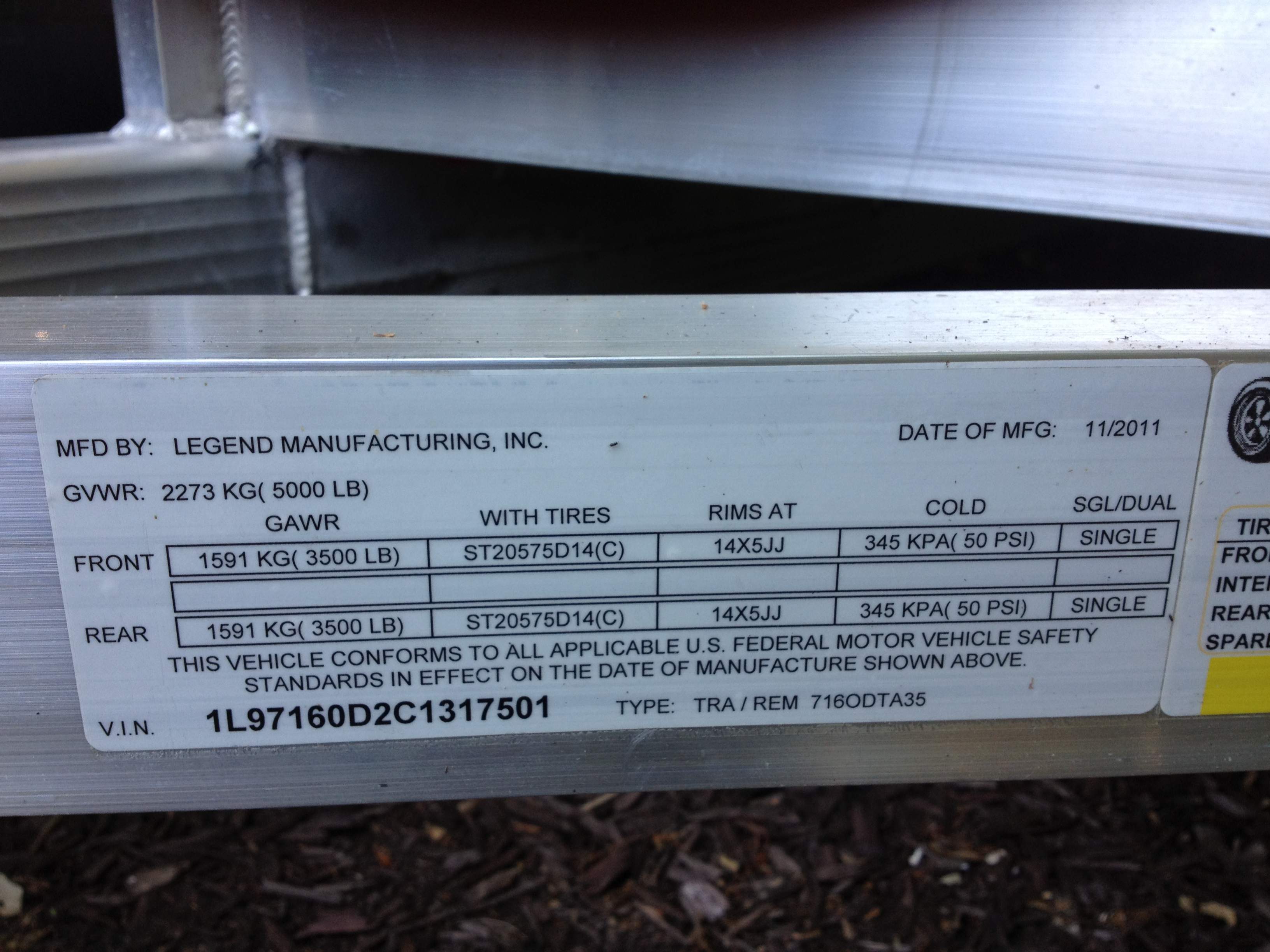

I'm in the middle of a trailer dilemma and not sure what to do. Hopefully you guys can help. First, a little background on the situation. I currently own a 7x16 aluminum trailer that is about a year old. It has dual 3000 lb axels (and electric brakes) and is rated at 7,000 gvwr. There is a sticker on the side that advises the trailer load should not exceed 3,700 lbs. The dealer also told me this.
Something doesn't add up here.
The sticker says that the GVWR is 5000# not 7000#.
Per that sticker, you have two 3500# axles under the trailer of which the frame is rated at 5000#
I would ask your dealer about the tractor weight with attachments to confirm the 6000# weight.
You will probably need more trailer to carry that tractor safely. I might have the dealer deliver it (ours does it for "free" for the inital delivery) and sell that one, then get a bigger one that is rated for 7000# GVWR.

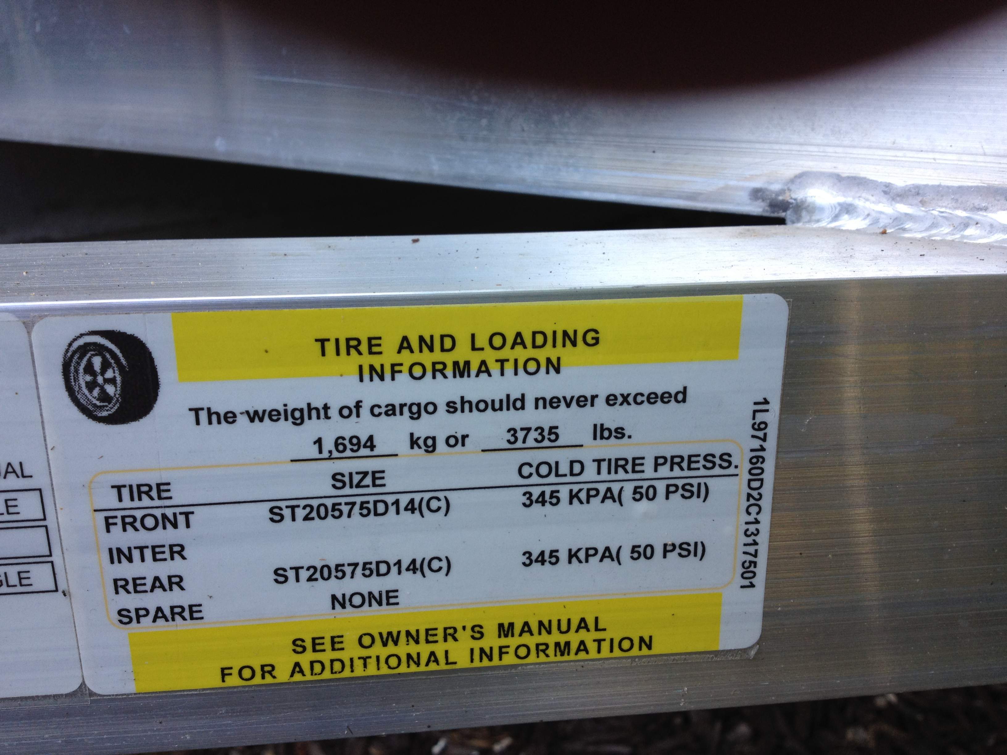

Here is a closer look at those stickers...
   / HELP! New trailer or bigger axels #13
View attachment 271133View attachment 271134
The 2nd sticker means that they put light weight tires on your trailer and can be ignored/removed if you were to upgrade to better tires.
If you were to upgrade the tires to D or E rated ones, you could carry more weight (5000# minus the empty trailer weight plus the tongue weight carried by your truck).
As an example, if you upgraded the tires to one rated for at least 1500#/tire, loaded for 500# of tongue weight and the trailer weighs 800# empty, you could then carry 4700# of cargo.

Thanks Aaron. I'm going to call around and look at some better tires.

I would still want a heavier trailer, but I think your tires are rated for about 1700 lbs. each. (It should be molded on the sidewall.)

No need to do that. I have not messed with 14" wheels in awhile but from what I remember the C (6ply) 205's are rated at around 1,800# each. This would give you 3,600# of tire on a 3,500# axle if inflated to 50psi. You cannot get better tires in a 14" wheel so that means you will have to go to a 15" wheel and a 225 tire. There is no way that is going to fit under you fenders. Long story short, they put plenty of tire on that trailer. The limiting factor is not the tires or axles, its the Frame!!!! You need a new trailer.
I have been in the trailer business as a side job for nearly 20 years. Granted, 75% of my work is boat trailers but the rules still apply. GVWR is always the limiting factor.

Apparently I was way off of the trailer weight, that trailer (per Legend) has an unladen weight of 1265#. For comparison, a "traditional" 5k 6'5"x16' utility trailer from Big Tex has an unladen weight of 1500# and a payload of 3500#. Not much gain for what was probbaly a sizable price bump.
