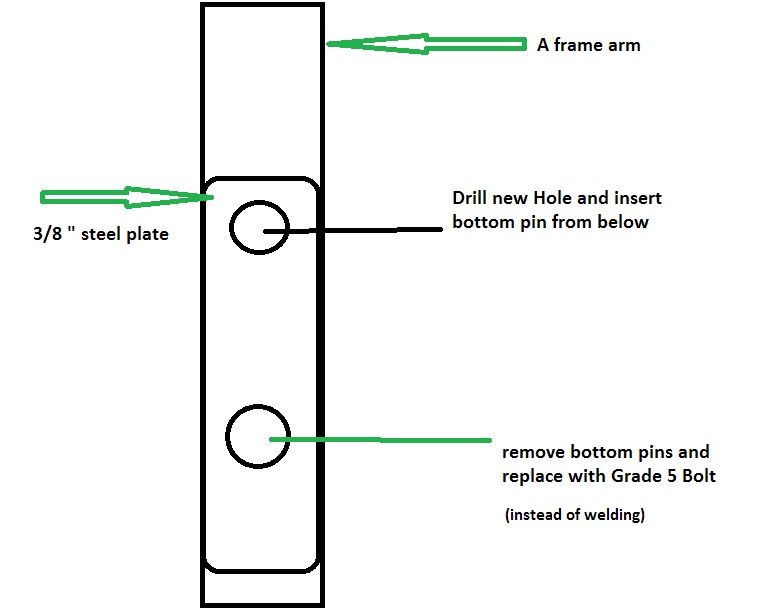

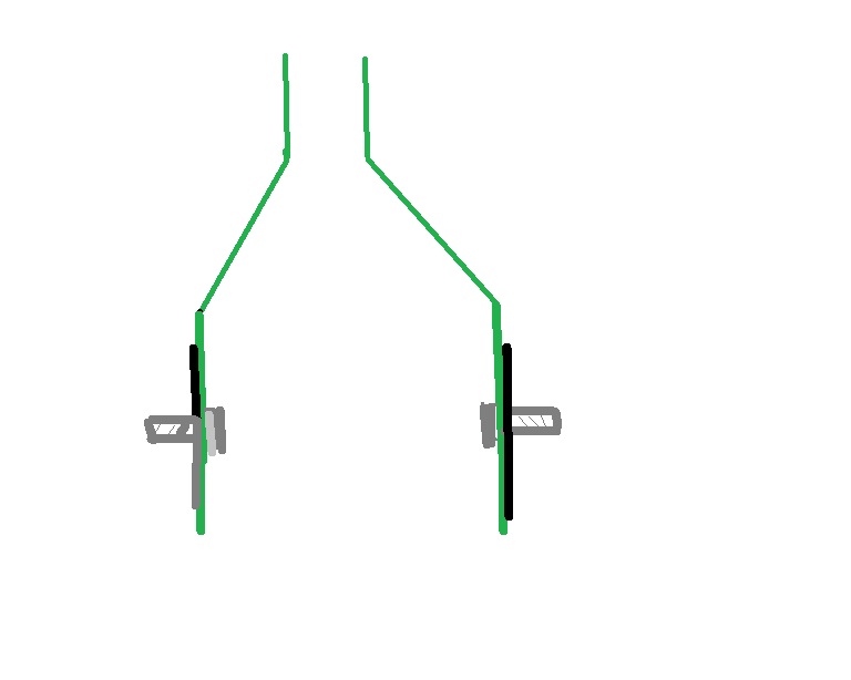

Here is a drawing of the plate. Instead of welding I'm thinking of bolting in the existing pin hole and then drilling through both pieces of material for the Pin. This will move the pins more outside by the metal thickness

   / Help on Mower and I Match!!! #15
Fix the top and then 'match' the bottom up to fit the imatch. Just know that the top and bottom will match up when doing the lower 'fix'. ;)

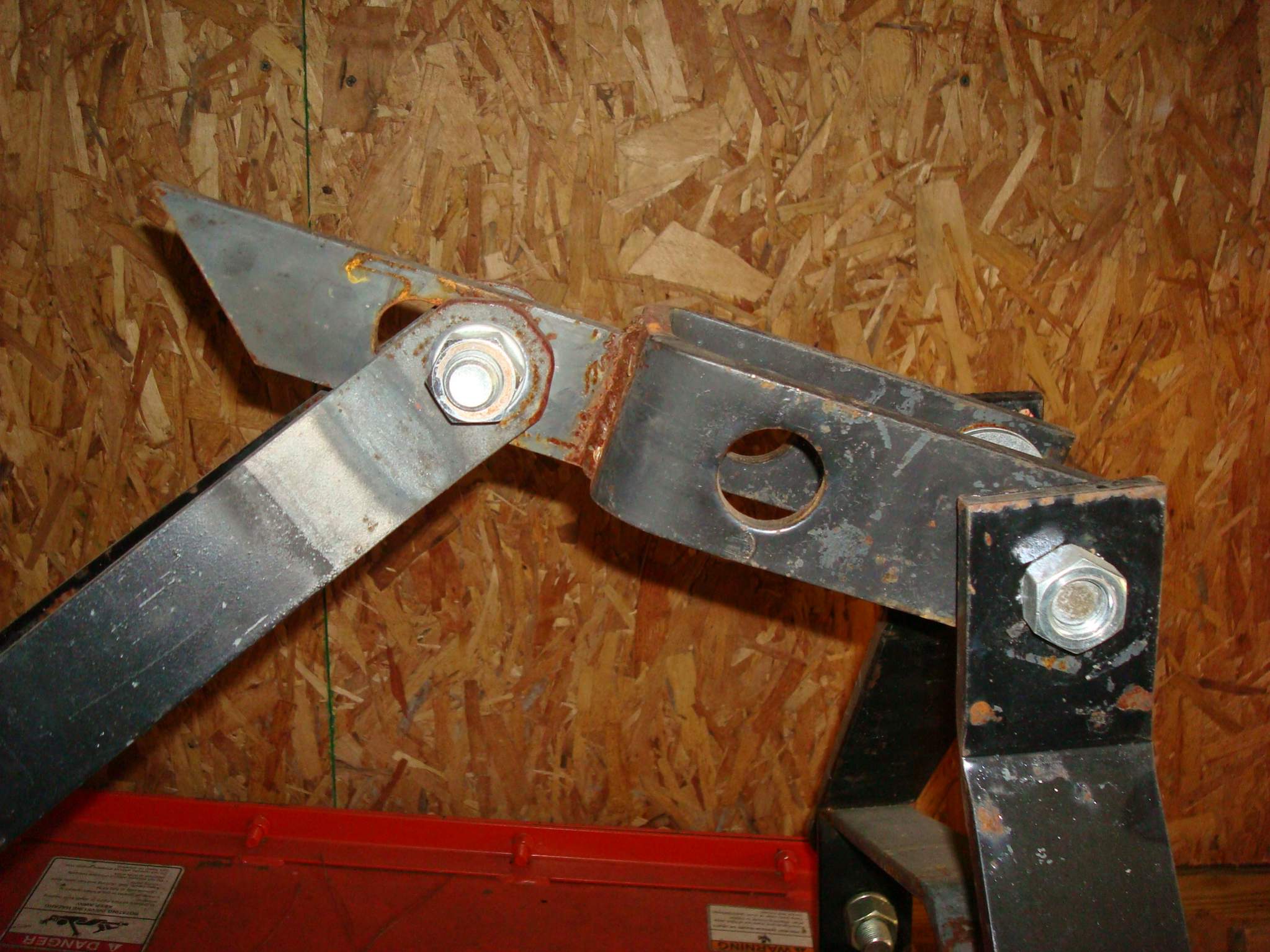

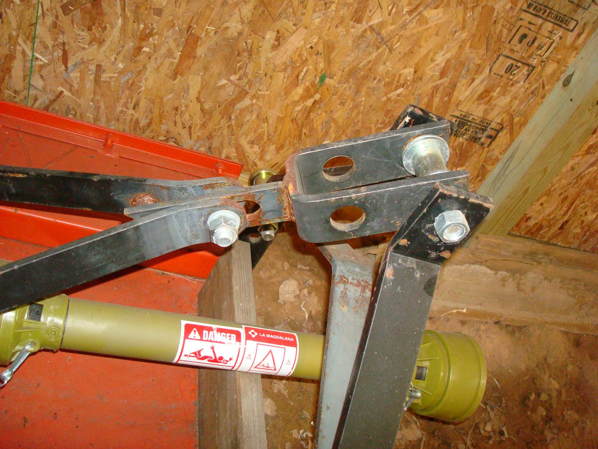

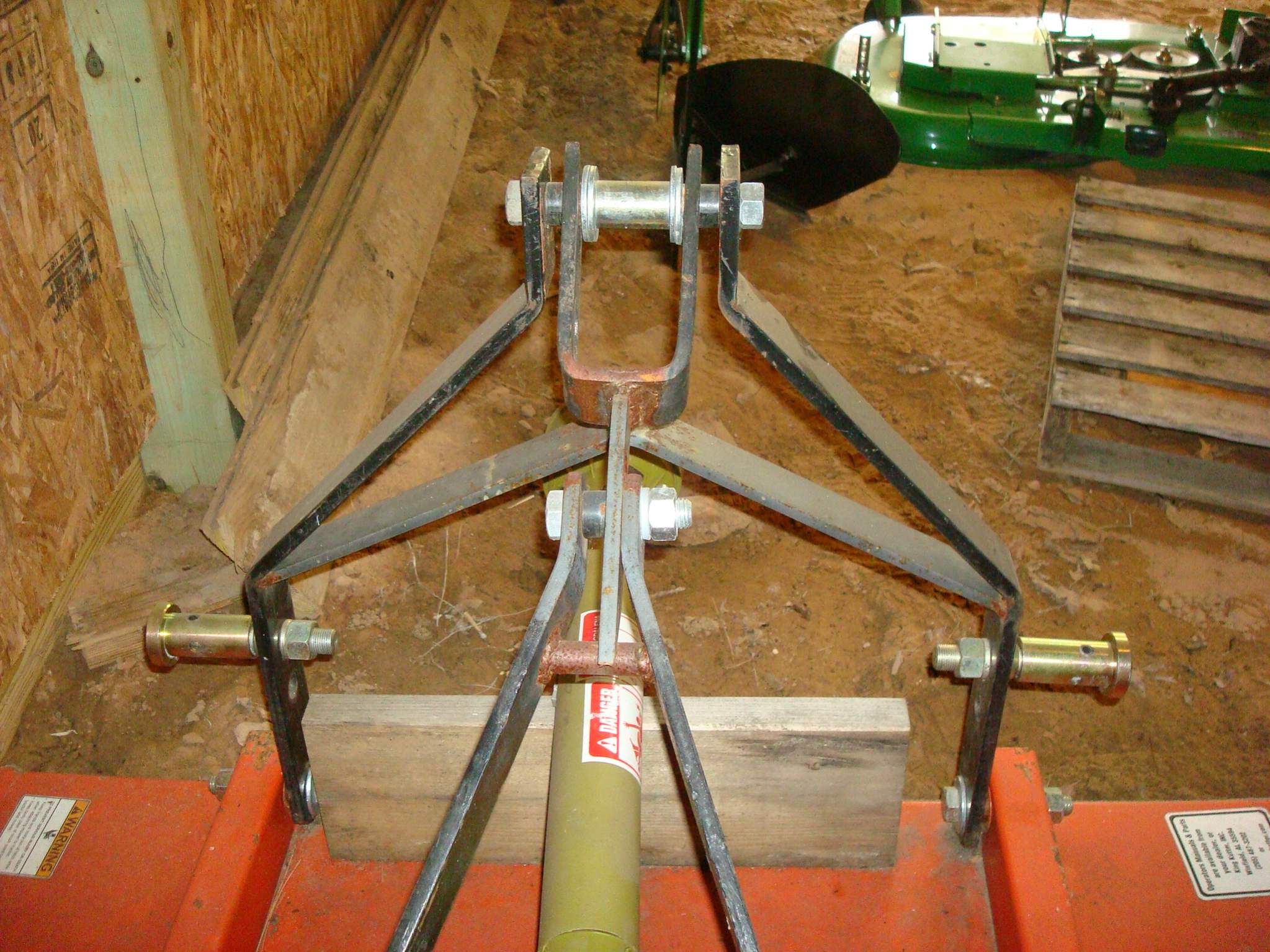

Here you go. Rather than try to explain the whole mod. Take a look at the pictures first and let me know what info you need.

   / Help on Mower and I Match!!! #18
lwalsh
Voila!! Pictures are worth a thousand words. Great post!!!

Question on Pics 1 & 4 There appears to be a small spacer on one side of the (added) sliding plate on the rear of the link or does that go fully through the slot? Did you sketch any dimensional drawings?? What if any changes would you have done different? Prop Shaft good length? Thanks for letting me ask 100 questions. I also noticed added A frame support.
JIM

   / Help on Mower and I Match!!! #20
Thats the bushing between the two arms and it goes through the slot. Regarding the a frame support, you have to tie the a frame sides together ( make it ridgid). Regarding what I would do different, never buy it in the first place. The reason I say this is after all the work of converting it I find out that the design of 2 small tail wheels basically just digs trenches every time you turn. Something else to re-design.
